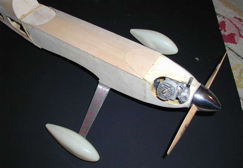

I too am building a 4*40....doing the typical "mods", I have a balsa cowl myself, - sheeted and shaped over a Thunder Tiger Pro 36.
Looks neato.
I guess I'll tryand post some pics.
Sdortch...I'm in Richmond myself.
Where do you fly? Used to go to Oilville, now at the new field.
Maybe I've seen you...don't know.
