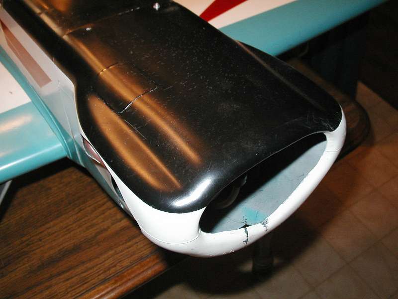

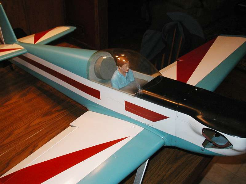

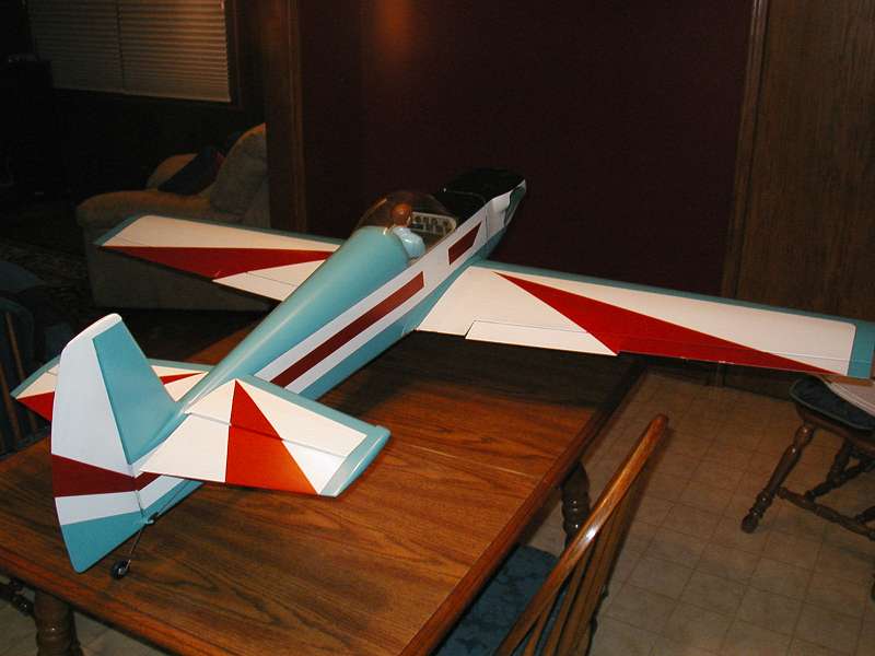

Greetings,
This weekend I picked up a nice 72" Cap 21 for really cheap! It came without any radio gear, engine, or manual/information. I will be returning it to flying status, but don't even know where to start. Please bear with all the questions, and I'd appreciate any help you can give me!
First of all, I don't know what kind of kit it came from. There is a fiberglass cowl that was probably purchased, as well as the canopy. The cowl has an "oil door" imprinted in it to look scale, as well as some very nicely formed curves.
It was obviously painted, as you can see from the pics. There is quite a bit of hangar rash, and I'd like to strip it and recover. You can see that on the stab picture, some of the wood grain looks visible. What would be the most likely covering system that he used? I really like the painted look, as it's much cleaner than a monokote finish, but it doesn't look like it has Stits or Fiberglass on it- but maybe some light tissue or something.. Any other covering processes, and how would I tell which one was used? I might just go the Monokote route for ease of covering and from previous experience in it... plus it would probably be a lot lighter.
What size servos, etc, (in terms of ounce-inch) should I use? I assume standard for throttle and flaps, but what about ailerons, elevator, and rudder?
Any advice would be much appreciated.

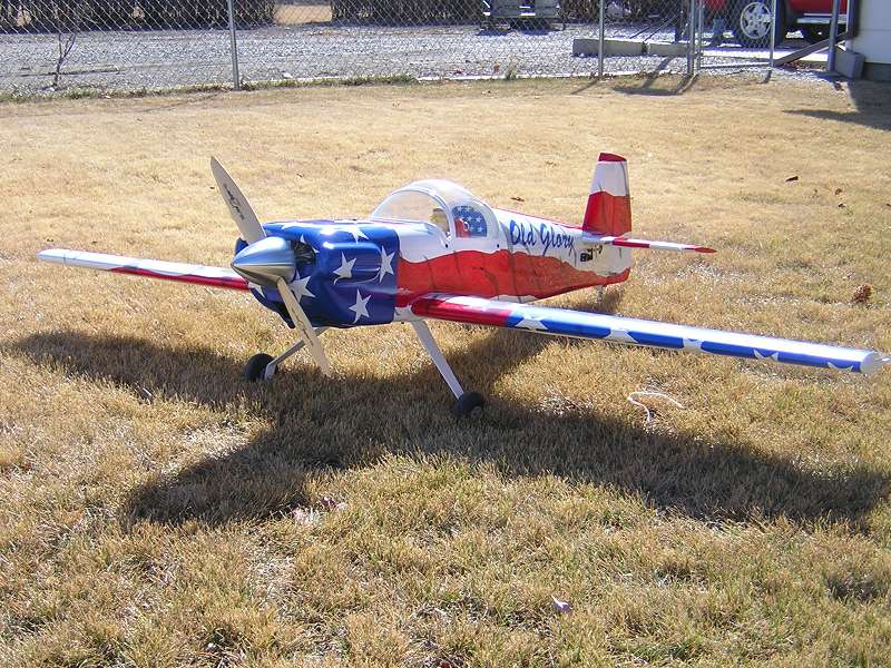

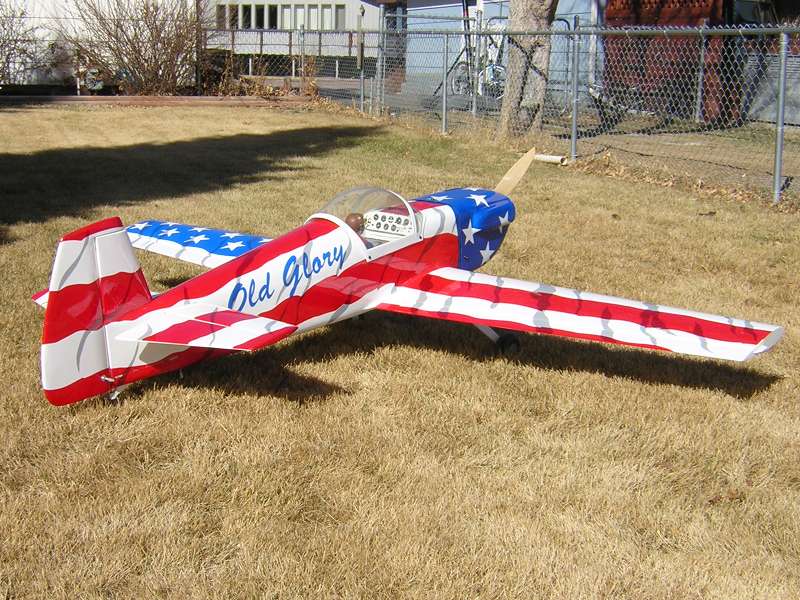

I had a 72" CAP21 a few years ago. The biggest problem on these is weight! Keep it light. Other than that, very sweet flying aircraft.
The servos need to be fairly strong. I used Futaba S128's on all surfaces. The rudder was pull-pull and the elevators were driven by a split pushrod. A 6V flight pack was used. The nose moment is fairly short so be careful of the CG. An OS 1.08 pulled it good.

Hello, there were only two 72" Cap 21's made that I can recall. One was by Great Planes and it was a kit, and one was by Modeltech and it was an "almost ready to cover". Both of those aircraft did not come with flaps and neither did the full size model so that is something that the previous owner added. From your pictures it looks like you have the Modeltech model. If you are looking for a good way to refinish the model I would wet sand the paint down to the primer and repaint it using something light, like automotive base and clear or latex house paint. I do not know of any way to strip the old finish off other than sanding and that is going to take some work. If you want to use Monokote I would still wet sand most of the paint off to remove most of that added weight. I have both the Modeltech and Great Planes version of this plane and they fly great with an OS 91 FX or OS 1.08 FSR. I used 100 ounce/inch servos on the rudder and elevator and dual standard servos on the ailerons. Watch you speed on landing as even the lightest of Cap 21's will snap at low speeds, but if you are looking for unlimited aerobatic potential and maneuvering, then this is the plane you want.
