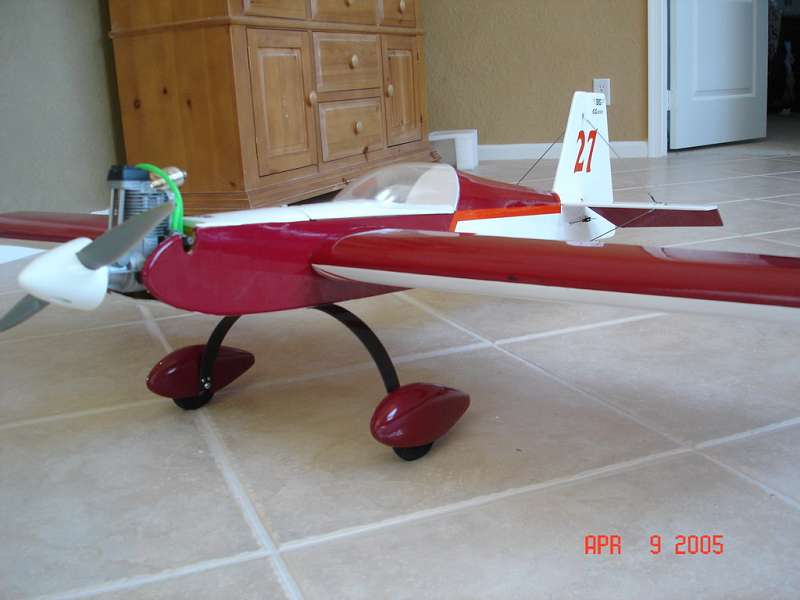

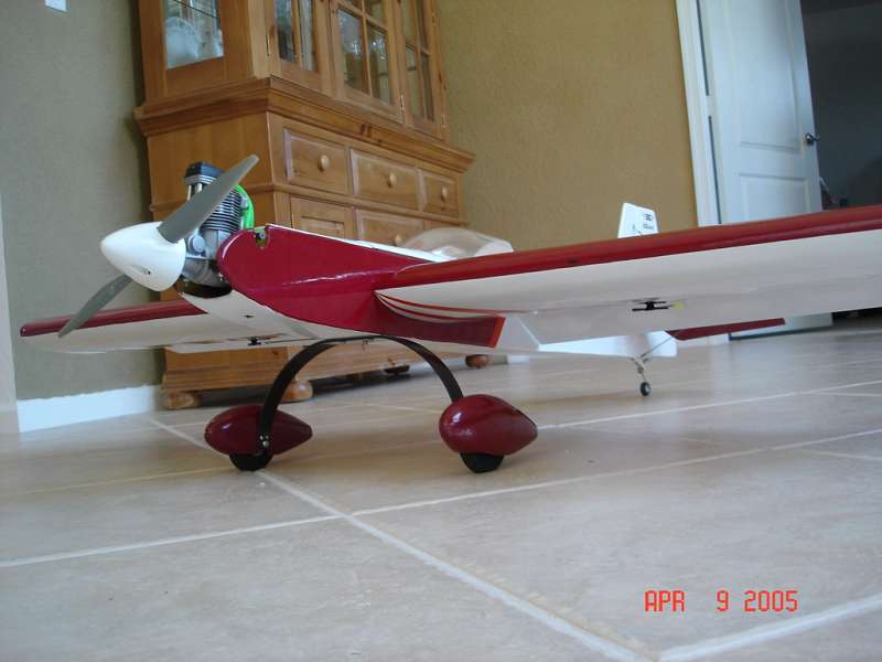

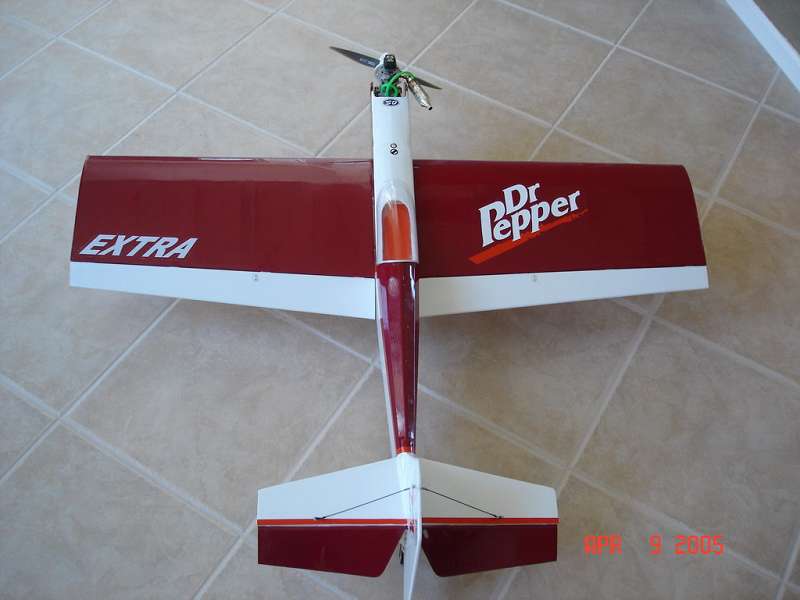

I have a larger Landing gear, the plane is really tall. With a sullivan tail whell also.
Here are some pics.

Yes, with the larger landing gear, I'd do with a 13x4 for more verticle and a 13x6 for more speed.
