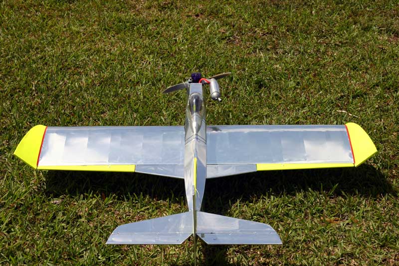

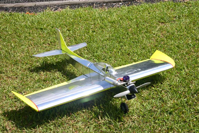

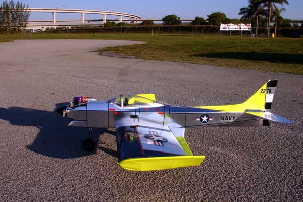

YAY! 6 pounds 7 ounces,
after 4 months of slowly building my first kit lifted off the runway....and flew!
what a great feeling
It was barely visible because the chrome finish reflected the sky and blended
the plane in perfectly. even the safety yellow markings didn't show well when
the sun was behind a cloud. couldn't make out the attitude and lost it a couple
of times, decided to bring her in.
So it's going to get some new black and white posercote trims and the decals
and hopefully this will work out.
Control throw was set up as per manual and even on high rates it was hard to
get the plane to turn. veeery slow rolls and a surprise when deploying the flap.
nose up in the sky!
I would appreciate if other contender pilots would share their setup for
control throws on low and high rates (%) and expo that worked well for them.

Thanks Colin,
i found the throws per destructions quite conservative, probably for
safety. those skinny ailerons worried me already when i built them.[
2slow, my rudder also creates some strange movements but i have to
check again next weekend 'cause i couldn't really see much of the plane.
the runway already shaved off some balsa of the rudder so it's
going to get skids. as well as on the wingtips. no it's not tailheavy.
i nosed it over twice cause i turned too early with some speed.
the wingtips hit the runway but not the 11/7 prop. good propsaver!
a little blip on the throttle and it was up on the wheels again.
strange!
that's a j'en 56 2stroke.
anyone else with some input for throws l/h rate?

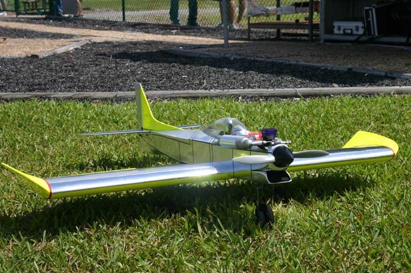

Bart, what size engine do you run in yours?
Sledge, i'm using a J'EN 56 from justengines. http://www.justengines.unseen.org/Jen_56.htm
(16.9 oz),Pulls it around nicely,
vertical is ok but not a rocket. fast enough for me until
i get bored probably. but all around a nice combo.
Moved the cg now 5/8 behind it's original loc and it's still a little nose heavy.
Pulls to the belly in knife edge and nose down inverted. i have the battery and
rec under the pilot, can't get any more aft cause there is the throttle servo.
1 1/4 flap with -21 % elevator.
one inch throw on ail, ele and rudder at high rates, low rates are 60%.
also mixed 25% up elevator to rudder, to hold knife edge better and actually use the rudder in
turns without falling out of the sky. usually fly high rates all the time except when landing.
i'm landing it allot since this is soo much fun. very predictable and stable even in crosswinds.
solved the visibility problem now by adding black & white trim and the decals. much better now.
last weekend a wing mounting block broke lose. caught it while i assembled, so no fly [&o]
used tristock all around and glued back with epoxy/ microballon mix. very strong now plus the
fuse sides don't bend in anymore.
i love the roll rate, keep it rolling and hold up/down ele to keep altitude and roll across the field.
again, rudder is useless here and gets me in trouble fast.
all around i like the plane[8D]

Well I am posting this because I know my father is to modest to brag about his contender. He started on it last year and really has pushed hard the last couple of weeks to get it done. I think my Yak-3 build has inspired him to get it done.
He kit bashed it a little and I think it looks great. Way to go Dad. I can't wait to see her maiden this weekend. We are going out on Memorial day. My Yak-3 is going up for the second time and hopefully its first landing (LOL!). I bet the Contender will be a little more tame on landing then my warbird.
Here are his pictures!

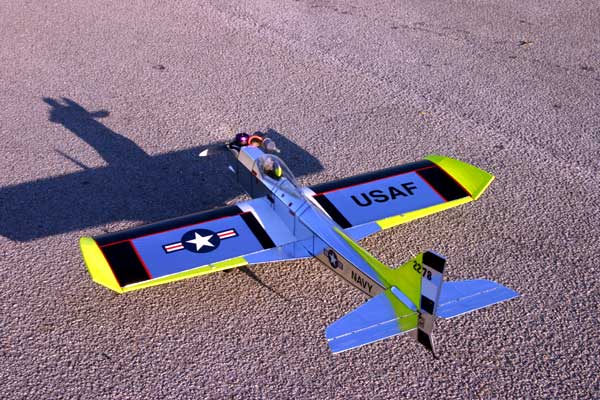

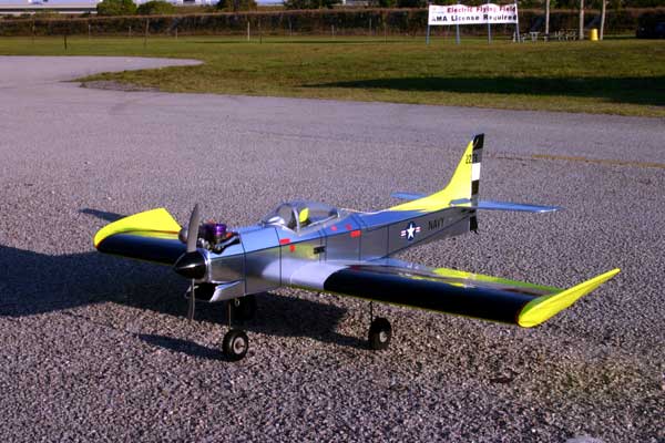

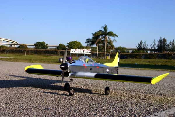

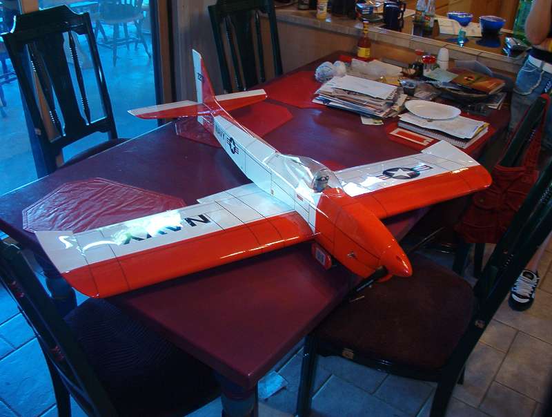

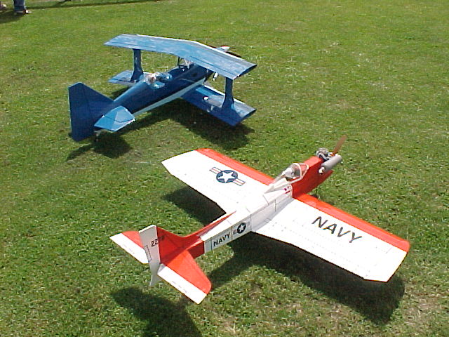

I bashed mine a bit, too. That rudder just looked too small (even though I'm not a 3-D flyer). I matched the rudder profile to the elevators and ended up adding about 40% more surface area. The canopy is tinted dark with Rit and I painted the cockpit black (my pilot is a finger-puppet of Sheri Lewis' Lambchop). She has an OS-70 II in the nose and it's a good all-around sport plane. I also made the lower cowl scoop semi-functional with a 1/4"x 1" air intake for added cooling and as a drain for any fuel/oil reside in the engine compartment.
I have triple rates, with thehigh throws from the instructions in the middle (plus 1/4" extra rudder) and I never seem to need the high rates (or the low ones, either). I have about 1/8" down elevator on the apron flap mix. I have a bit of exponential on the high and middle rates to lower response near centered. I'm a pretty sedate flyer, and in fact I have a bit of differential in the ailerons to give almost an axial roll.
Mine is yellow fuselage with orange under the wing and yellow w/black tips on the top (plus the Air Force stars & bars on the top) . I tinted the canopy dark. The rudder I striped orange and black. Everything dark is on the top except the tires. I can well imagine that silver being quite hard to pick out attitude. Looks sharp, though.
[Say, how do you load an image so it has to be clicked for the fullsize. Mine are huge!]
