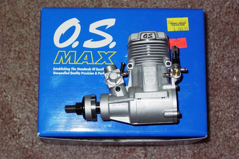

Haven't gotten a chance to do much building over the weekend. Truck got a new alternator, battery, plugs, wires and I finally got around to replacing the U-Joint that died about a year ago.
On the bright side, got all (I think) of the hardware, the engine and radio purchased.
Radio: Futaba 6EXA
Engine: OS .61FX
I'll stick some pictures up here when I get home from work.
Oh, I do still need to get the tailwheel ordered.
Now to figure out what colors I want to make it...

On the bright side, here are the pictures of the radio and engine...
My supervisor got into the pic of the radio.
