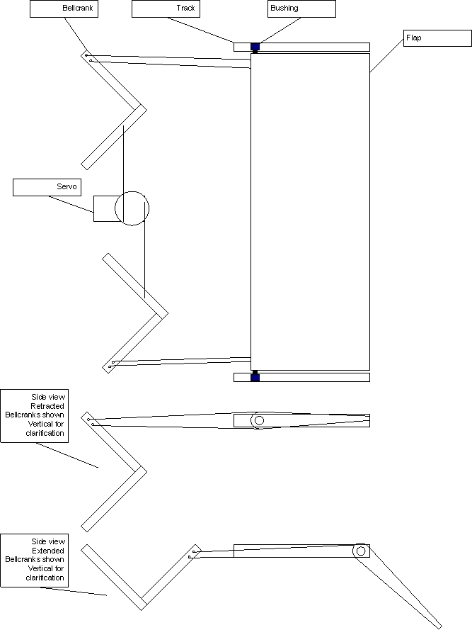

Here is what I've been thinking of for a P-38 with fowlers.

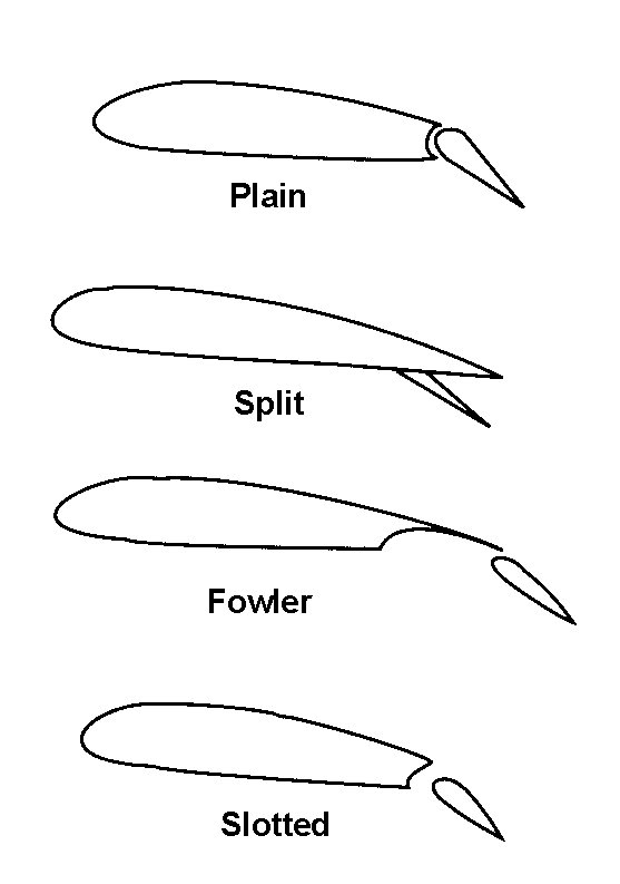

Four types of flaps. You will see them on various aircraft. Often Slotted flaps are confused for Fowler type flaps. Split flaps often do move to the rear as deployed, but the length of movement is only sufficient to create a slot. This improves lifts by allow air from under the wing to travel through the slot and over the surface boundry layer on the top of the flap which increase lift dramatically over standard (plain) or split. I addition to flaps, there are a host of high lift devices for the leading edge such as droops, slats, and slotted slats.

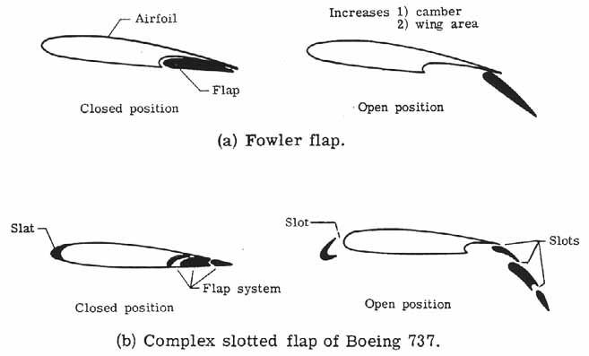

At the risk of beating a dead horse in the pursuit of accuracy, the "fowler" designation means that on extension
the flap moves aft, then down via a track, drive screw or external hinge, increasing wing chord, wing area and altering the chordline of the wing.
A fowler flap may have one, two, three or more segments. The B-737 and B-727 for instance have a multiple segment, multi slotted fowler flap
driven by internal jackscrews (hydraulic, I believe), while all single engine Cessnas since the C-150 have a single slotted fowler flap driven by an
electric motor that ride in a track similar to those sold by Robart website: http://robart.com/Hinge.aspx
Review of the following pics will show that both Boeing jets and single engine Cessas have fowler flaps, differing only in their size and complexity...
B-727:
http://www.airliners.net/open.file?i...=918272&size=L
Single Engine Cessnas:
http://www.airliners.net/open.file?i...=958272&size=L
http://www.airliners.net/open.file?i...=948044&size=L
Cheers!
Jim

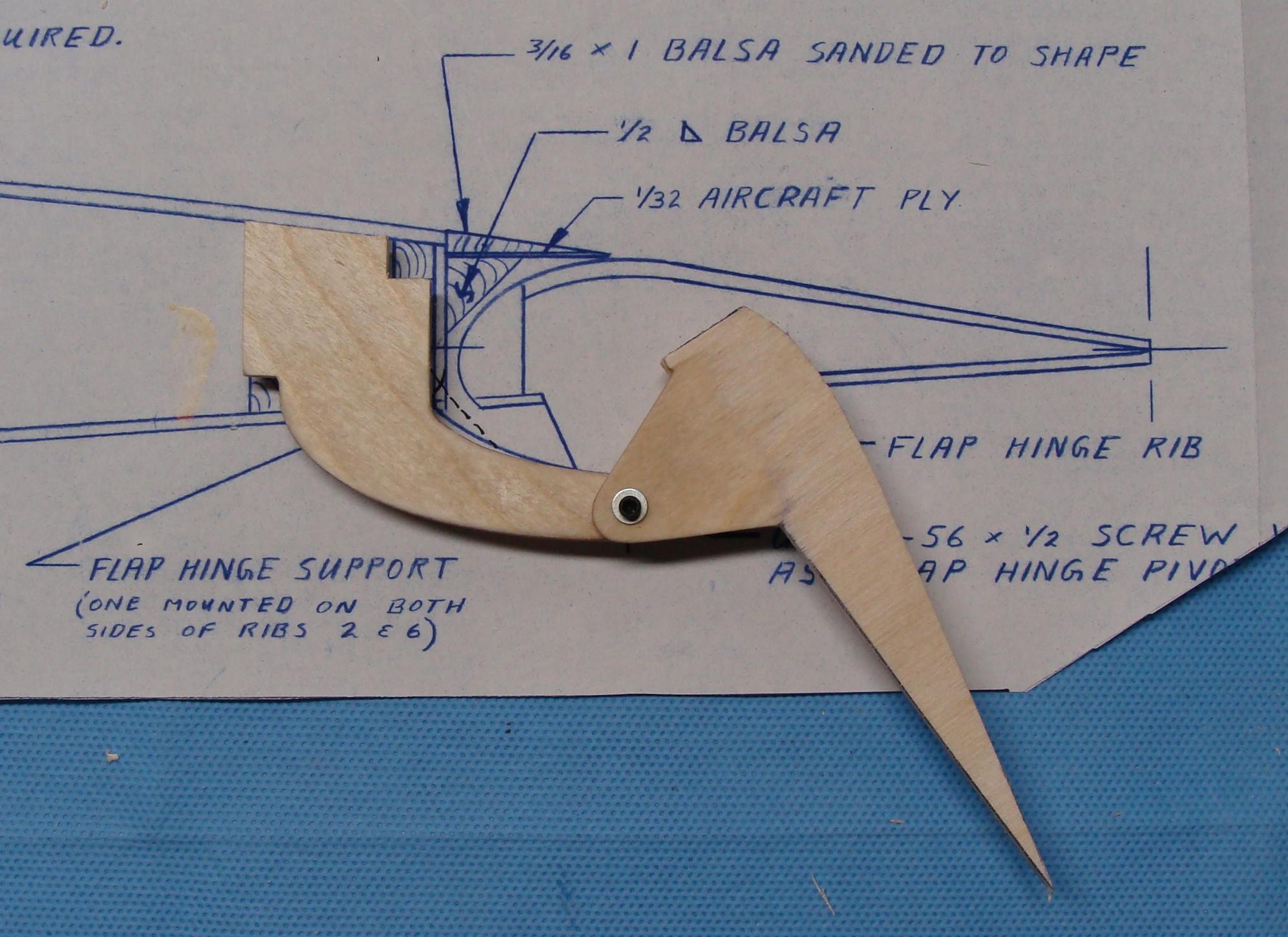

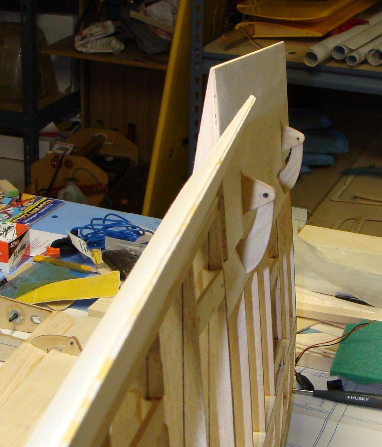

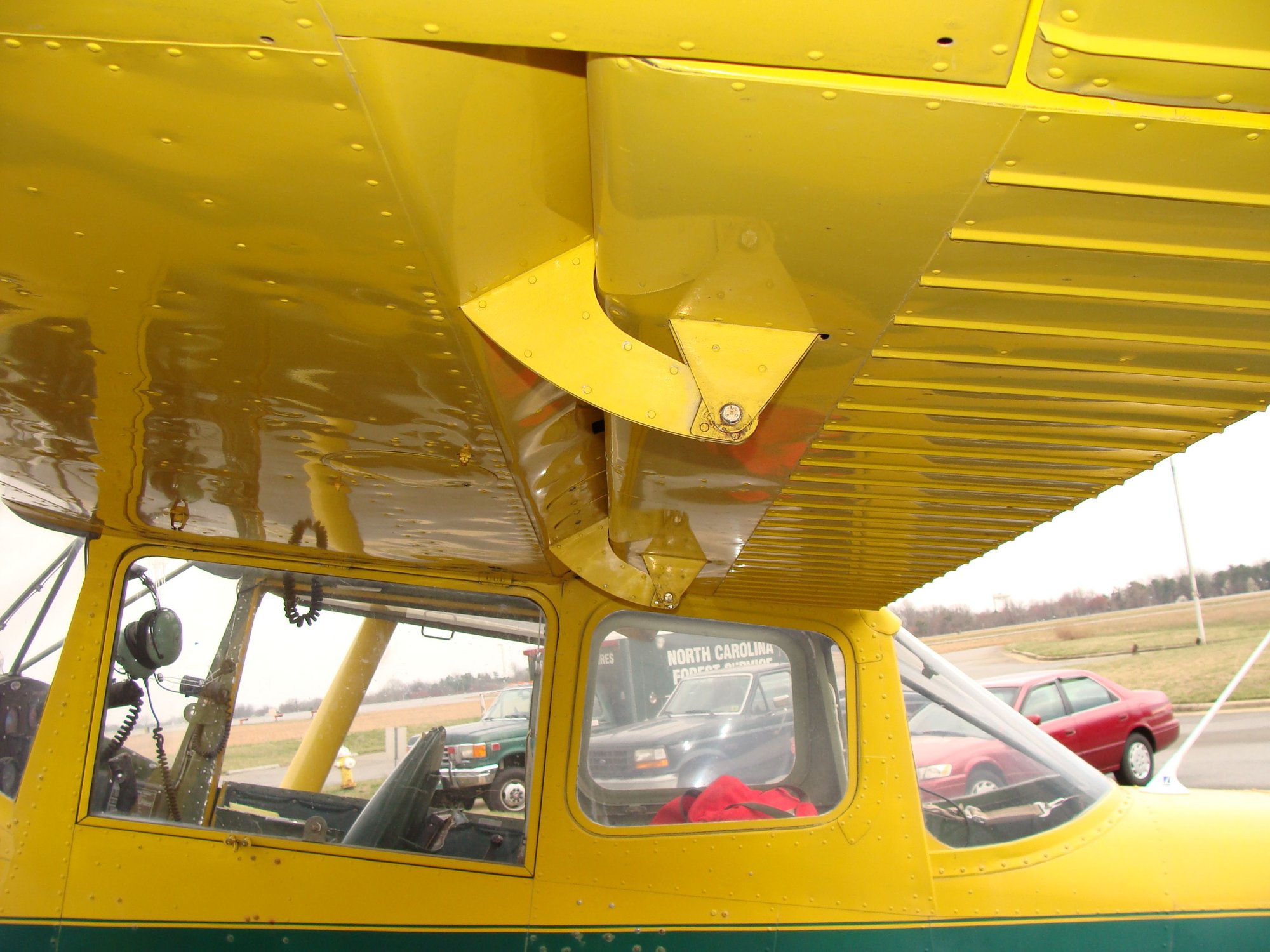

Most high-wing Cessnas have Fowler flaps, 172's, 182's, 336/337 and a bunch of others that share the same basic wing. I built a L-19 from Roy Vaillancourt plans about 15 years ago which had them. The plans only allowed for 40 degrees, but I modified them to allow the full 60 degrees the full scale Bird Dog had. I sold the plane before finishing it, one of my big regrets.
Full scale:

Those are not Fowler flaps, they are Slotted flaps.
The Fowler flaps combine very significant aft movement to increase wing area, with downward movement to increase camber.
Since such a mechanism is far more expensive to produce, with a questionable advantage for light aircraft, they are rather non cost effective which is probably the reason we usually see them only on heavy transport aircraft or very specialized STOL aircraft.
I think Robart used to sell a mechanism for making Fowler flaps on models.

The only requirement for a Fowler flap is to move rearward as it moves down. Fowlers increase the effective chord as they increase camber. They can simply pivot or they can slide. The ones on Cessnas pivot for simplicity and do create a slot and are called slotted fowler flaps. The slot allows airflow to pass through and over the flap's top surface to decrease turbulence and drag along the trailing edge, improving lift. In the case of the Bird Dog, they could lower a maximum of 60 degrees and significantly improve STOL performance on landing. If you note the picture above showing the full flap position, the forward edge of the corrugated surface is flush with the top of the wing when flaps are fully retracted, which shows how far back they have come as they drop. Up to 30 degrees can be used for takeoff. Note how little runway is behind this one as it takes off, which I have had the opportunity to ride in. It has no other specialized STOL devices that you see on a lot of bush planes.
