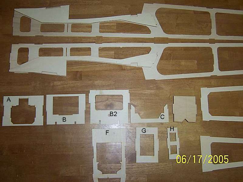

Sorting this kit out has been a real chore! I hope the rest of the build is more enjoyable. Here is a picture of the parts layout. There is still one more former I have yet to identify, I will keep working on that one. The only thing that makes sense is the instructions are out of date. The laser cut ply parts do not match the parts key! Easy enough to work through I guess but , holy Carl, Lanier or who ever
Also note that the fuse sides/tops etc are not laser cut. I found that interesting!
This picture should help anyone with this part of the build. As soon as I finish trimming the laser cut ply firewall pieces so they actually match, I will be gluing them together in an attempt to get the warp out!
Can you tell, I am enjoying this build so far !

Well, I have been checking out the rest of the kit. The plywood and the balsa throughout this kit appears to be good quality. Very impressive pre-shaped leading edge pieces for the wing and the ply sheeting for the turtle deck is great, I love the design for the usually dreaded turtle deck to fin transition found on other kits. The supplied hardware is also impressive, you even receive the wheel axles [8D]

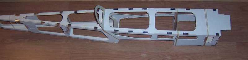

Sure comes together quick Nothing glued yet and the fit is satisfactory. An area they could improve, laser cut the entire kit.
Tomorrow I am going to align the fuse and glue it, then work on the engine box. I am quite happy despite the beginning!

That's exactly what I was thinking to do, pin the block to the side[8D] . I'm also going to make 2 supports from 1/4 inch balsa to give the block more support. Everything is going together well so far.
One area that you have to be careful with is the placing of the formers. Former A,B2,F,G and H are straight forward. I installed these in place then aligned the fuse and glued. After the glue dried I lined the fuse up with the plan again and positioned Former B and C. Be careful with former B, the landing gear blocks require the spacing to be perfect. Glue the 8 pieces to make up the 4 landing gear blocks and fit the entire setup together dry, then glue. The engine box went together well. I re-enforced the entire box inside and out with 1/4 triangle stock and I will be pinning the firewall as well as the 1/2 triangle stock it is glued to. Have to look after the MVVS 1.60
I have also opened up all the lightening holes on the fuse sides. I am going to try and build a one piece elevator and use either a carbon fiber fiber rod or pull pull on both rudder and elevator. New area for me, but I like the idea of no exposed gear and hoping to be a bit lighter.
Really happy that the fuse is complete and assembled. I was a bit worried there in the beginning [:-]
