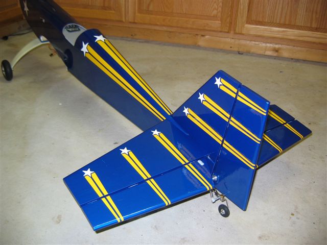

On the one I'm just finishing up I didn't increase the size of the elevators but I did split the elevators and using one servo for each half. I did increase the length of the rudder by about 1/2" to give it a little more authority. A friend of mine suggested building up the rudder and elevators instead of using the ones supplied in the kit, so he made up new ones for me using 1/4" x 3/8" stock and then sheeting them on both sides with 1/16" balsa.
I also sheeted the turtle deck with 1/64" plywood - it looks much better and is a lot stronger.
I did clip the wing by one rib, and my friend suggested adding flaps. Most guys here haven't added flaps because the plane is a floater, but my friend added flaps to his and his definitely seems to land smoother and slower than some others without them I've seen. The worst that can happen is you don't use them if you don't like them. We just basically split the aileron 60%-40% with the 40% being flap. The inboard portion of a strip aileron just causes drag anyway and isn't very effective.
Mine should be ready to fly probably next weekend, and if not, for sure the following week. I'll let you know how it goes!

You know, I didn't take a picture of the inside of the wing before I covered it, but I did make two servo bays in each panel - one in the first and fifth bays after the center sheeting. Basically I relocated the aileron servo out 2 bays. That puts the servos approx. in the middle of the flaps and ailerons. I just then put the cross braces in the bays without the servos. I'll take a picture of the bottom of the wing later this evening for you showing the hatch locations.
Of course, I had to make two additional hatches, but that didn't take too much time to do. The only thing you'll have to do is make some new holes in the webbing to route the servo wires through.
Even with all the mods. I've done to it I've finished it rather quickly I think - I started it on June 6th and only need to attach the flaps, add trim scheme, and hook up control linkages and it's ready to fly.
One other thing I replaced was the landing gear. I went with the DuBro fiber filled one they have. It has a nice curved shape to it and is a little wider and higher, plus I'm sure a lot stronger.
I'm going to be using an O.S. 91FS in it. A friend of mine has the same engine in a Four Star 120 and it pulls it around the sky, so I'm sure this one will go!!
Now I just need a pilot and I'm having a hard time finding just the right one! Any suggestion from anyone?

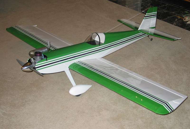

Here's my 4*60 that I modified a little. Clipped the wings, but then added rounded wing tips. Used Sig aileron stock instead of the supplied ones; added wheel pants; painted the landing gear; sheeted the turtle deck; and cut down the canopy.

While I do think the flaps help some from what I've seen at my local field, I do agree that you probably shouldn't try to re-engineer the kit on your first build. Build it stock and see how it goes. The kits are cheap enough and easy enough to build to buy another one sometime later and fool around with the design.
Here are the pictures of mine so far. I need to finish the cockpit area, add trim colors, and hook up the control linkages and it will be read to fly. Can't wait!!

The wheel pants are from a 60 size U-CAN-DO 3D (ordered separately from Tower). Takes a little modification to make them work. I fly off grass and so far they've held up.

Kerry - Very nice 4*! I particularly like what you did with the wingtips - I always thought the 4* needed some such as proper wingtips to finish the wing off. Your canopy and turtledeck mods look great as well.

ORIGINAL: Troy540p
Kerry , Nice job on the 4*. What color of green is that?
Thanks Troy
Thanks Troy
Kerry

RE: SIG Four Star 60 modifications
ORIGINAL: radioflier
I'm considering doing something like this to a Sig Something Extra. Will probably use the wingtip design from the Mid-Star 40. A few more changes on the tail and it could look like a control-line stunter from the 50 - 60s.
Thanks for the complements. I've never really liked a "slab ended" wing, so that's why I added the tips. They're easy to make, and I can give instructions if anybody is interested.

By the way, I recently increased the size of the rudder. Now I can knife-edge all the way across the field.
Plus, I got a new radio so that I can mix elevator in with the rudder. I've got 20% elevator mixed in to help keep the nose up. I think that the nose-dive that occurs when using rudder is one of the weaknesses of this plane. It may be what Bruce Tharpe means when he talks about his Venture 60 being an improvement over the 4* 60 design.
