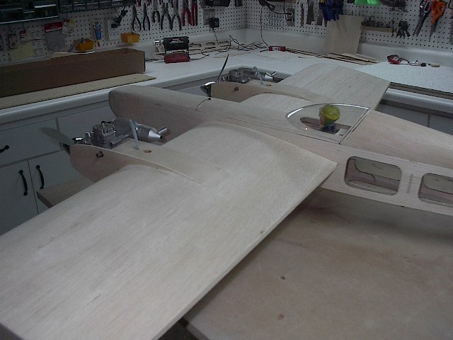

Manny....I just got my sixth SSE kit in the mail today and will be starting it tomorrow. This one will be a dual fuselage twin. If you're interested I can post some pics of some of the mods that you can apply to yours; sheeted turtledeck & wings, enlarged rudder, tailwheel supported by the fuse instead of the rudder, shortened canopy and cockpit, seamless monokote hinges, different pushrods and a few methods for building it so it will balance without adding dead weight.
Don't forget pictures of yours, we love pictures.

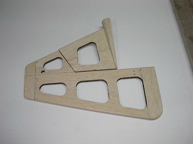

Nice kit. Follow the instructions for carving the fairing pieces that flare the fin and stab to the fuse and each other. It works great.
Take extra care with the large rib at the root of the wing. You don't want any twist, bend or bow because this rib will need to sit flush against the fuselage when the wings are attached to it.

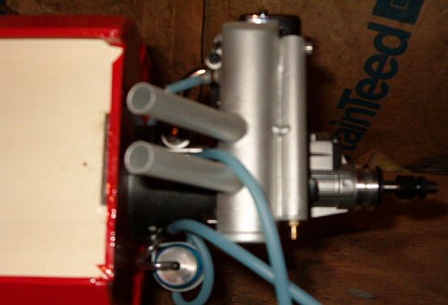

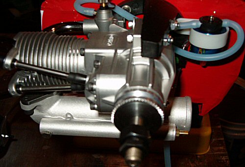

I've had and OS 46 FX in both of my SE's. They did great for me. I don't do any 3D type manuevers so this motor was more than enough for me.
Ken

Here are some of the pics from the mods I did on the last one and mentioned here that worked well. I forgot the order of the pics I uploaded but believe they show pretty much everything I talked about yesterday.
Damon
EDIT Sorry guys for the huge pics, thats the second time thats happened and I don't know how or why it did it.

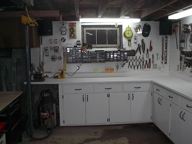

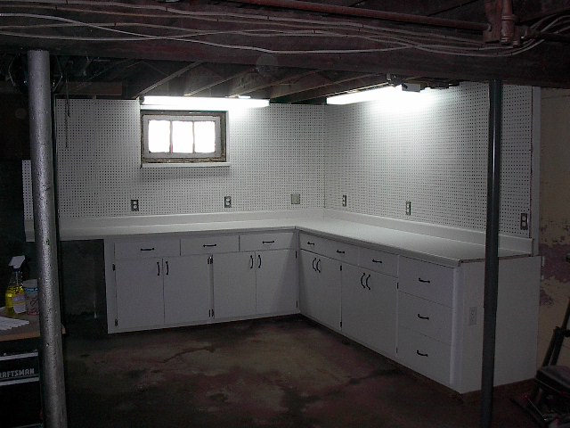

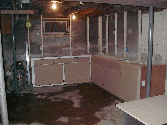

Tychoc...thanks man. When we moved from TX to VT we bought a house that's over 100 years old. With the very long "building seasons" up here I couldn't rest until I had a suitable place to build so I did the best I could with what I had.
Manny... Did you your SSE come in last night? Oh wait, I know, you've been too busy building to update us. Come on man! Give us some pics! I started mine last night but didn't bother taking pics because all I did was cut new parts from the kit to make the second fuse.

hey, can I move in your house? That is pretty nice setup.
I am starting on the right wing last night. Man this is a little difficult from the ARF's. It is just taking some time. I do not like to rush it. I will have some pics later tonight of the wing. I can only work on my SSE when my son is sleeping. My VF is coming next week and I like to get that one finished, too.
Hey, do you use the wood glue everywhere?
Manny
