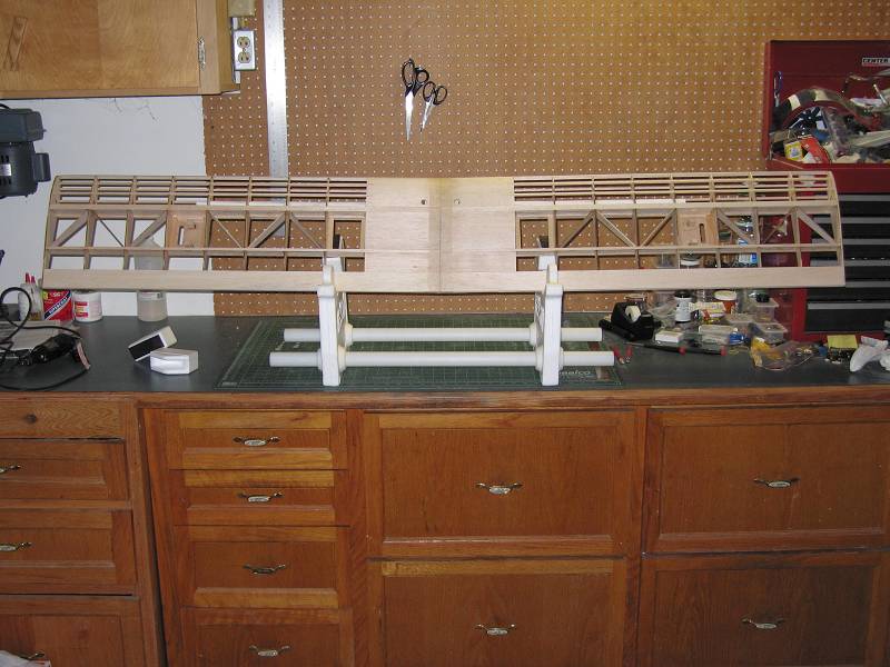

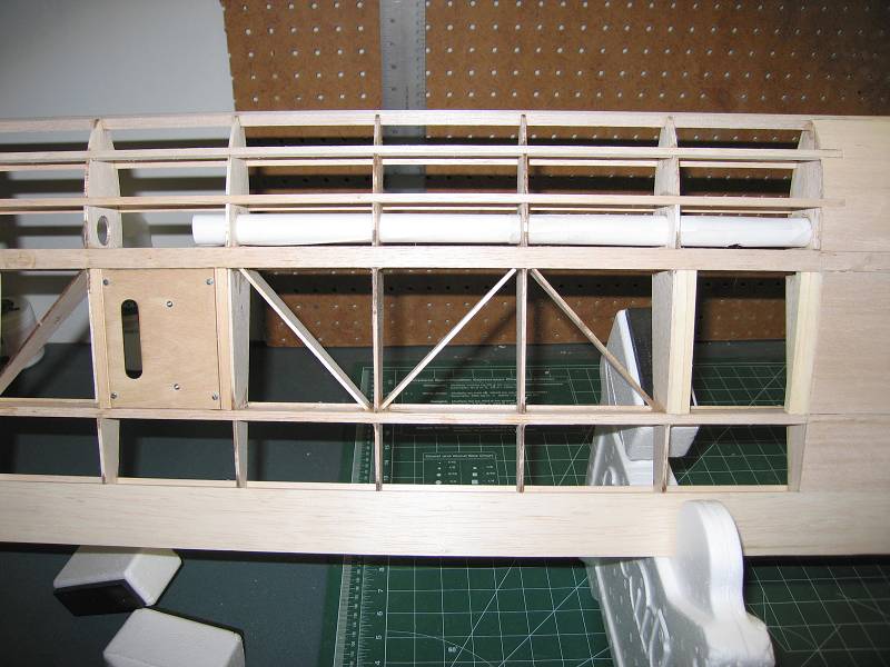

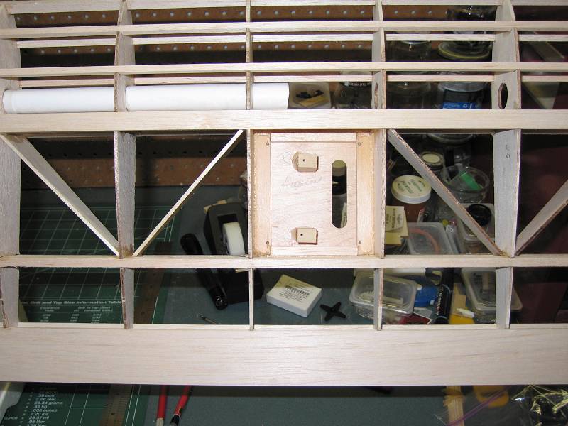

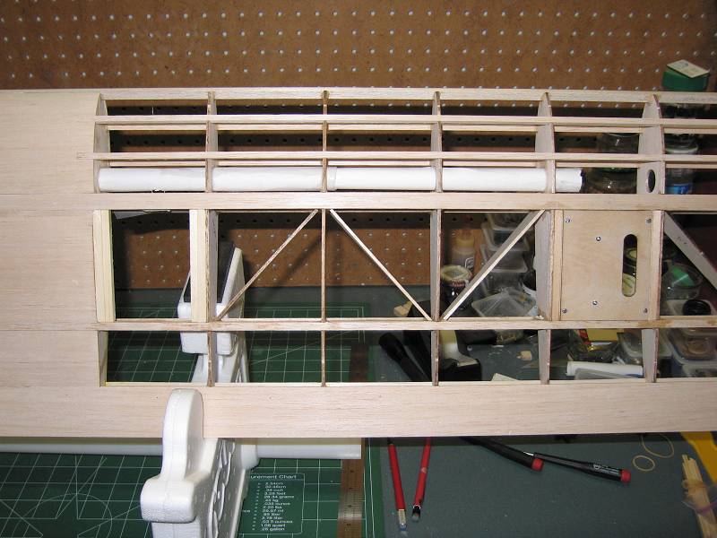

Going slow but I made a little progress today. I removed the diagonal braces from the bays next to the sheeting and also 5 bays down. Made new braces and glued them into place. Made a set of servo hatch rails for the flaps and glued them in. Waiting for my band saw that I am hoping to get on my birthday to make the hatches for the flap servos. Glued on the ply end ribs and fiberglassed the center of the wing. Plus a little sanding. After reading this I guess I got more done than I thought. It just didn't seem like it at the time. I want to thank Leon, rc_heli_flier, once again for all the help he has been giving me in ideas and what he has done with his 4*60.
Thanks, Gene

Thanks Gene, glad to help!! Besides, I got most of my ideas off of others on here and in my local club for the mods that I did to mine. I'm just trying to pass them along.
Gene, your wing looks great, very good job indeed. I can't wait to see the rest of it come together. You will love this plane when finished.

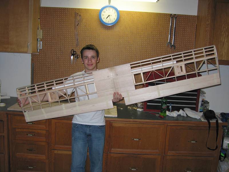

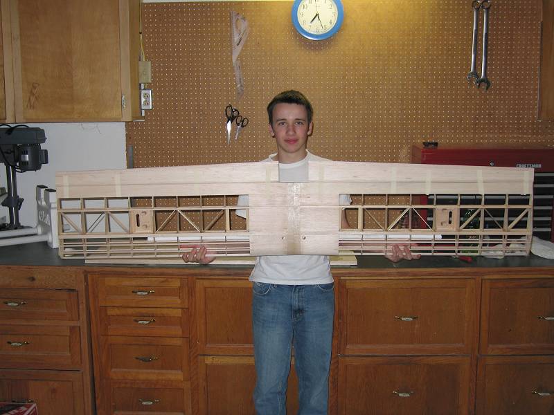

Made a little more saw dust today. I glued 1/2 " triangle stock to the leading edge and extended the trailing edge by 1/2". The aileron started out at 2 3/8" and ended up at 3 1/4" at its widest point.
My son Adam put down his lunch long enough to hold the wing for a couple of pictures.
Gene
Gene

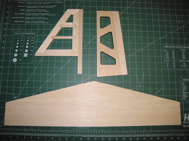

I don't have the engine yet so I'll be jumping around a little. I built the stab and fin today. Managed to sheet the stab before I had to quit. I enlarged the rudder by 1" and it will end up being 1 1/2" at the bottom. I will drill some holes in the material I added to the rudder to lighten it up a bit. I am going to counter balance the rudder and elevator unless someone knows a good reason not to. I glued an extra rib next to the outside ribs on the stab and above the top rib on the fin. I will cut in-between these ribs for the counter balances.
Gene
