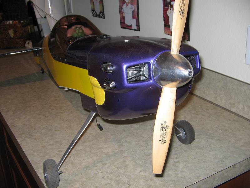

gumhead, if you're wondering how much your new Saito 91 is going to stick out...

ORIGINAL: Devo
Nice!
Is that Metallic Plum? I picked up a can last week, I'm thinking of half white and half metallic plum with metallic green trim for my color scheme.
Did you need any lead in the back with the 91?

That is one big prop, devo. Isn't this a .40-size plane?

ORIGINAL: nickj
Yes it is... Can you say maximum power
