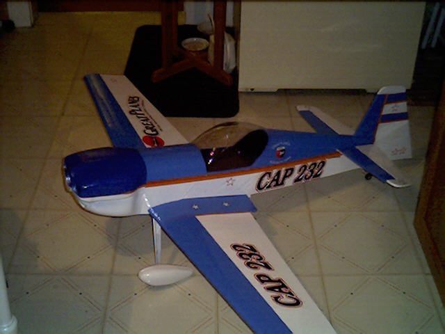

Default RE: GP CAP232 Build
I built the same kit a couple months back, and was extremely pleased with how well things went together with it. Looks like you are doing a great job, and I am really enjoying your build. Keep up the great work!
