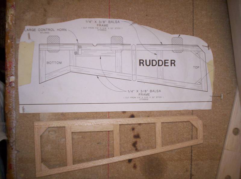

Looks like your really moving along with the build! I like what you've done with the tail feathers. I can't say I've ever seen a Contender with counter balanced control surfaces but it looks great.
I've just got my Contender plans copied and I've begun playing with the tail configuration. Next comes the clearing of the bench and the set up for a new build.

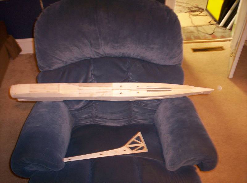

Scott,
your fuselage looks great! I think I'm going to use a 46AX for power, however it's going to be inverted. You've done a nice job with the cowl area. Looks good, keep up the good work.

The Fox .46 ABC will go on its side. I prefer to side mount my engines as I feel it makes for a better centered tank and can hardly flood. Here is a few shots of the rudder and wing tips. I did not mount any wingtips. Last rib is stiffened with a 1/32" ply peice. This should help it to avoid some of the dings and nicks. The rib was also to flimsy to resist the shrinking of the covering. Saved a little weight by leaving off the last shear web in each rib bay. I did not include a picture of the airelons. I made them slightly bigger by tapering them to 1" instead of 3/4" at the outboard end. I'll probably glue in the bottom hatch as I really do not like a hatch. I think they let in fuel, look poor, weaken the structure and I have never had to get to a tank in any model after install. However since the hatch allows access to the nose gear I may have to compromise my principles.
I'll post some pictures when I've made significant progress.

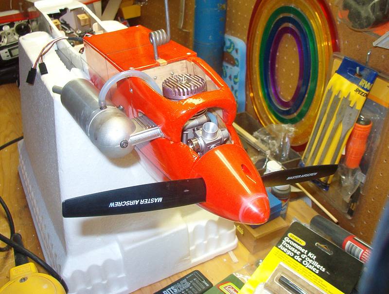

My Dad finished his this summer. He has a inverted Tower .46 which required no additional weight anywhere. There was plenty of room to move the battery around for balancing. His inverted engine has a removable chin cowl that has an open scoop for cooling. I will tell you, this plane "Flys" with the Tower .46. He did go with everything else standard. Though his wings are straight an true, we think the upsept tips are just off a little. Being at the tips, it really has required a fair amount of aileron offset, so much that we have talked about adding adjustable trim tabs at the wing tips. The wing tips provide a fair amount of surface area, but I don't think leaving them off would really reduce much lift, I would go without them.
I really like to mods on the rudder that I seen here.

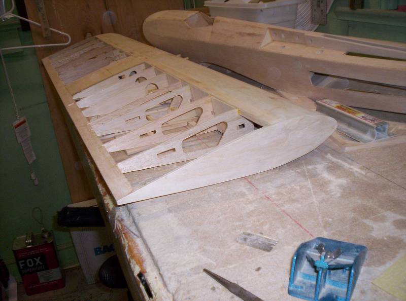

#36
One of the reasons for the upswept wing tips is to get some dihedral into the wing. A flat wing on a low wing plane will produce a roll opposite to the rudder. That is, is you fly level and put in right rudder, you'll get a left roll, not something you want. Dihedral counters this effect. The upswept tips give the wing some dihedral effect.

I have will have my camera with me today. If I can stop by my Dad's after work I will snap a few detail pictures. He made a removable chin cowl from balsa. Then he strengthend it with Fiberglass mat (available at home depot, about 2 Oz wide weave great in two layers to strengthen curves -- 3 to 4 if your making just a fiberglass cowl). He used hardwood tabs on the firewall for the #2 button head screws.
If your interested in shaping and making a cowl out of fiberglass, its pretty easy and there are a couple of methods.

I bulit mine with 30% more rudder area, and the center of effort lower (closer the plane's axis of rotation). Followed the shape of the horizontal stabs. I did the upswept wing tips, but, doing it over, I would go with the straight. The upswept is supposed to cancel the tendency to "Dutch Roll" (a snap roll opposite the rudder input), but I think this may have been due to the original rudder having the area high on the surface. I'm no engineer.
I have talked since to pilots who left out the wing tips entirely, and one even chopped a panel out. Only drawbacl, aparantly, is a faster landing speed. I have an OS-70 II in mine and it is a bit heavy. Plenty of power, but it doesn't need the apron flap to drop plenty fast on approach.

It's probably worth mentioning that Hoerner tips are an attempt to reduce induced drag caused by the wingtip vortices.
Adverse yaw and dihedral are entirely different subjects.
Omitting the Hoerner tips does little more than effectivly reduce the wingspan by approximately double the width of the Hoerner tip.
Wind tunnel tests have shown that the Hoerner tip has little effect on aircraft of this size.

Thanks for sharing the pictures of your Dad's Contender. The photos you posted of the inverted engine will help me along the way no doubt. I also like the fueling system that has also been added, I would like to incorporated that into my build as well. Your effort is greatly appreciated.
