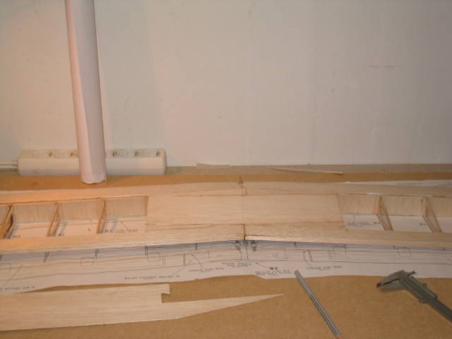

Hello all,
I will start today building the GP ULTIMATE.
I need some help in choosing a motor because I am very confused with the engine choises of other builders.
Some are using .46 to .90 2 stroke. Others .65 to .91 4 stroke.
One thing is for sure. The plane will be a little bit heavy even without the engine.
I love 4 stroke engines but they are heavier and I am not sure if the are going to fit in the cowl.
As far as for 2 strokes I stopped using them for some years now but have no problem trying them again.
Suggestions are welcomed.
Besides that I need some info and maybe some pics on how to use dual ailerons.
Please help.
Thanos.

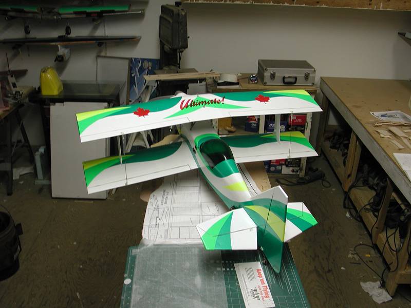

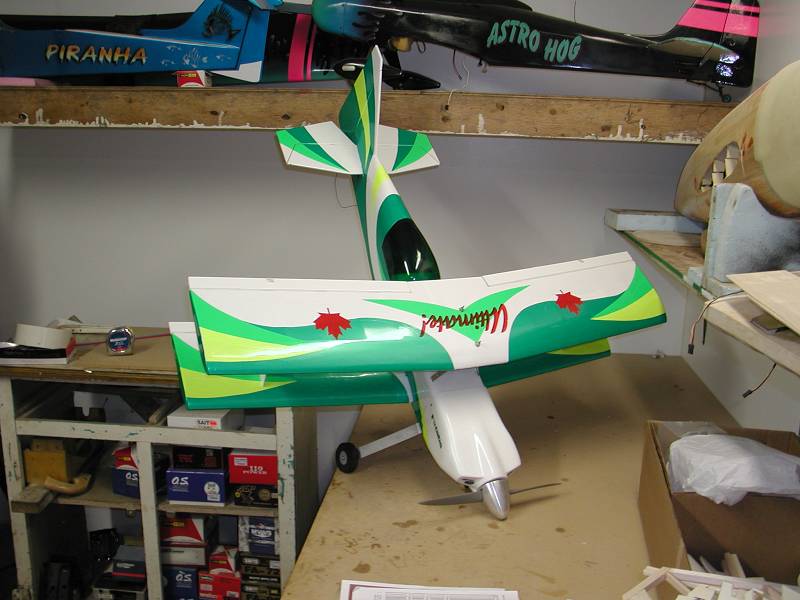

Old 10-18-2005 | 03:29 PM
Posts: 474
From: TERRACE, BC,
Default RE: GREAT PLANES ULTIMATE (kit)
Warbirdairracer,
I am suprised you can fit a 14 inch prop with the stock landing gear.I had to change my landing gear for a taller one.
Here is a few pics of mine.

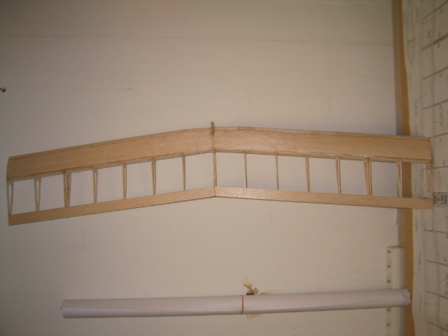

Old 10-19-2005 | 04:18 AM
thanosg2004's Avatar
Joined: Oct 2005
Posts: 76
From: Varkiza, GREECE
I would like to thank you all for your help.
Will attach pics of my project.
Thanos.

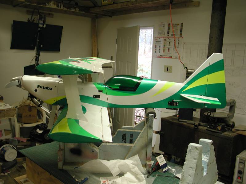

Old 10-19-2005 | 06:27 PM
My Feedback: (18)
Joined: Feb 2004
Posts: 539
From: West Monroe, LA
I'm almost done with mine - that's an outstanding trimscheme BTW.
Using a Magnum .61 XLA-R for power - was an act of congress to make everything fit under the cowl, just to find that the Pitts muffler didn 't fit inside the cowl, requiring a nice big hole to be cut in the front mf my Stan's fibertech cowling I bought.
I said screw those ABS wheelpants, and bought a $12 pair of fiberglass pants for a U-Can-Do 46 and repainted them - if I had covered the plane in Red I wouldn't have even needed to repaint. $12 was well worth me not having to glue fill and sand the ABS pants.
I'd post a pic, but my webserver is down for repairs - maybe a little later on.
