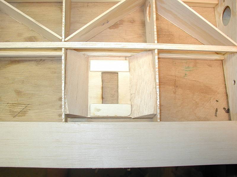

Here's a couple pics of the servo mount in the right wing panel.
All I did was take a piece of lite-ply from the kit and sanded it down to fit in between 2 ribs. I glued it in with a couple pieces of 3/4" tri-stock. Hacked a hole in it and then added a couple strips of lite-ply to the back for the screws to grab.

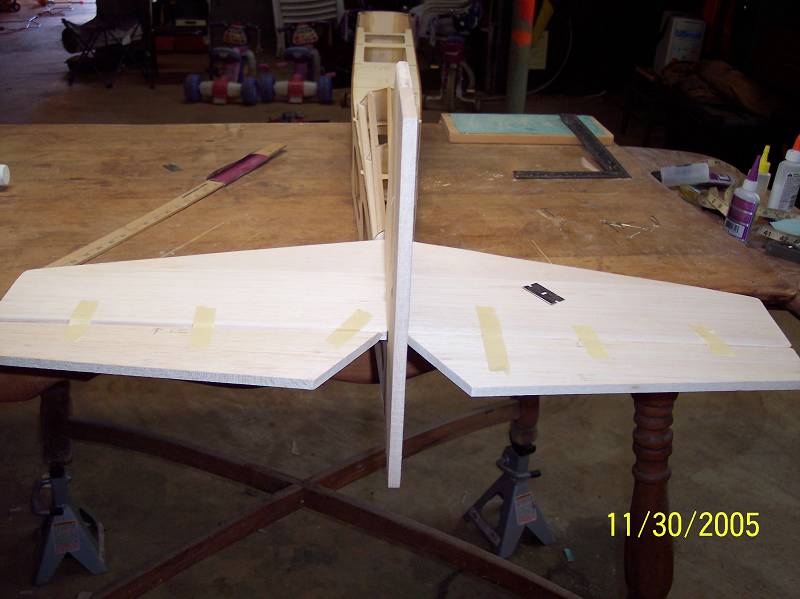

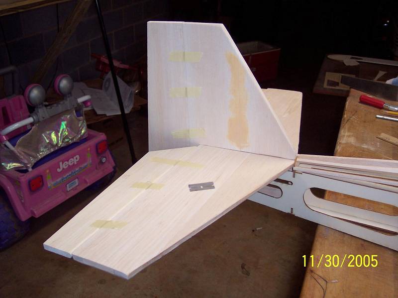

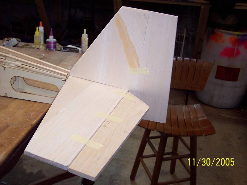

CHEATH- Have you thought about rounding the corners of your tail feathers? Maybe 1" to 1 1/2" radius. Won't hurt flight performance one bit.......Take some black paper or tape and play around with blacking out what you could cut off the corners.
