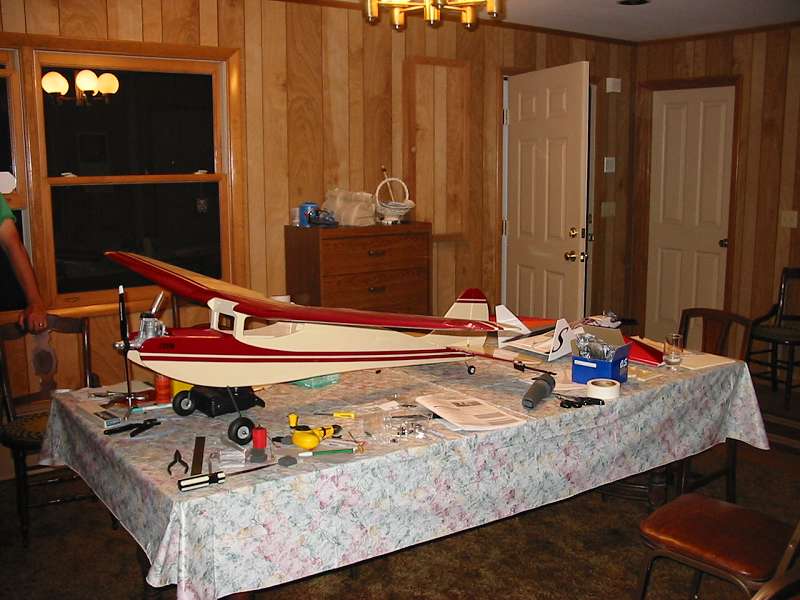

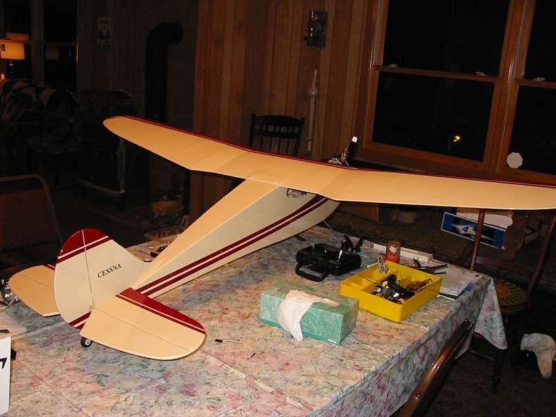

Here are a few pictures of my Old Timer I built last winter and flew all Summer. It was my first airplane, and obviously then my first kit. To me it seemed a bit of a challenging kit, although I've seen others say it was an easy build. I received lots of help from guys in my flying club, and even ended up having to reorder wing parts because the build method seem to cause the wing to warp. I believe since then GP has updated the build method/parts to prevent this. I really like flying the plane, and was an excellent springboard for me to really dive into this hobby! As shown in the pictures, I even added floats.

To all, I gave this kit to my father for Christmas '02, and he built it the rest of the winter and flew it all summer long. I wasn't really involved, but talked to him a lot about it, so here's my impression:
Building:
- He's built a bunch of kits (including 1.5 royal kits) so he's a pretty good builder, but it's my impression that by reading through the instructions, thinking things through before hand, and taking your time it's really straight forward and easy.
- He built it almost exactly as per the instructions. Only change that I'm aware of is that he enlarged the whole in the rudder to for the elevator travel.
- It's a decent sized plane so it's easy to get everything together and has plenty of room for anything you'd ever want in it - he added a cockpit this winter that really adds to the overall look.
Flying:
- Depenind on how you like to fly this plane is perfect. He flies at 1/4 - 1/3 throttle and it'll fly all day. It tracks very well in the sky, is very stable and turns very easily with no ailerons. Takeoffs are real short, and landings are very easy, with my only comment there that it will probably land slower than you think...
Equipment:
- His has an O.S. FS52 which is more than enough power, an FS40 would work very well.
- three standard servos are more than enough for this plane
overall definately a very well thought out and designed plane...

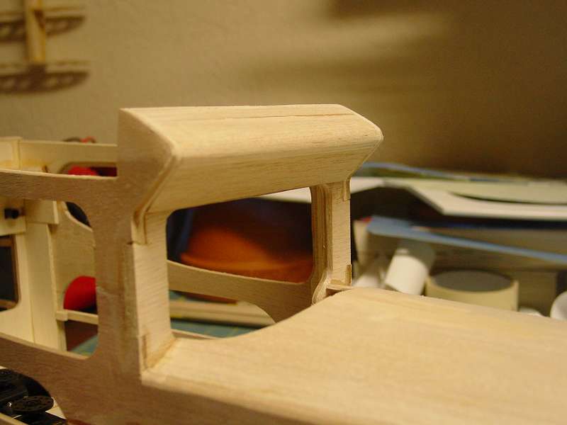

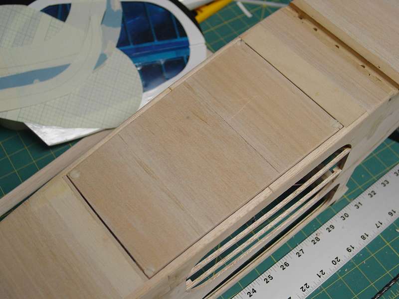

a couple of picture before the canopy and cockpit were on it...also without the wheel pants....only negative from my point of view is the wheel pants...he's since bought some fiberglass ones that are a lot easier and nicer to work with.

Floats: They are gel coated fiberglass floats from ESprit Models ([link=http://www.espritmodels.com]www.espritmodels.com[/link]). I ordered the 36 inch sized ones. They look great and are easy to work with. If you get them, you will definitely want to check for leaks in the fiberglass seal (both mine and another guy's had leaks).
Building: Like I said, this was my first kit. To me, the kit directions were definitely straight forward and easy to follow. But I still had troubles, like I said. As far as I know, the materials were fine. I do agree about the wheel pants Zepp. I still have not finished them. If you have information on the ones your dad used Zepp, I would like to check them out. For the most part, I built per the plans. There were a few things I changed. First, I filled in the area of the former that the wing dowels fit into. This really cleaned up the look of that area without having to paint the canopy. (see picture below) Second, I added a hatch to the bottom of the fuselage. (see picture below) This allows me to add in things like cameras, parachute drop mechanisms, etc. All I do is make a new hatch with the function I want. I think I also opened up the hole in the rudder. Another thing I did was add some reinforcement to the cockpit area (triangle stock in the corners, etc). I added reinforcement to the stringers on the fuselage (the butt joint isn't quite good enough). I used a different tail wheel mount (Dubro I believe).
I wanted to add in a pilot. My first choice is Gandalf from Lord of the Rings. I've had a hard time finding an action figure in the stores.
Equipment: I used a O.S. .46FX engine. This engine definitely has enough power for the plane. You said you might go electric Dan, and I think you probably can, as the plane seems to be light for its size, as far as I know. I too am only using 3 servos.
Flying: I really enjoy flying this plane. Zepp, your assessment is right on. Some of the guys in my club thought it should land a little slower though (being a 3 channel plane). I thought it landed just fine.
Future Plans: I plan on building a second wing with ailerons. I'm going to hold off though, as a guy in our club is already doing that. I want to see how his version flies before I build mine.

I really like the look of yours, and I like the addition above the cockpit, ours was just all painted the same color to try and blend together
