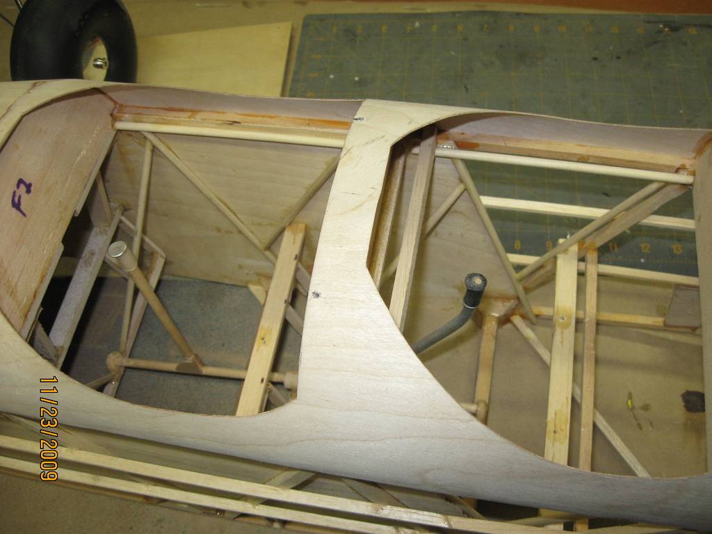

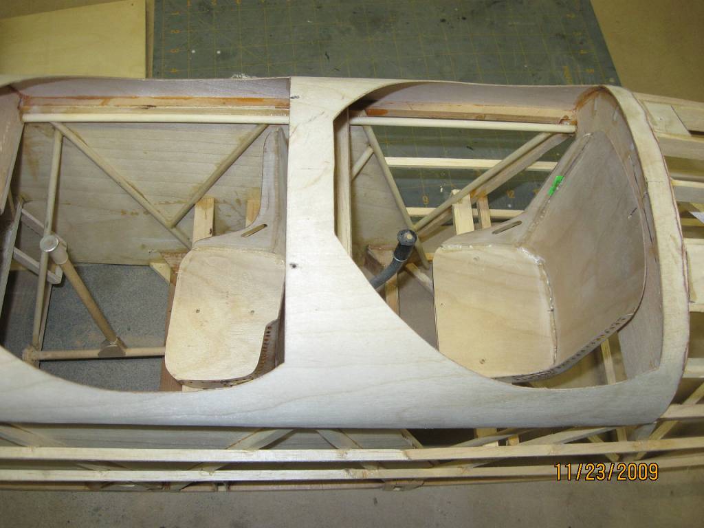

Finally got back to building. Finished seats and basic cockpit. I want to paint cockpit before I cover fuse. a few pics.

A few more pics, seat W/ upholstery

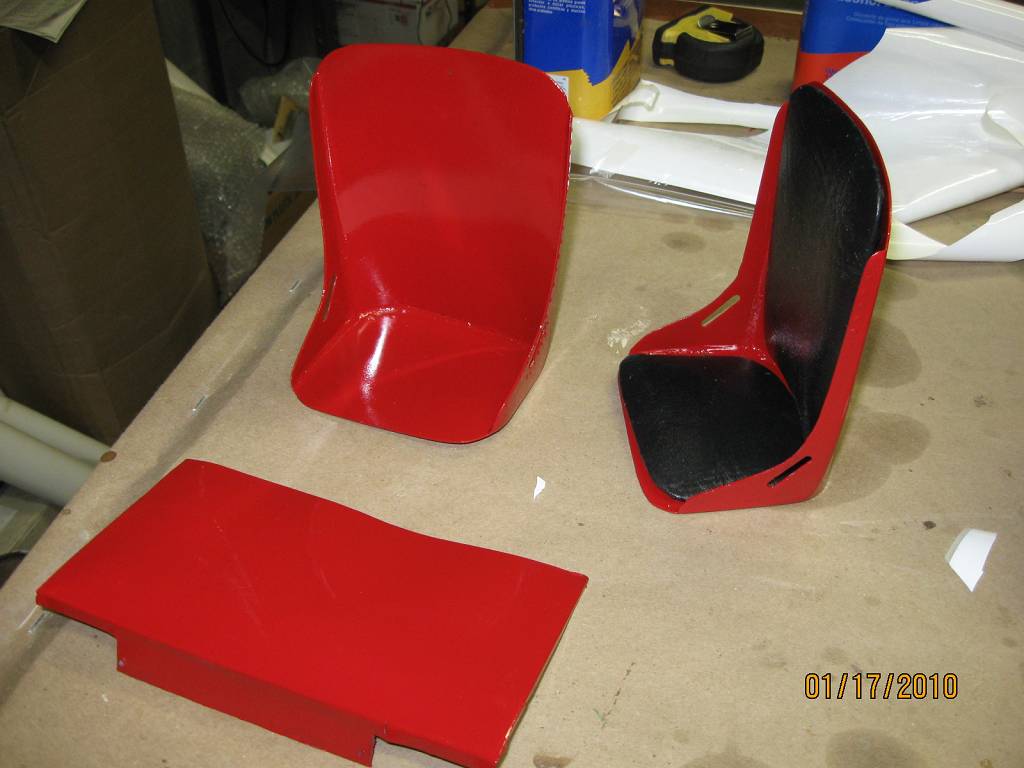

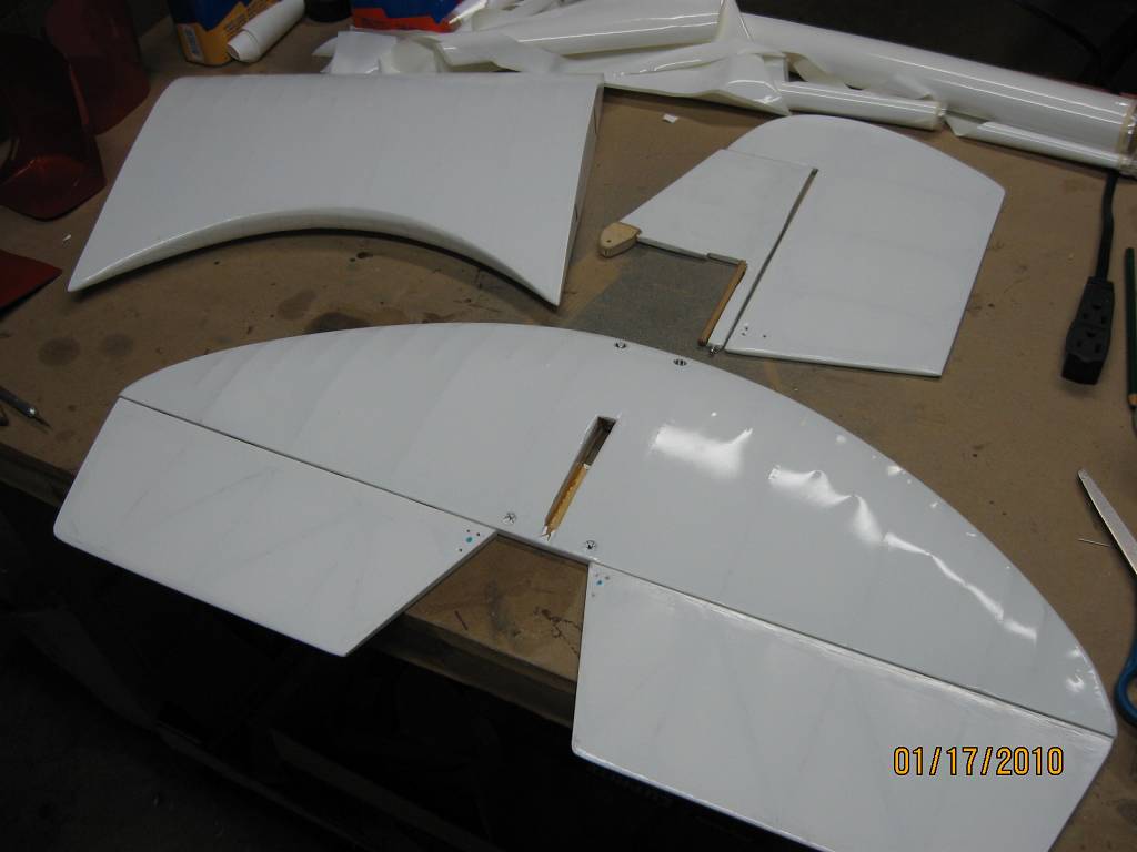

FINALLY GOT THE COCKPIT PAINTED, AND THE TAIL COVERED. WILL WEATHER AND FINISH DETAILS AFTER THE FUSE IS COVERED AND PAINTED. HEY BASSBUG HOW'S YOUR'S COMING ALONG HAVEN'T HEARD FRON YOU IN A WHILE..... STEVE

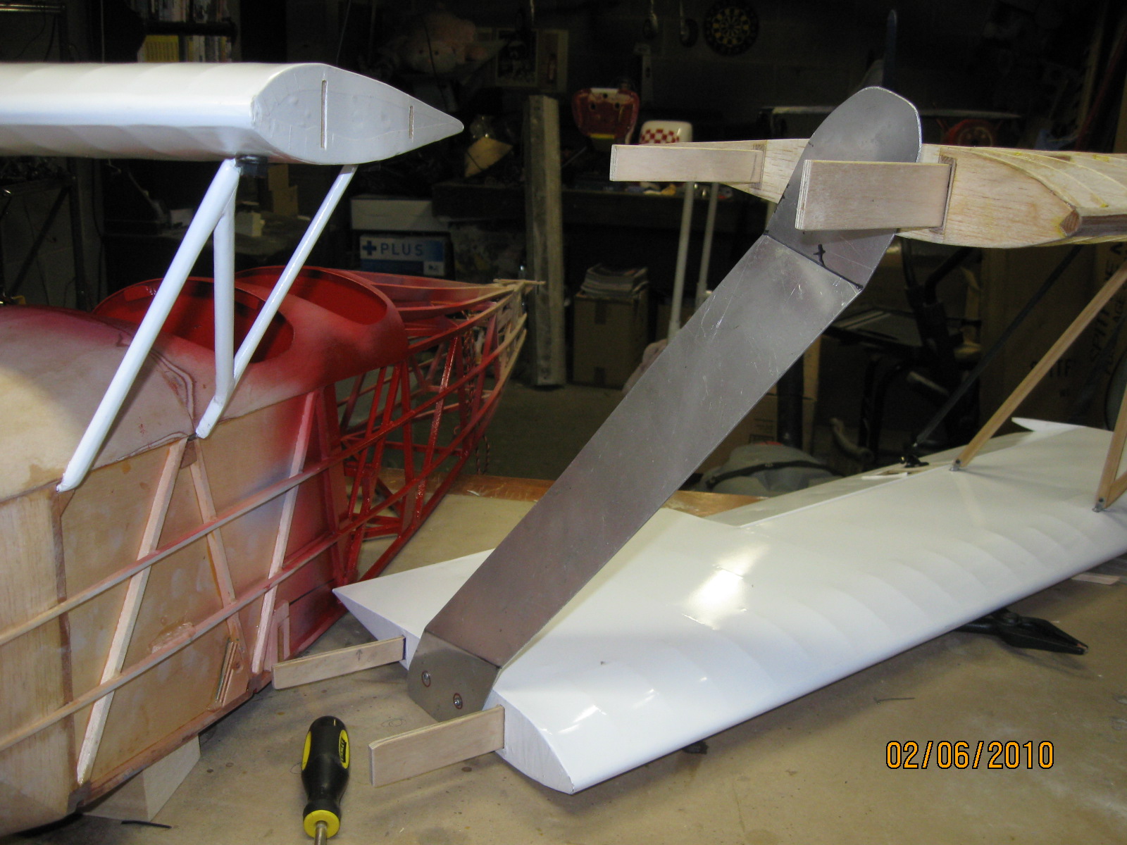

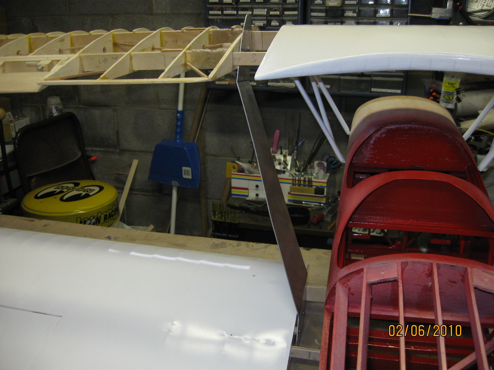

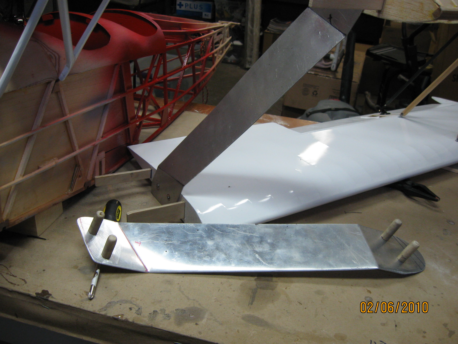

Hey guys, finally got my ailerons done on the top wing. I also made wing supports for when the wings are off so that the struts and wings can be left assembled for transport. The supports can be slid in place with the wings still on the plane, just slid out a bit, then a small bungee from the support to the strut should keep it in place. Should make setup and transport a whole lot faster and easier. Nice job on the rib tapes Bassbug! ............ Steve

Sorry guys ,not sure why the pictures came out so large. I did everything the same as before .
