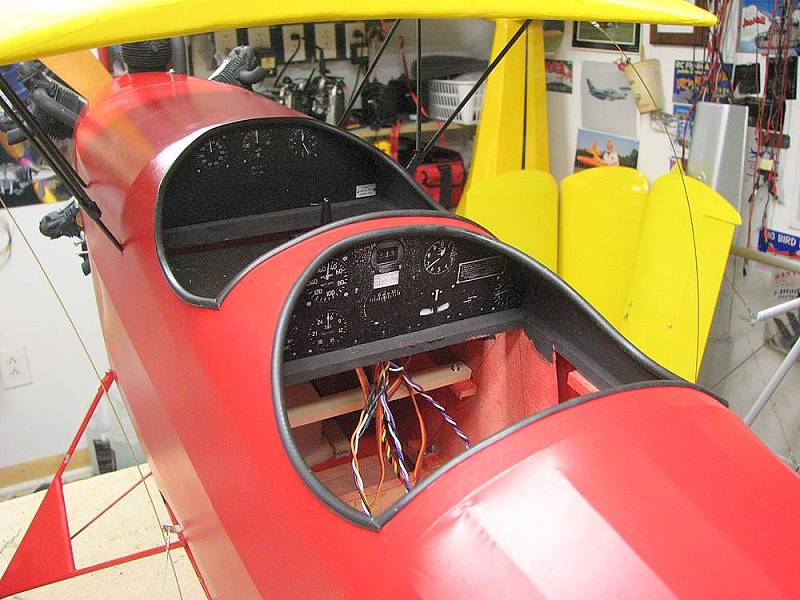

With 2 giant servos in the tail and the batteries, receiver and throttle servo located under the rear cockpit, the CG came out exactly in the middle of the range specified on the plans.

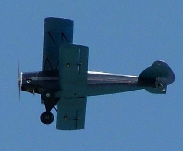

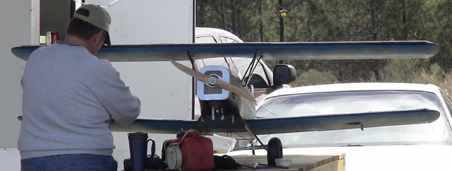

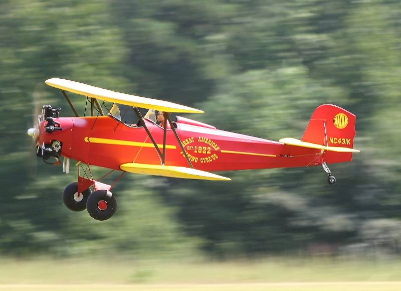

Here are a few pictures that were taken at our field (Jedburg Flyers http://www.jedburgflyersrc.com/ ).

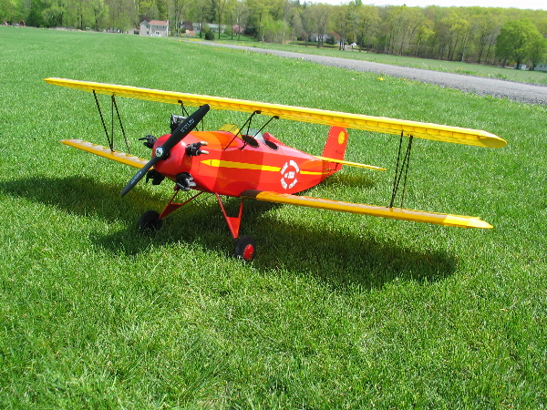

Here's my 1/4 scale Concept Fleet. I built one 20 yeas ago for the magazine and decided to do another. Basically the same plane and kit price went up $60.00 in 20 years.
Using a G-38, SolarTex painted with Krylon Fusion, weight is 19 lbs 3 oz minus fuel.
The windsheilds and pilot are all that is needed to complete.
Will test fly once the rain stops.
That's a very nice job, Dick.
Did you build the upper wing stock, and are the flying/landing wires decorative or functional? How about the gear; does the rigid gear work OK when landing?
Jim
Jim
The wings are both 2 piece, joined at the center.
Wires are functional but not necessary.
The only "suspension" in the main gear is the amount of air in the balloon wheels!
It takes about 10 minutes to set up or take down at the field.

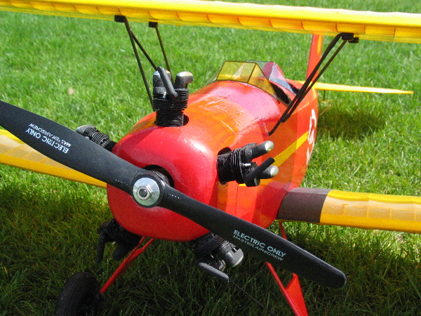

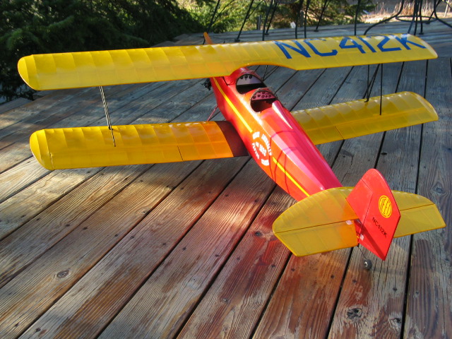

As a result of my search with Google and finding images of your Fleet model on this website, I had to join this forum and share my experiences with my 1/6 scale Concepts Fleet biplane and some pictures. My work shop and truck allow me to leave the model assembled and ready to fly when the opportunity happens. The business end has a geared 40 Astro with Astro controller, a BRC, and a 20 cell NMDH pack. A servo module drops a parachute when extra entertainment is requested. I like your choice of wheels on your Fleet. Are they Trexler tires?
