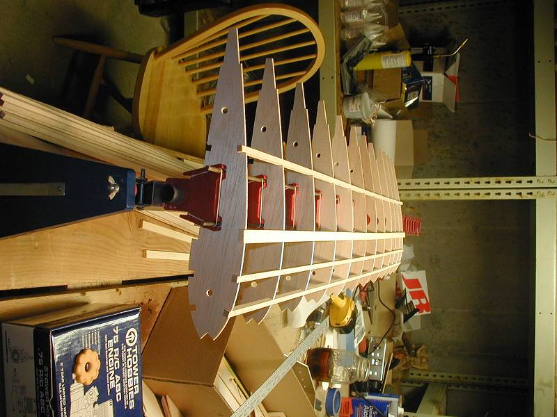

I have access to one of these NIB, wondering what they would have retailed for when they were available?
How useful ar they?
Anaconda
Old 12-12-2005 | 11:07 PM
Rcpilot's Avatar
My Feedback: (78)
Posts: 7,808
Received 9 Likes on 8 Posts
Default RE: Adjust-to-Jig
ORIGINAL: anaconda
How useful ar they?
Anaconda

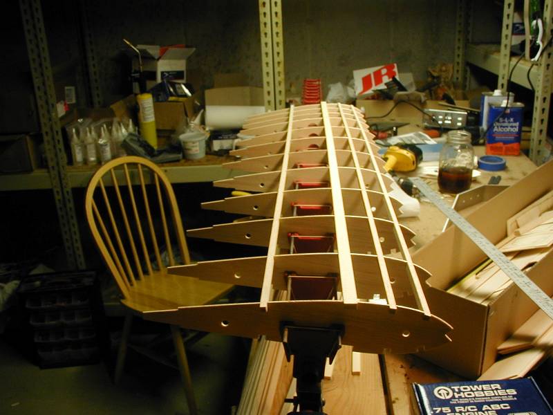

They cost about $125 when I bought mine 6yrs ago.
They are extremely usefull for building constant cord wings. Anything like a 4* or LT-40 wing is perfect for this thing,
I think you can do tapered wings on it--but I have no idea how and I've lost my directions.
They are beefy and heavy duty. I have mine mounted on a 2x10 board about 8ft long.
It takes a little time to set it up--but once you get all the ribs strapped down and start gluing--your done with the major framing in 20-30 minutes.
It's not totally idiot-proof. You DO need to pay attention to what your doing when you set it up and strap the ribs down. But, with a little care--you'll get a perfectly straight wing out of it everytime.
There are also fuselage attachments for building the fuse on it too. I've only used it for that once--and that was more trouble than it was worth.
For wing panels--ya can't beat it.
