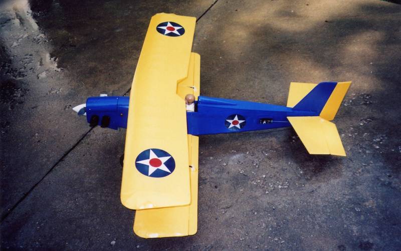

Old 10-26-2006 | 02:01 PM
Posts: 488
From: Jacksonville, IL
Default RE: Balsa USA Phaeton ll kit
Well, I finally finished my (somewhat kit-bashed) Phaeton II witn a Saito 80.
