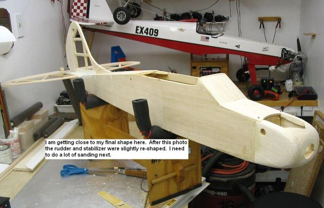

JLNewc has the correct idea. I have done this on all my planes. This photo is control surfaces from an LT 40 I crashed last June. It is getting an "ARF bashing"
All my control surfaces done this way can get close to 0 gap....... But......... then they won't move correctly most times. I flex them to the throw I want before the glue sets. The gap opens up ohhhh so slightly, and this will now be very sufficient for most all applications. .........lownslo
PS. The other photo is my LT 40 in the works.
All my control surfaces done this way can get close to 0 gap....... But......... then they won't move correctly most times. I flex them to the throw I want before the glue sets. The gap opens up ohhhh so slightly, and this will now be very sufficient for most all applications. .........lownsloPS. The other photo is my LT 40 in the works.
