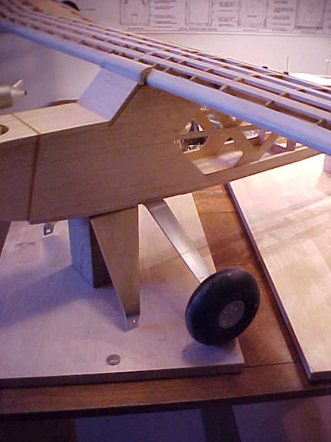

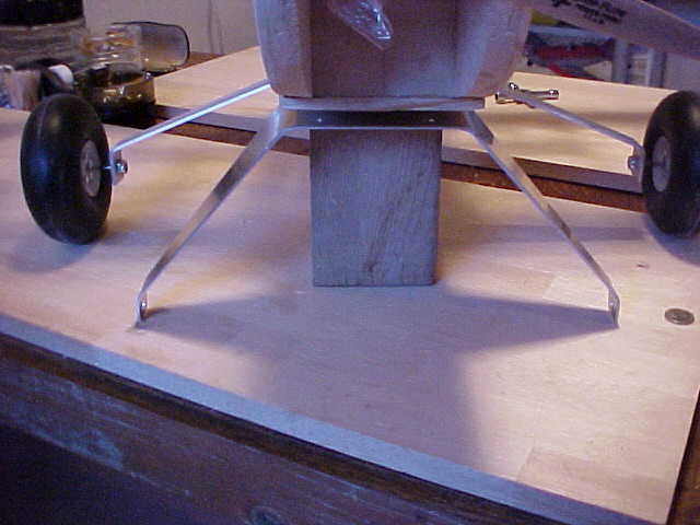

Forgot include the following pics to add to the explanation re the landing gear and tail modifications.............

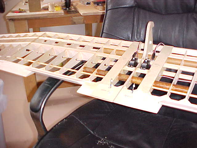

In the midst of installing controls, it's time to set up the flaps. I've never built nor flown a plane with flaps! Each half of this wing will have a servo and torque rod linkage to a 20 inch flap in the center flat section of the polyhedral wing. The ailerons, also about 20 inches long are in the outboard dihedral section. My question is what should the set up maximum delfection be? My guess would be 30 to 45 degrees???? But I really don't have a clue. This picture might help............. Your thoughts, Please?

ORIGINAL: bluebikerblan
My question is what should the set up maximum delfection be? My guess would be 30 to 45 degrees???? But I really don't have a clue...... Your thoughts, Please?

ORIGINAL: 2lazy2p
My 2 cents.... 45 degrees BUT.... You are really plowing new ground I think. 40 inchs of flap is a BIG flap. Ease them down in increments at first and be ready to increase power and give it alot of down elevator. Flaps down and the drag goes up & the nose goes up. Full flaps, lots of power and you can drag it in at about 2 MPH. With the ailerons you have you should have good control. But then again thats the new ground I was talking about. Just my 2 cents......... Richard

So.............as I was wondering would 45 degrees deflection on my 10 INCH FLAPS per the attached very recent picture be about right?
Sarcasm aside, I appreciate the alarm re the oversized flaps. Your concern caused me to do a search, ask some questions and seek some advice and get some more experienced opinions. One response went something like this......"You're putting what on your Senior Telemaster?" Flaps. "Flaps!" Yes, Flaps. "What's the matter with you Blue? A Senior Telemaster IS a flying flap!"
More indulgent advice suggested that I was intending at least twice too much flap. Thanks very much for drawing my attention to the excess.

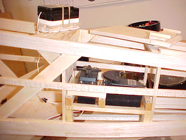

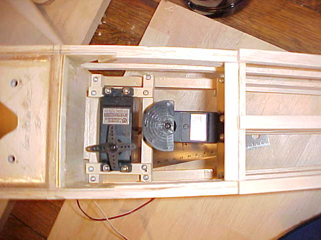

Here are a few pictures of the servo bay, rails and servos built in the bay just aft of the main cabin to leave the cabin area clear for utilization of various service modules I have in mind. Cameras, Glider Tow, Candy Drop Bin etc. The servos are high torque for a pull-pull rudder (linked to steerable tail wheel) and a semi-flexible giant scale push rod for the elevator.

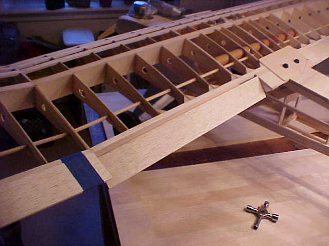

I haven't ordered my Senior Telemaster kit yet. But I've been reading and reading.
I really really like you polyhedral wing. And I was wondering about your flap and aileron. Did you use the stock aileron material for the flaps and ailerons? (Meaning they're not deeper front-to-back).
Second, how did the flap usage turn out. One post suggested the flaps were possibly too big.
I want to do the same polyhedral wing as you have done. Possibly making the bend a bay or two closer inboard. This would make the flaps smaller, and the ailerons bigger.
Do you have some construction photos of just the wings? I'd really like to see photos of just one side. Get better detail of just the left or the right wing.

Hi............I think I posted almost every relevant photo of the highly modified Senior Telemaster I built. Do a thorough look see and you'll note among other things that as a result of suggestions that the flaps were cut in half. From 20" to 10". Turned out to be more than enough.
Experience.........putting flaps on a Senior Telemaster is fun and entertaining but really not needed and adds the weight of 2 big servos.
If you add flaps, you can make them any size you want. If you look closely you'll see posted photos of both the 20" and 10" versions.
Opinion: Doing it again I wouldn't add flaps and would rather build more to save cost, weight and time. The two piece polyhedral wing however was/is a winner. Super strong and very, very stable. Trims out beautifully for hands off giant circle climbs at about half throttle.
I did NOT use the trialing edge stock supplied with the kit to make either the flaps or the ailerons but rather purchased a denser 1 1/2" TE stock.
I wanted to have about equal aileron control surface area with about 1/2 the length. Worked very well and I would repeat the design.

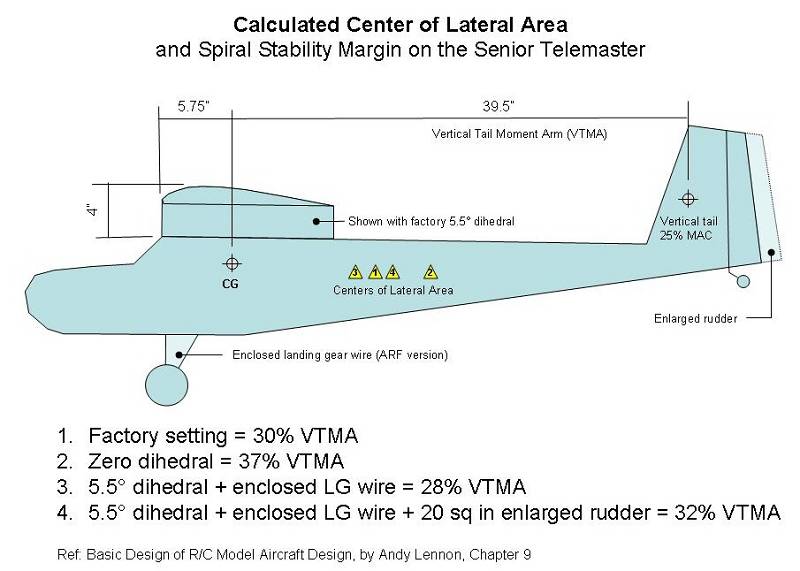

#48
Okay -- I followed Lennon's procedure to calculate the lateral (spiral) stability of a model design. I was skeptical, because it sounded so low-tech ... but it appears to work. You find the "center of lateral area" (CLA) of a model using a 100% profile that is suspended from 2 or 3 different points, and run a plumb line down the length of the model each time. Where the lines intersect is the CLA. See Chapter 9 of 'Basics of R/C Model Aircraft Design' for the procedure.
What I found for the Sr Telemaster (ARF) suggested that reducing dihedral and/or adding to the vertical tail area quickly increased spiral instability. One of the posters on the mod thread complained that his plane was hard to get out of a flat spin ... dunno if these conditions are related.
Lennon says you have "neutral spiral stability" when the CLA is at 28% of the vertical tail moment arm (see diagram). My test suggests the factory Telemaster's CLA is nearly 30% of VTMA ... making it mildly susceptible to entering a spiral. When I took out dihedral (as a number of folks have done) on the mock-up, the spiral stability margin increased dramatically - to 37% ... well into the "very spirally unstable" zone in Lennon's estimation.
My intended mods include filling in the space between the LG wires (like a Cub), which improves the CLA location; and adding about 20 sq.in. to the rudder, which degrades it. I'm looking at a spiral stability margin of 32% ... still in the "mild" zone ... and I'll leave the dihedral alone.
Having gone through this exercise ... I wouldn't take these numbers to the bank, but the principle is what's important: if you move the CLA too far aft (even with the model balanced), there may be unintended consequences.
PJ
