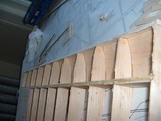

Disaster
I ended up in the midst of a disaster chain that I'm just now ready to work out of, it was bleak enough that I ordered an LT-25 kit because I was pretty frustrated. I ended up damaging the lower leading edge of every rib on the left wing.
I was working too fast, I was getting to the point where the big chunks in the box had started to be reduced to toothpicks and scrap, and my work area was really cluttered. Things were going really well. I had run to the LHS to pick up the sheeting that should have carried me through the build. I sheeted the stab, the top and bottom TE of both wings, and then the rest of the top of the left. I realized I was out of sheeting again. I was really hoping to finish the left wing, and thought that I had enough sheeting to do the LE of the bottom. I glued together a 2" strip to a 1" strip and checked it twice, I don't know how I missed it, I was probably just working too fast and was seeing what I wanted to see because when I glued that sucker down (with CA, working fast) it was about 1/8" short.
Now that's bad, but not catastrophic, I could have added that 1/8" and trimmed. But instead I removed teh sheet and yanked a 1/16 to an 1/8 from each rib. I was frustrated and angry and really didn't want to go to the store for another $20 collection of wood and doohickeys for the plane.
Anyways I'm over that and trying to figure out how to salvage the wing. The way I see it I've got three options:
1) New wing.
2) Cut a bunch of slivers of balsa that fit from the spar to the LE. Remove balsa from each rib and replace.
3) Use those same little widgets alongside of each broken rib(no removal) and just add some weight to the right wing.
What are my options?

So I decided that a series of balsa widgets that match the airfoil, glued to the broken ribs was the way to go. So I made a pattern, cut the widgets, and here's where I'm at.
