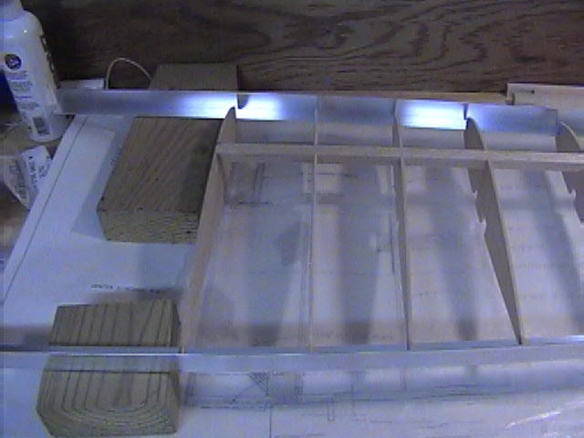

Default eazy to build jig
I just built a jig for my chaos wing it is easy and quick. use 1/16 3/4 angle and old scrap 2x4s used a 2x2 stock to keep every thing plumb squar and level.
