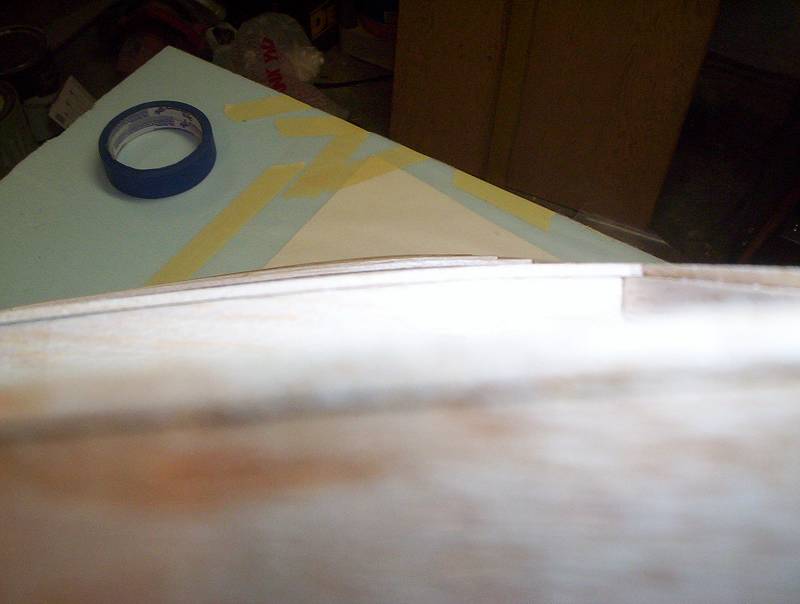

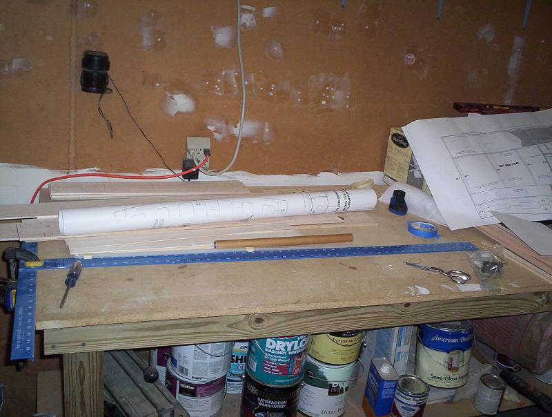

The first picture is where I will do most of my building. Its two saw horses with 2 pieces of perfectly flat 3/4" plywood on top. Ontop of that is 1/2" styrofoam insulation for pinning to.
Second picture is the box, obviously
Third picture is my workbench right next to my workspace, this wasn't flat enough for me, off about 1/16" of an inch in the middle from the sides so I will be using it as parts staging.
Forth picture is the radio I bought. Futaba 7CAP with 4 servos, reciever, charger, etc
Well its off to start building, and please help me out with tips and suggestions ... I'll need em!

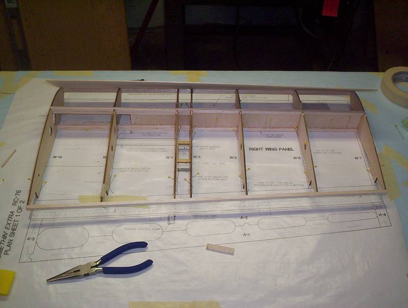

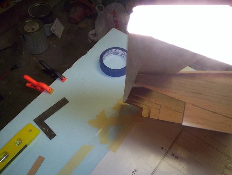

Well my digital camera batteries died, I'll head to the store later today (can't believe its almost 2am, I should put a clock in the shop).
I took my time, I got one wing basically ready to go. Between the baby daughter and the wife, I didn't actually get too much time put in on this until after 11pm.

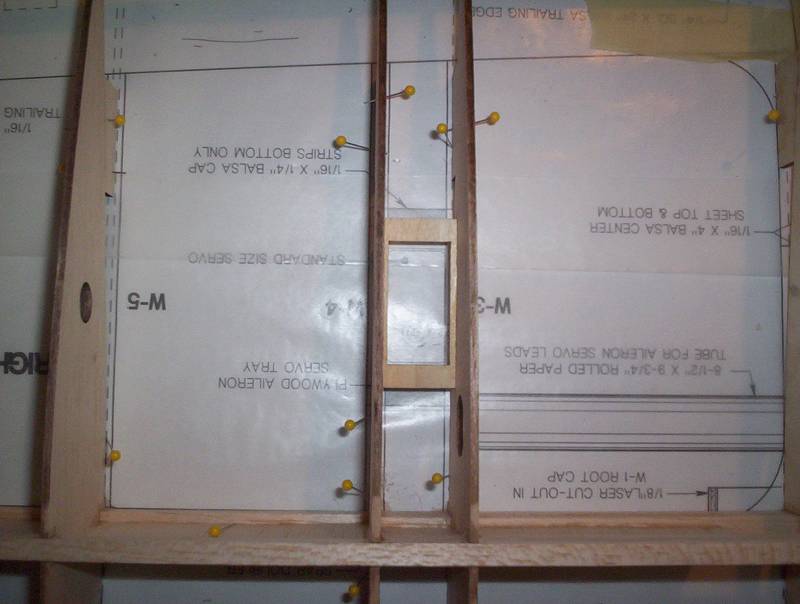

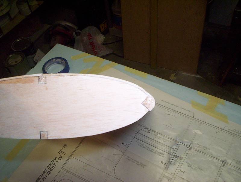

Well I feel like I was just kicked in the face...... okay maybe thats a little over dramatic .. but...
The wife was getting something out of the shop area in the garage (in a rubbermade tote), and when she lifted it over the workspace she dropped it on my wing. It weighs about 40 lbs or so, and everything is crushed and broken. And when I say everything, I mean it looks like it hit the ground at 90mph.
I'm still in shock sort of. My next question is this, is there any place that sells replacement parts for these airplanes? or am I stuck buying a new kit?
I'm going to keep building this kit (less 1 wing), and if nothing else, head to the LHS to get another entire kit (hey, everyone needs spare parts right?)

You could scratch build a new wing. You have the outlines of the ribs, size of the leading edge stock, and the outline of the aileron. I rebuilt an aileron out of 1/4" stock for mine after a midair with another SE. It didn't take long.
Think about putting some paper over the plans to trace out the rib profiles so that you can can cut your own out of balsa stock. You could make yourself a new leading edge and sand it to shape in no time. Ditto for the trailing edge pieces. The spars are easy. If you saved the balsa sheet the ribs came out of you could just lay that on a new sheet of balsa and draw your outlines directly.
You can probably pick up the balsa at your hobby shop or order it from somewhere like BalsaUSA. I scratch built a whole wing with a buddy when my second plane hit hard. We did it together in about 4 hours and it was a complicated wing with plans not as good as the SE.
Also, you have the other wing half to look at as you build your new one....if you decide to build it this way.

If I had my Dad's scroll saw I would be all over building it from scratch, as it is now It would take me forever to cut it out with the little razor saw and stuff. My time is worth more then that in this case .... I guess I'll go ahead and head to the LHS after work and see if they have the wing kit.
My wife is now banned from the shop btw. But she did feel bad, she cleaned up the old wing (removed all the pins, etc) and put down new wax paper for me. She then went to WalMart and got me the batteries I needed for the camera!

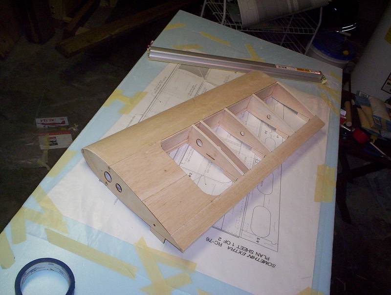

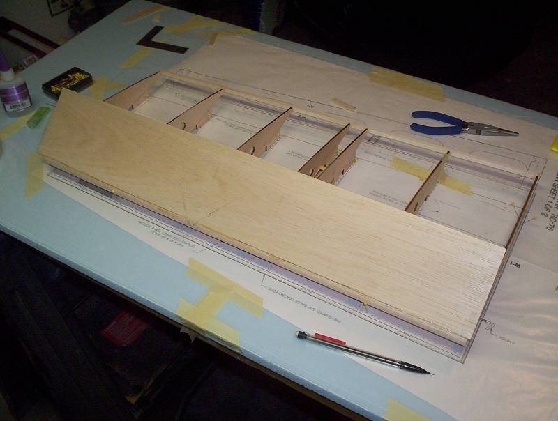

So here is the wing I worked on tonight.
I waiting to pull the sheeting down, I need to go get some CA accelerator, I struggled with this on my other wing, makeing sure that leading edge was rock solid.

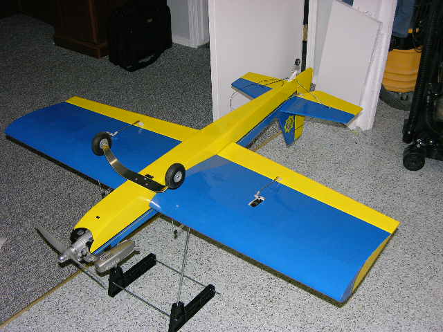

KCR, sorry to hear about your wing. I just finished a SSE and I really enjoyed the build, and had no problems whatsoever. I am going to maiden it tomorrow. Here's some pictures of mine. Enjoy the build!
Joined: Jan 2006
Posts: 126
From: Billings,
MT
Whoa, I don't know why these pictures came out that way, and I apologize to everyone reading this thread. I did'nt mean to make a mess of things.
KCremoteflyer, Before I started my SSE, I traced all of the parts on paper first (just in case). I can send you copies if that helps. Also I was going to suggest that you have you dad design the covering scheme for you. Just a thought.
Msouth12-That's one huge SSE!

I wonder how I would do the cirlces in the middle for the female tube and the paper tube?
I guess I could cut them just close to the line and then sand like there was no end. The straight up balso pieces wouldnt be too bad
but the plywood parts would be difficult.
KCRemoteFlyer
You can just order the individual laser cut sheets from SIG. When my canopy flew off mid air (due to not fastening it), I couldn't find it and oredred two sheets from SIG where the canopy parts were located. I think that cost me $12 or so.
Just locate the sheets you need, call them and you will have them in about a week.
-tychoc

Okay, I have some more images for you guys, and I have a question, first off the first 4 pictures.
I got the entire top part of the wing done, just need to do the sheeting on the bottom side now.
The first 4 pictures are of that progress.
The last picture is my question, thats the trailing edge obviously. The problem is that right in the middle, it has a little sag (which you can see), and the a little ridge to it after that. What can I do to correct this? or is this not a 'major' problem? It drives me nuts because its not perfect.
Other then that, I know I'm going slow, but how does it look?
