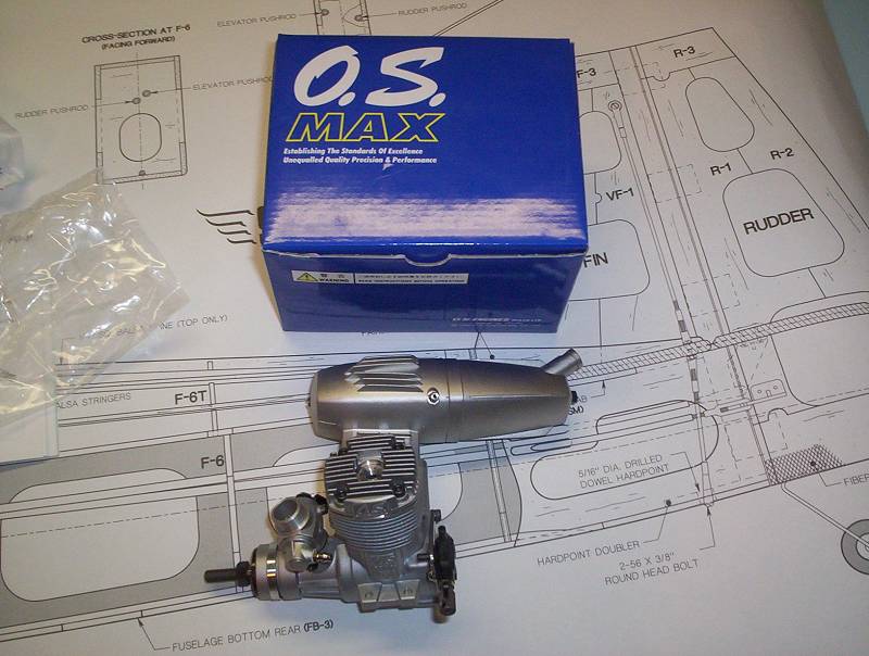

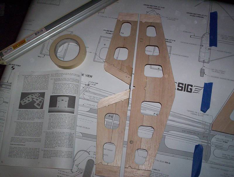

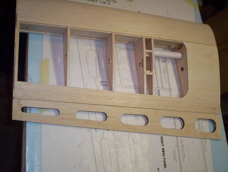

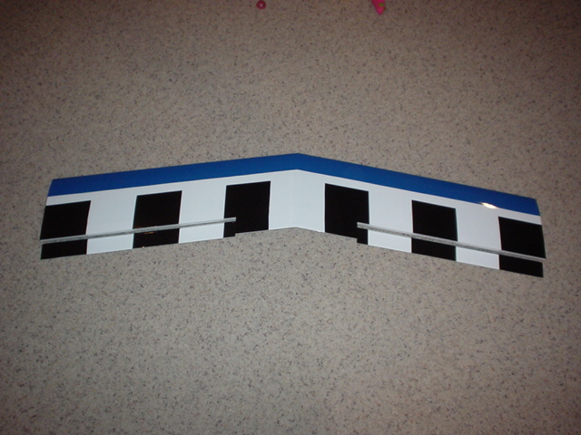

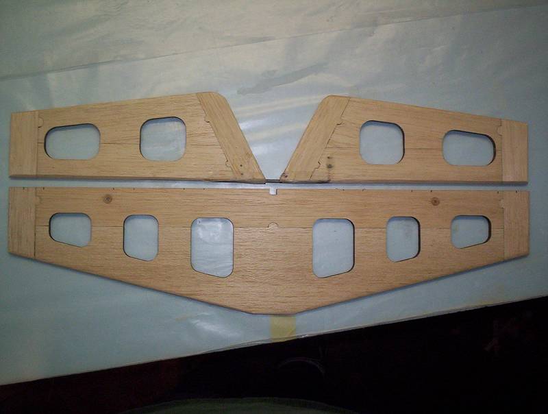

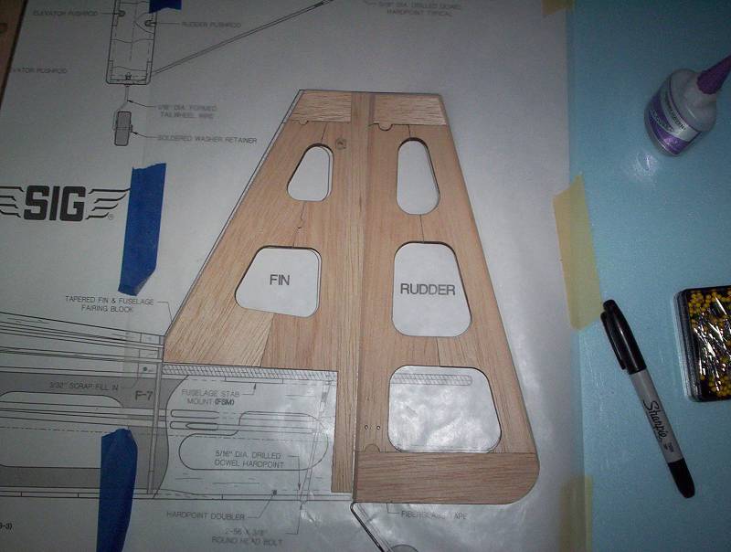

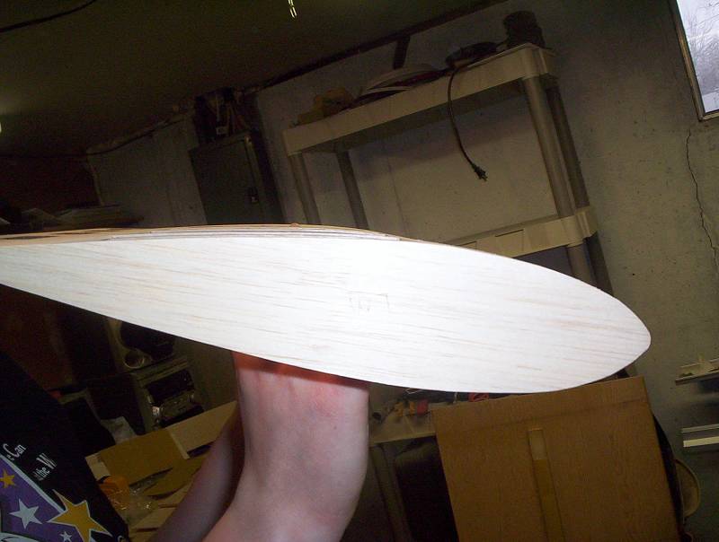

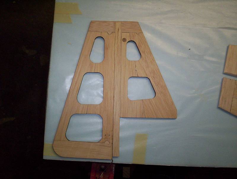

Okay, as promised here's the picture update.
First picture is the completed wing with aileron temporarily in place
Second picture is the wife holding the wing at a slight angle so I can get a good picture of how straight the wing is
3 and 4 are the tail group
5 is the engine (OS 46AX)
What do you all think? I know I'm goin slow .. but looking good? Comments/Concerns/Tips/ etc?

KCRemoteFlyer,
Everything looks great from what I can see! Keep at it(at your own pace of coarse). Before you know it, you'll be at the field ready to maiden. Ben

Nothing looks amiss to me. I sanded mine with a 40 grit block and it still look spretty. I also left the edges square to make covering easier. They look better rounded, it's just more work. I'm gonna fly this plane very low and slow, so I didn't waste any time on cosmetics.

You are doing great! You may have already done this - harden the control horn mounting points with CA. I don't remember if that was in the instructions.

Yeah, they want a piece of nylon c/a'd where the horns go. Another way to do it is to perforate the area with a t pin, both sides, then soak it in thin c/a. Either way works, or you can do both.

Yes, the hardening was in the instructions, I wanted to get the bulk of the sanding done before I had to deal with the nylon/ca spot. I've sanded most of it with 150 Grit, going to do a 400 grit and then 600 grit final sanding.
Thanks for the compliments!!
I ordered my replacement wing kit today direct from sig (was gunna get the from the LHS, but it wouldnt get here til Monday) Sig can have it here no later then Thursday. But since they are only 3 hours away from where I live, I would expect to have it Wednesday.
I hope, April 4 I'm going to attend one of the local beginers nights, and I hope to have my uncovered plane finished so I can have them give it the ol' once over before I cover it. The guy I talked to also said that if its a light night with beginers, I could take up the club trainer, that would be real nice!!

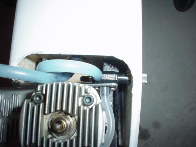

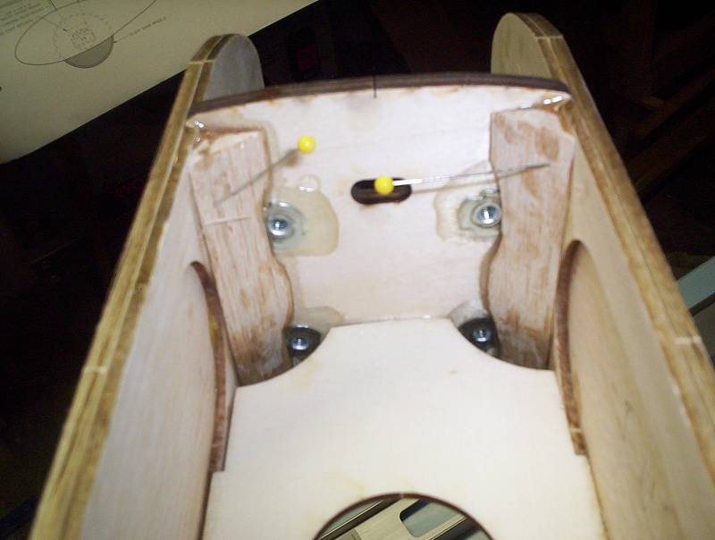

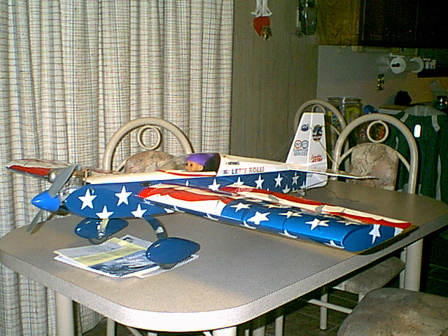

Okay I have a question.
Im lining up my motor on the motor mounts, ontop of the plans. For me to get my motor to line up, It would be touching the back of the firewall, is that bad or should i move it forward?
Also when its touching the back, its lifted ''slightly'' by the needle valve, I would assume that wont work at all.
Any thoughts?

You definitely do NOT want it touching the firewall. Either move it forward a tad or relocate the needle valve if it is externally mounted. FOr that matter, tou could even mount the needle assembly to the firewall.

Did you see where it shows cutting away the area where the needle goes? I know it shows to clear for the muffler. On mine, I cleared a little for the needle too. The engine is a little bit forward in the mounts. About 1/4 inch from all the way back.

I put the OS 46 in mine & had the same issue. here's what I did. I cut a hole in the side of the fuse so I could turn the needle sideways because it got the screws out of the way & let it slide back to where it was about 1/8" off of the motor mount back.
It still makes the motor stick out a little more than the plans but it doesn't seem to bother mine & you'll also find that you need to add some nose weight if you use the 2-56 wires & the tail feather support wires. ( I had to add 3 oz. in the nose). I also had to shove my battery pack all the way under the fuel tank against the firewall so make sure you have enough room under there.
I took a couple pictures for you.
BTW, everythings looking good so far!!

Guys, thanks for the advice!!!! Definitely put it to good use. I ended up turning my needle vertical, and then moved the engine 1/4" forward as suggested and that works out.
I am glad to hear that you still need to add front weight, I was concerned about being front heavy having to move the motor forward.

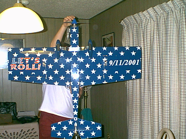

OKay as promised here are the pictures. I'm at a stopping point now, waiting for my wing-kit to arrive, Wednesday or Thursday at the latest.
Thanks all for the good advice and comments, its really appreciated!!!
Now its time to start thinking about a covering scheme. I saw an American Flag waving in the breeze look that I really liked. Is that going to be a bit too much for a beginner? Should I look to do something simpler?

Don't be scared by Termigator's covering thread. It's actually easier than it looks. Once you get going it's not bad at all to do a flag covering.
Ken

Ken, wow nice .. was that a tribute to 9/11? Looks great.
I really like the look, I suppose if I take my time I'll be able to do it, just looks soo nice!
