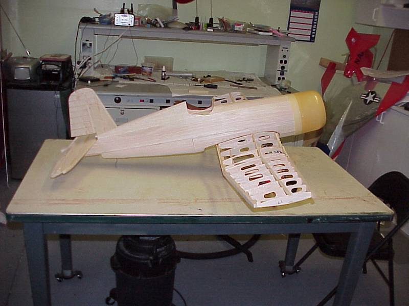

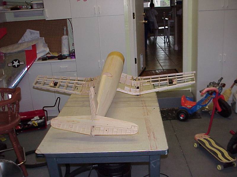

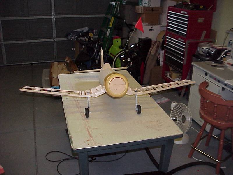

Well, I finally decided to work on my corsair. It will have a saito 100 in it with a slimline pits muffler. I already have said engine and muffler NIB. I also have digital servos to put in it also. I have already installed the robart retracts and robo struts. I started this kit in 1995 and should complete it this year. (Can't wait) I have not decided on color scheme yet.
It will be glassed and have flaps. Always wanted one of these.

Is that the 1/8 scale one or the giant scale? If it is the 1/8, I'm not sure how you could fiberglass it with the open bays.
Old 04-03-2006 | 11:37 AM
Posts: 296
From: Meridian, ID
Default RE: TF Corsair
The wing still needs to be sheeted. I am just posting pictures of my progress. Still got a long way to go. It is the 1/8 scale.

Old 04-03-2006 | 02:36 PM
Posts: 296
From: Meridian, ID
Looking good Kelsey_B. I am going to use super shrink coverite on tail surfaces and paint them to match the rest of the airplane. I want that fabric look like the real ones have.
Kelsey_B did you use seperate aileron sevos? If so how did you mount them? Got some sheeting done on the wing last night.

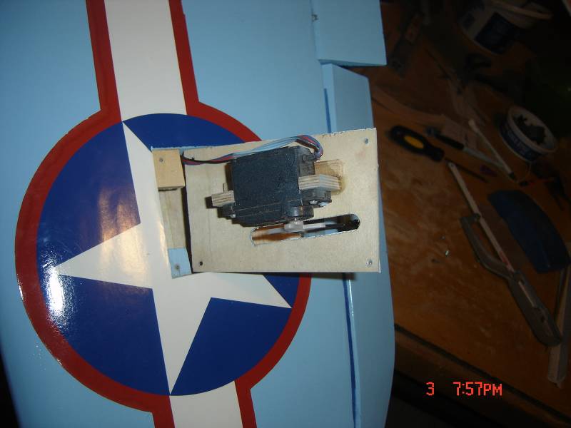

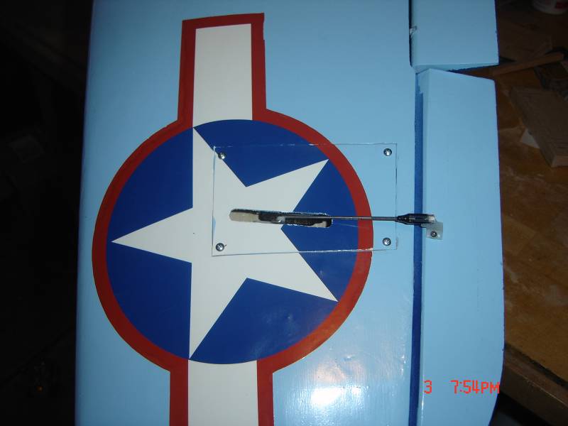

Old 04-04-2006 | 07:33 AM
Joined: May 2004
Posts: 427
From: West, TX
The servos are pretty easy. You epoxy 1/4" ply rails to a ply hatch. I used 1/16 ply because I had some. I would probably try to use something a little thinner next time. Here is what mine looks like. I'm sure there are cleaner ways to attach the hatch.
Why are you uisng digital servos? These seem awfully expensive for a 60 size plane.
