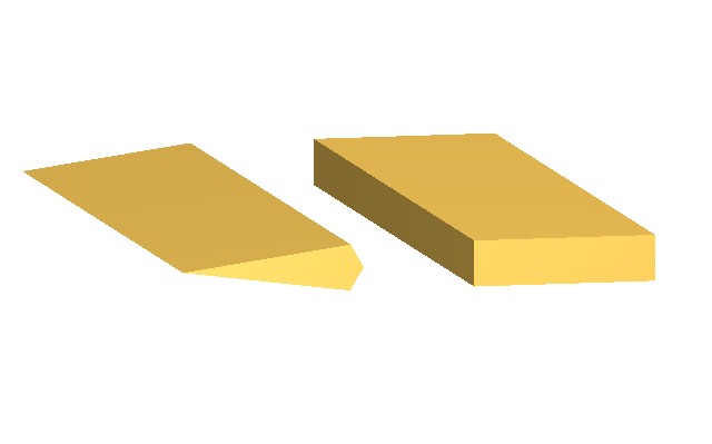

Can anyone advise the best way to form the elevator profile (as shown) from a solid rectangular piece of balsa.
Many thanks

Draw center lines on the leading and trailing edge. Stick 80 grit, or lower, sand paper to your favorite block and start sanding. I've tried using a small plane and it's much more work than just sanding it to shape.
If you are real careful not to get your fingers in the way, a bench mounted belt sander will work for the first major bit of grinding.

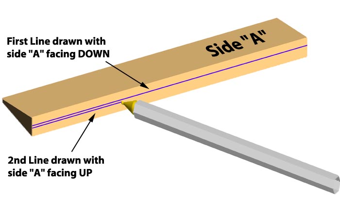

Lay the control surface on your building board, or other flat surface. Lay a pen next to it. If the pen doesn't come to the approximate center, put some flat scraps under it until it does. (Note: it does NOT have to come to the exact center, just close)
Now, keeping both pen, and control surface flat against the table, draw a line. Then, flip the control surface over and repeat.
The end result is two lines with a gap in the middle. the gap is your "Centerline".
Now, holding the control surface along the edge of the table, sand LENGTHWISE along the edge while holding the sanding block at the angle you want. Sand down to the top-most line of the two while constantly checking that you aren't sanding too much (or not enough) in any particular area.
This sounds a lot more complicated than it really is. But I have yet to try any gizmo that does it quicker, easier, and better.

Sorry couldn't resist. I have a small tool that scribes the center line on the surface for you I believe it was made/sold by carl goldberg as part of their hinge sloting kit. You place on the surface and twist it so the two tabs on the ends touch the top and bottom of the surface then apply some pressure and run it along the surface and the center line is scribed takes about 2 seconds.

I know the tool you mean. Goldberg supplies them with most of their kits. I have about 10 of them floating around my basement, I am always tripping over them, but of course, I can never find one when I need one! That's why I just use the pen method. LOL

Your original question was about shaping from a rectangular block. You could get triangular strips of different dimensions from your LHS and use the technique described by Minnflyer. You could also use the GP multi sander to sand out the bevels. Very easy to use and accurate. But if you already have the rectangular block, you could still sand out to the triangle dimensions you need using a sanding bar (just make sure it is longer than your wood), and then bevel it. Just more work and a lot more balsa dust in your lungs.........

This is really no big deal. Just draw your centerline(s), hold your sanding block at an angle, and run it along the edge until you reach the line. Then, flip it over and do the other side. We're only talking 1/4" balsa fer cryin' out loud. That's only 1/8" on each side! It doesnt even matter if they're tapered or not, you're just sanding a little bevel!
