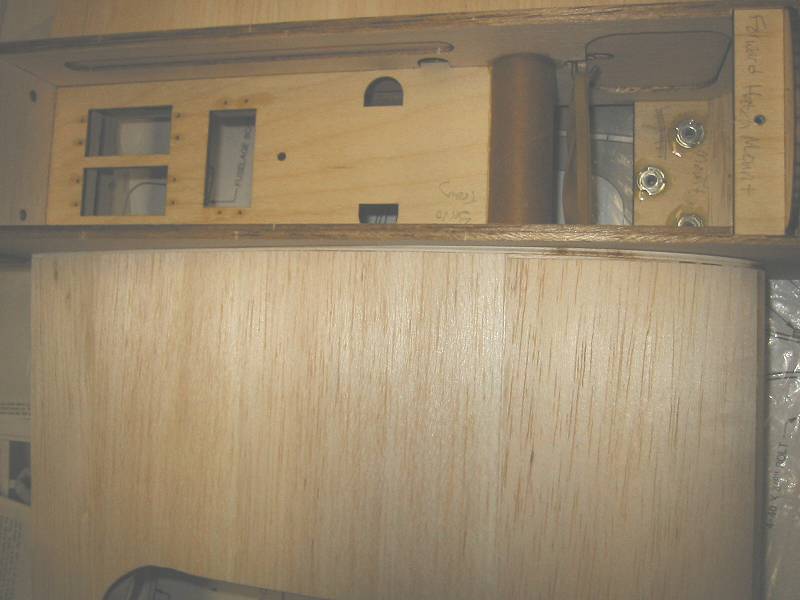

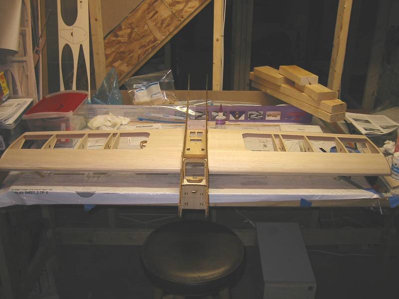

Okay guys, I have been following all these SSE builds for several months while I built my own SSE. I have certainly learned a great deal from RCU which has save me countless errors I can assure you!
I have now reached a somewhat major milestone in my SSE build (pic #1) - I now have something that actually resembles a plane! This thing may fly after all!

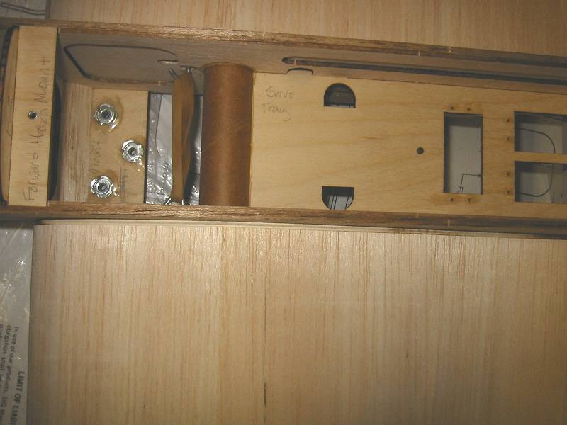

Anyway, when fitting the wings to the fuselage my elation quickly faded as I discovered a gap between the fuselage side and the wing root. Not all the way down the root, however. This is true for both the top and bottom of each wing. I have some pics that hopefully describe:

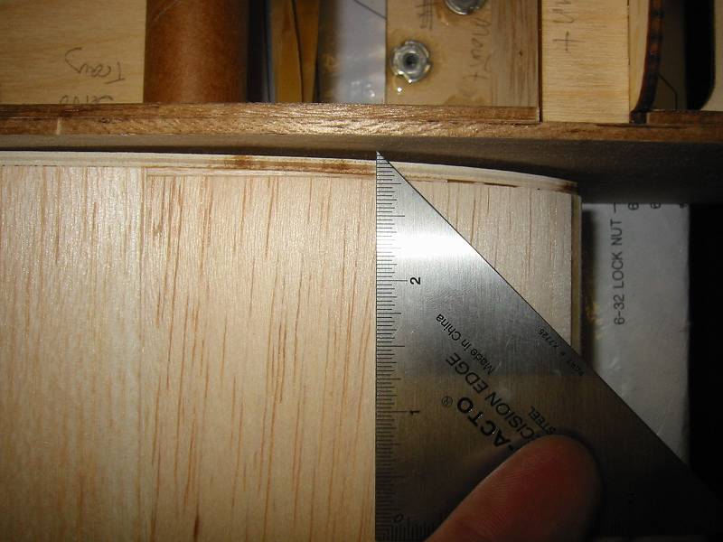

Picture2 - Top Right Wing. Flush with fuse for about 1/2 the length, then it pulls out at the leading edge.
Picture3 - Scale reference. Looks like 1/16" gap.

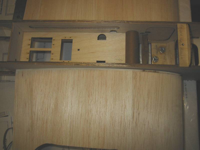

Picture4 - Bottom Right Wing. Not nearly as flush as the top portion of the wing.

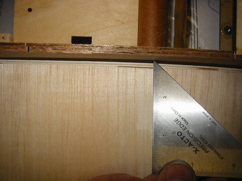

Picture5 - Scale Reference. Again the gap is approx 1/16".
So, how bad is this?
How should I proceed? Should I try and sand down the "high side" and try to get the wing to go flush?
I worry about changing the aerodynamic portion of the wing/fuse relationship and fear the "fix" might be worse than what I perceive to be the problem ... know what I mean?
Thanks for the help!!
-Alex

Take a deep breath, it's not as bad as it looks. I had a similar problem on one of the SSE's that I've built. The first part of the problem was the wing tube (the metal one) was just a bit too long. It didn't allow the wing halves to fit down flush on the side of the fuselage. So check that first. If needed just file a little bit off the end of the metal tube.
After you've checked that now see how the wing halves butt up against the side of the fuselage. You may need to do a little bit of sanding on the root rib to get it to fit flush. The reference point that you'll need to pay attention to is that the leading edge sits at a 90° angle to the side of the fuselage. So sand down the root rib a little bit so that it sits flush up against the side of the fuselage.
Hope this helps
Ken

Hi!
Either sand down the high side or build up the low side...!
That easy! Will not change anything aerodynamically.
Regards!

I had the exact same issue on mine & I sanded the high side down until it sat flush. Also, as Ken said check your wing tube to make sure it's not too long. Just put one wing on at a time & see if it sits flush

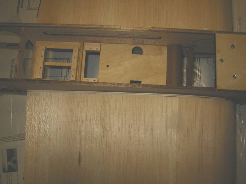

Had a multitude of issues. Ken, right on; the wing tube was a bit too long. Gotta love the Dremel. Once that was solved, the wing roots still needed a bit of sanding, but as you can see, it is much better now.
Picture1 - Left Wing
Picture2 - Right Wing
This type of sharing is what makes RCU so great! Thanks again.
-Alex
