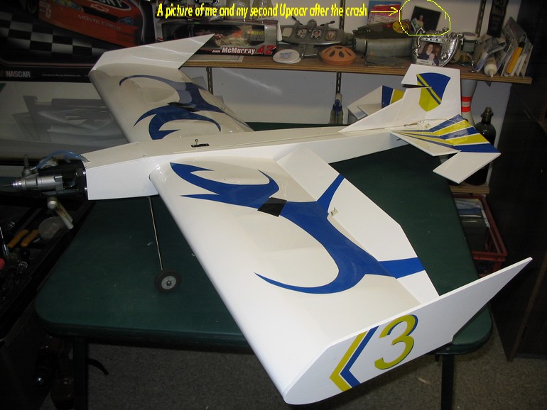

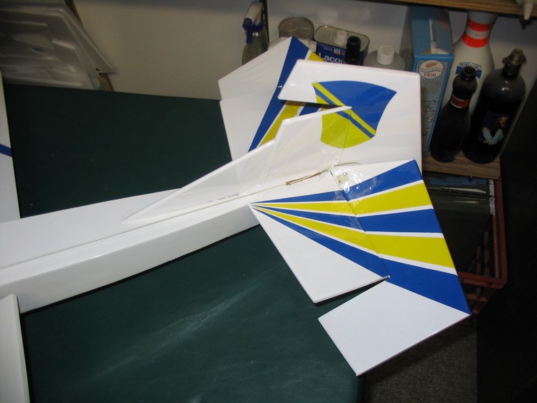

Here's some pics. I modified the ailerons so there is more air over them. I put a dorsal fin on it because the tail seemed to be to washy for my liking. I put counter balances on the elevator and rudder and squared them up. To much elevator makes it high speed stall and spin, so be careful with the throw, it recovers as soon as you let go of the stick, though. I also put gates on the wing tips. The thought here was too give it better knife edge capability but that will never happen. I could not get it to knife edge without and exteme coupling problem, however it did give the plane more stability and one wickedly flat inverted spin, almost climbing at full throttle! It wouldn't do a good blender but if you stand the plane on end and shove both sticks to the right or left it would lock in to the coolest flat spin ever. I love this plane and will always have one in my hangar, it's also great on water with .20 size floats.

Those are some cool mods there, I have a Dazzler ARF (Hobbico version of the Uproar) that was crashed on maiden by another club member so I offered to fix it for him (A real nice elder man in my club) Well anyhow I fixed it and covered the repaires with some covering I had left from other projects and when I met him at the field with it he then told me to put some gear and an engine in it and it was payment for fixing it for him, He said it was too much for his old hands to handle so I put a old OS 46FX on it and the 46 is borderline too much power on it, I use a 12x4 and vertical is nonstop.
Dauntae

Flies great with the APC 10X3! Wish I had found this prop sooner. Now I find I need to modify the vertical fin and/or rudder. Not sure whether to just increase the rudder size both in height and length and adding a counterbalance (easiest fix) or trim down the fin a bit, keep the rudder the same height adding a counterbalance and length.
Guess I need to see what others did with theirs. Definitely need more rudder tho!

Counter balances will do wonders for the authority. Moving the balance point back helps also. Don't count on it doing knife edge, all of mine wouldn't!
