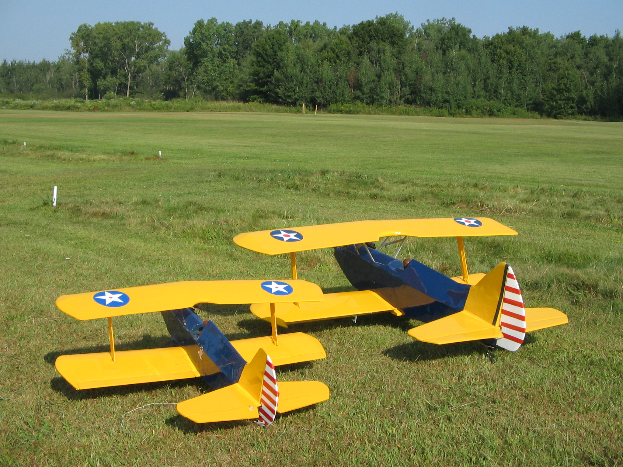

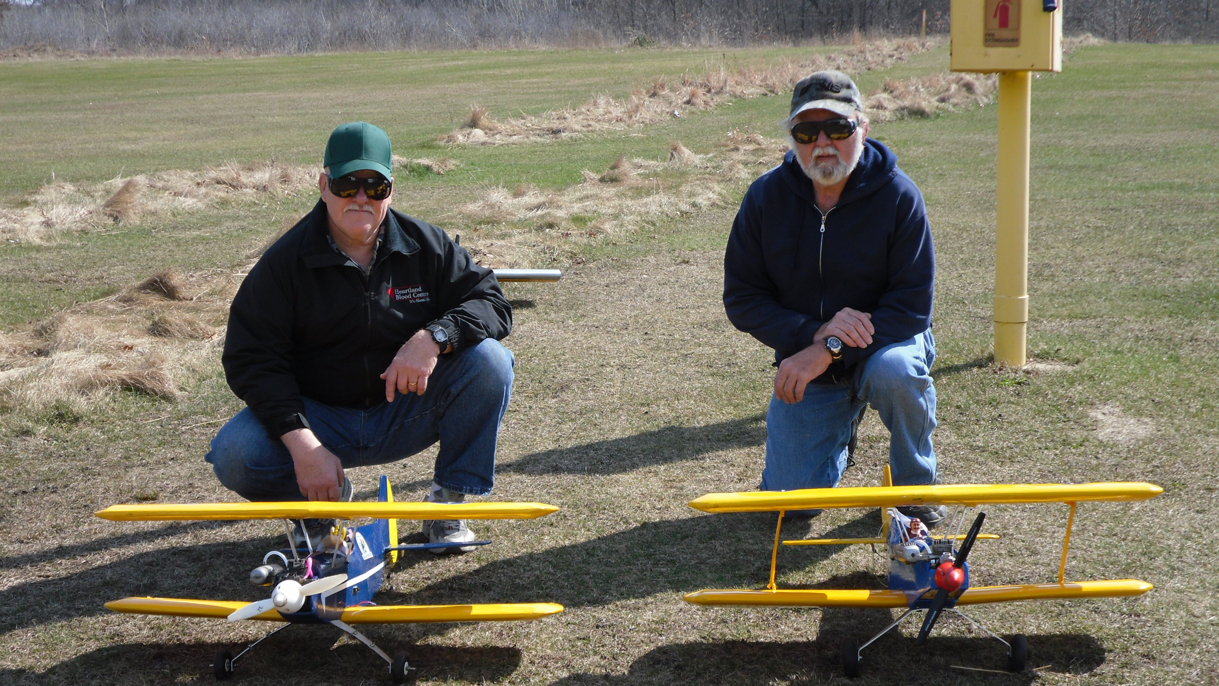

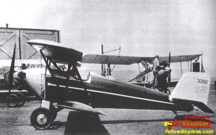

i agree.i love the plane.i fly a .46ax in mine.over powerd.but man does she do some tricks.some yrs ago i increasesd the plans by 50%,and the model lost all its arobatic properties.my friens flys his with an os 40,and it seems more than enough power.our club field is very bumpy,and she will nose over,but i try to land it on the smooth spots.a big mistake some guys make is having the ail. set too high.she can get out of control fast.i yhought this tread was dead,it was nice seeing someone else likes the dreamer.i did a search on the net to see if there was an actual dreamer bipe,and i found one.i will see if i can find the pic and post it here

here are some pics

With a few measurements it wouldn't be a difficult plane to scratch build. The only thing I don't like about copying bipes from photos is you never know what the wing incidence is supposed to be and until you get that right a bipe can sometimes spend the entire flight a half second from being re-kitted.

ok incidense is easy on the dreamer.bott wing zero,top wing about -1 deg.

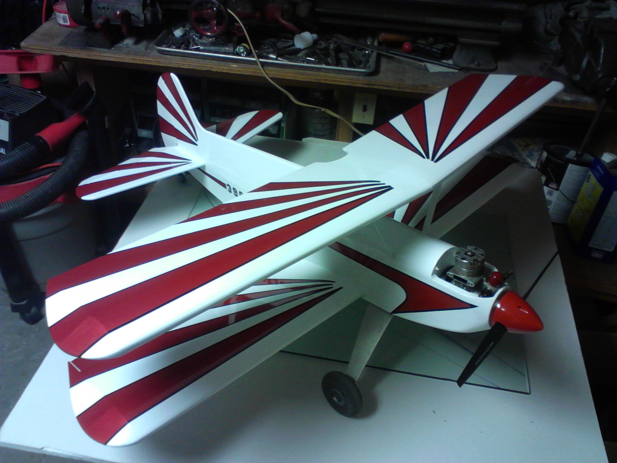

I have built 2,I love the way it fly's The first one twenty years ago from kit bought from tower hobbies, II just finished scratch building the second one with mods (no rubber bands holding one the wing) and it fly's great.

looks good.i am a dreamer lover too.i have scratch built several for myself,and other club members,and they love the plane too.i too have gotten rid of the rubber bands.also used 1/8"flat aluminum for cabanes.no need for wing struts.have fun with her

I milled mine out of .080 sheet of aluminum. made the maiden flight Friday evening she flew great.
tried flying last sunday but had engine problems out of an old os 46 sf that I had replaced with a new 46axll runs and fly's nice
