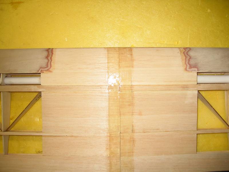

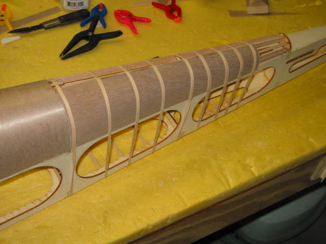

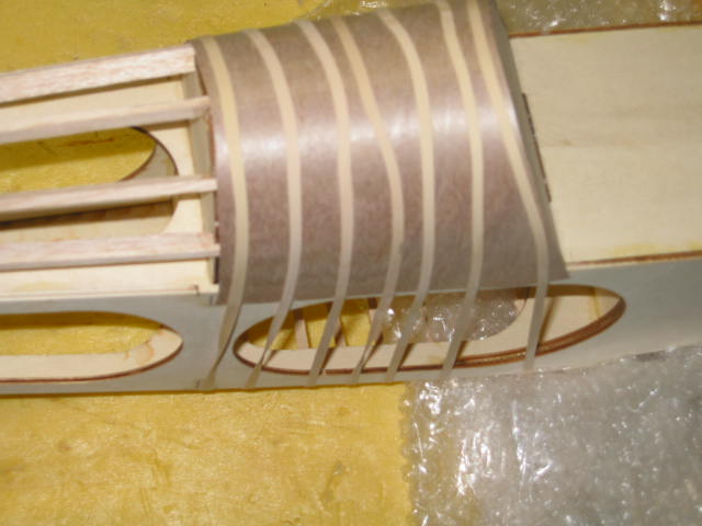

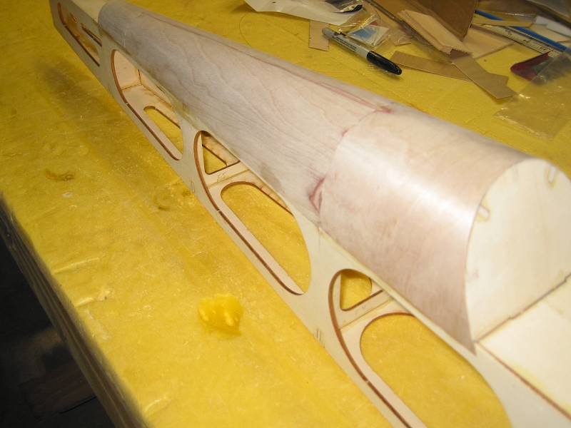

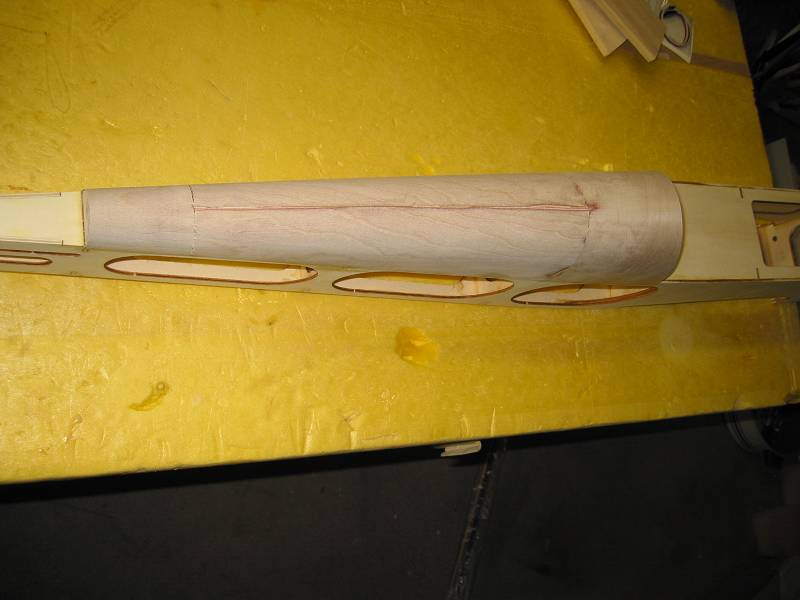

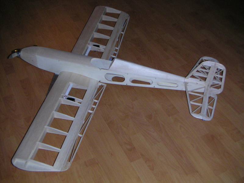

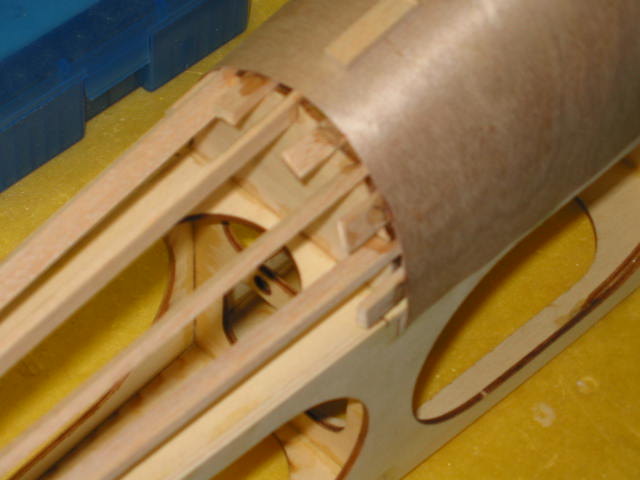

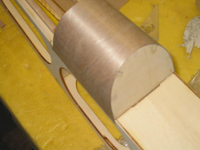

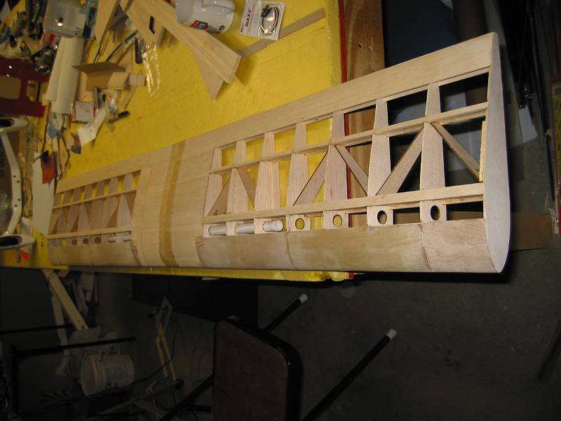

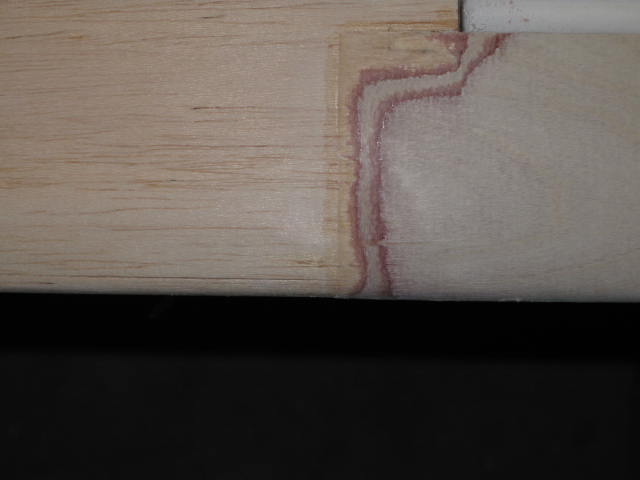

For those interested I thought I would post some pictures of my 4* 60 on the sheeting job.

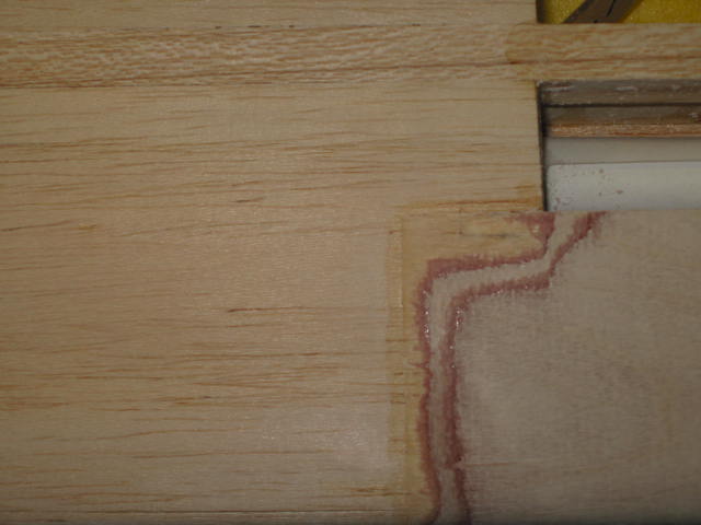

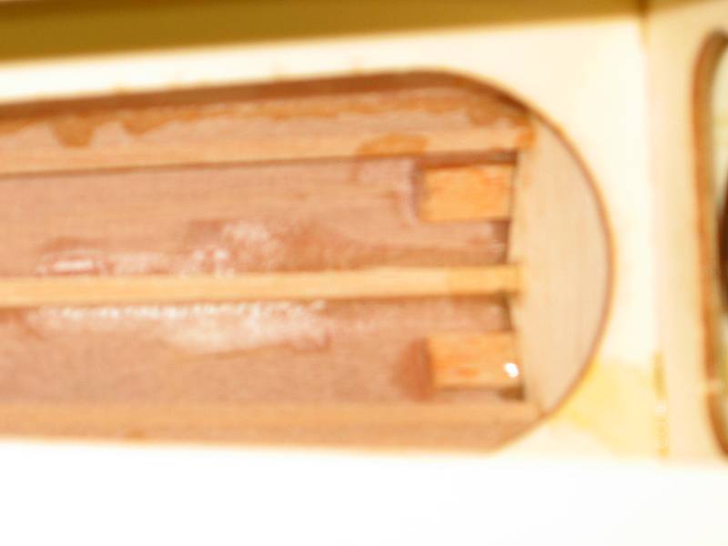

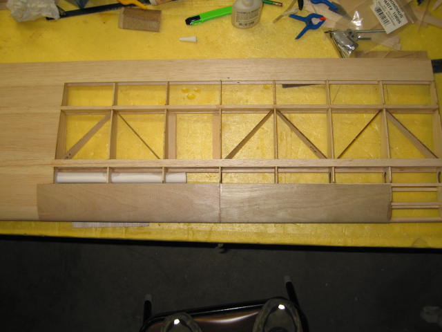

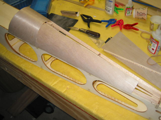

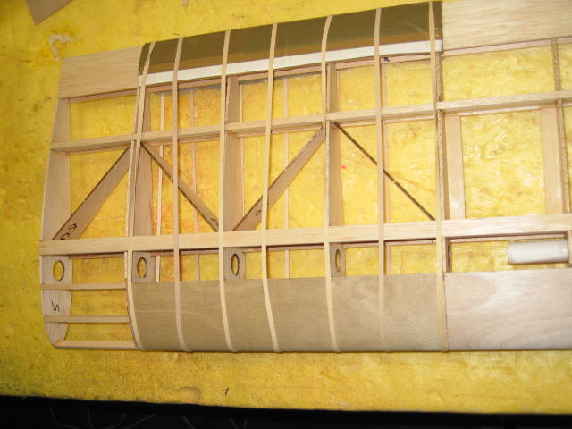

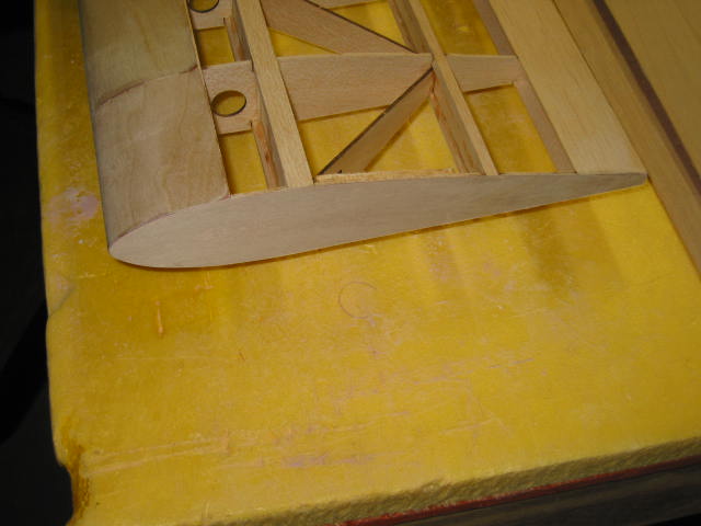

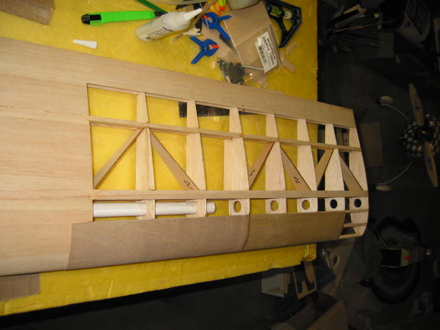

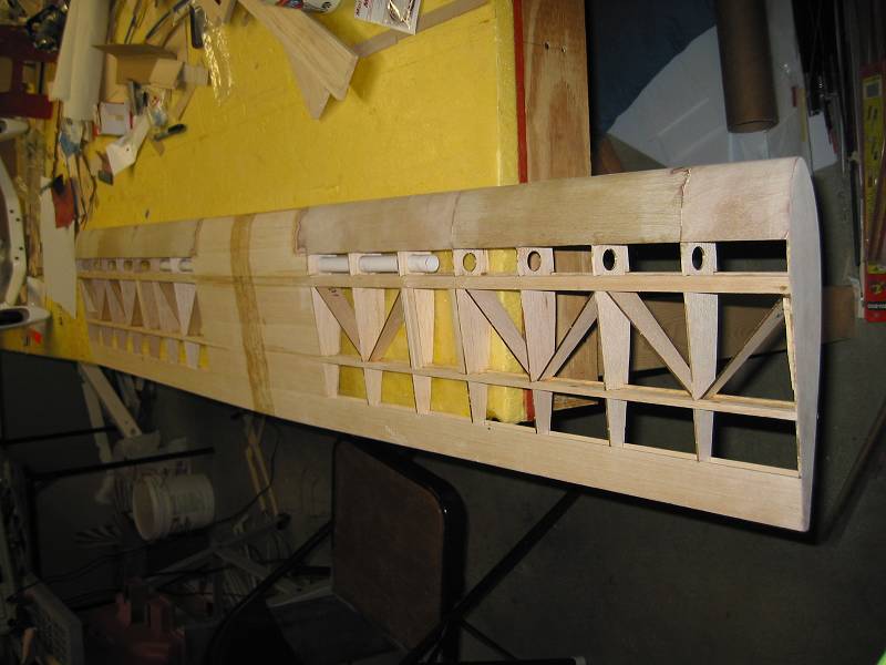

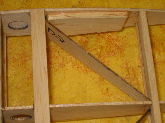

Here are some of the wing's leading edge and also I sheeted the outer wing rib to protect it. You can also see where I added a thick piece of balsa on the outer rib in case I need to install some screws later for lateral balance.

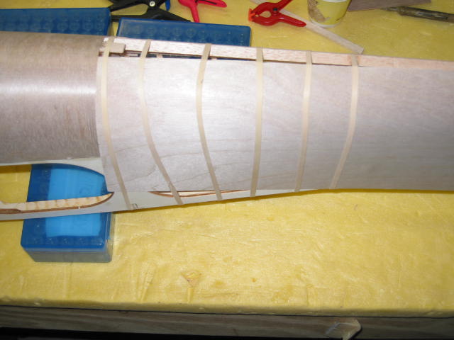

Very nice. What technique did you use to soften the wood so you could bend it so much?
Old 06-29-2006 | 01:33 PM
My Feedback: (84)
Posts: 681
From: Ida Grove, IA
Default RE: 4* 60 with sheeted leading edge and turtle deck

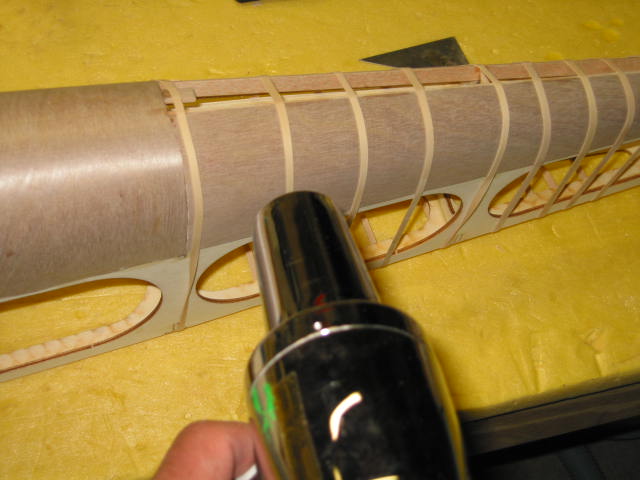

Actually I didn't have to do anything. It bent all the way with out breaking. But it felt like it was getting VERY close to doing so. So I rough cut them out then applied them with no glue, just a lot of rubber bands. But used a heat gun to help bend the 1/64th plywood. That let it lay right over. Then let it cool to help hold it's shape. After cutting and sanding till I was happy with the fit then I would reapply with rubber bands to insure proper placement. Then apply CA. The heat helped eliminate the under frame from reflecting thru the sheeting as it would round it out. Also I used a full sheet of fine sand paper and very easily sanded it by pulling the whole sheet over the turtle deck at one time. This takes the high spots off the edges of the balsa stringers so they don't show thru.

Wow, that looks great! So, the sheeting is 1/64 plywood?
Old 06-29-2006 | 06:01 PM
My Feedback: (84)
Posts: 681
From: Ida Grove, IA

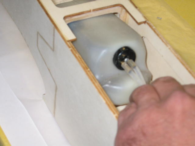

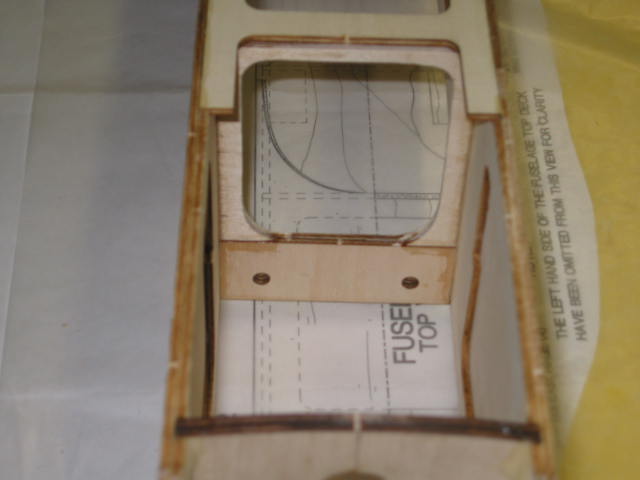

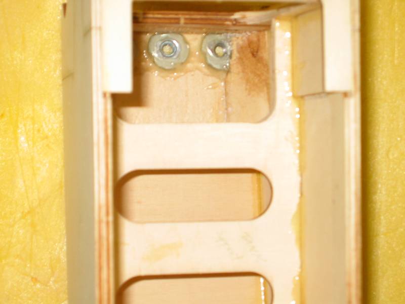

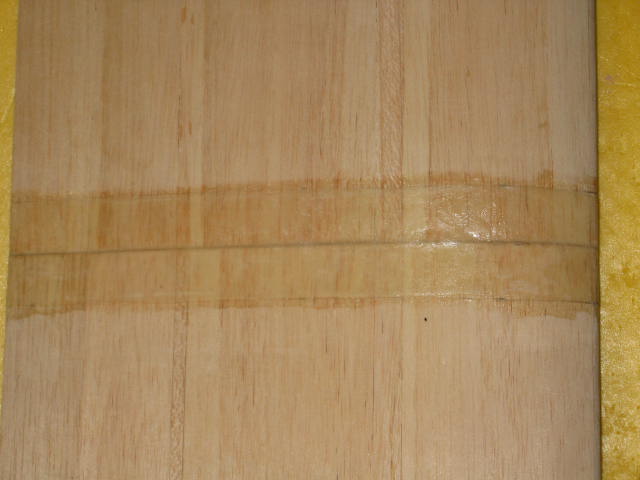

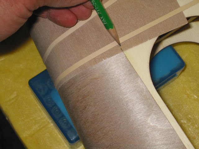

Yup. 1/64th ply. Not the cheapest way to go but the thinnest I figured. Since those pictures were taken the wings are done with the sheeting as is the fusealage. I have enlarged the elevators and rudder. About the only thing left to do is finish straightening the ailerons. They were warped. About done with that though. Then start on attaching the wing and control surfaces without glue to fit them properly.
The balsa sheeting on the inner part of the wing I recessed a little with sand paper to lay the plywood into then blended it in with sand paper.
I will get some pictures of it with the finished sheeting.

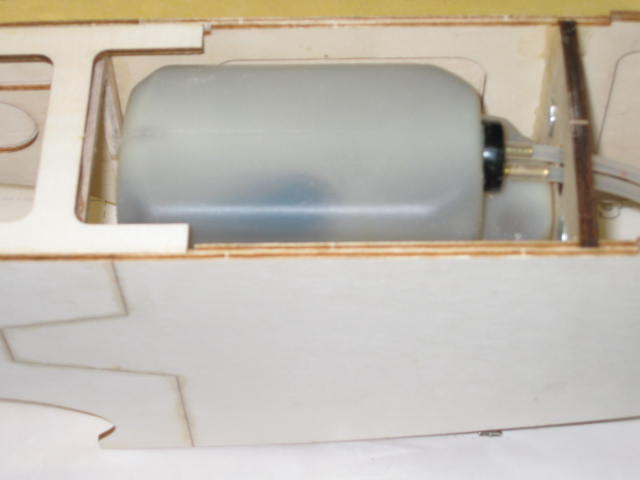

I also enlarged the F2 and tank tray just enough to allow a Dubro 16 oz. tank to slide thru. Then I built doublers for the weakened parts to bring the strength back. I already had a 16 oz. in my old 4* and wanted to stay with it. It had a removable raised tank cover. Which worked nice as I could inspect my fuel level or tank components at any time.
And I put a true fiberglass cloth with epoxy over the wing joit.

Looks nice, and I'm sure ou will be happy with the finished product. Just a FYI, the leading edge on the 4 Star contains 'turbulators' (or so I was told by a fellow RCer) They are designed to 'mix up' the air, especially at slower speeds, to stabilize the wing. As much as a floater as the 4 Star is, though, sheeting the LE will probably help with the landing. Full scale Ag planes actually use turbulators attached to the wing in all sorts of crazy looking configurations. This is to help them evenly disperse chemical.
Old 07-01-2006 | 08:21 PM
blw's Avatar
blw
Joined: Mar 2004
Posts: 9,449
From: Opelika, AL
I asked Bruce Tharp if he designed the 4*40 wing to use the spars as turbulators. He said that he did not; he used that method to keep the parts count low and to save weight. He said that he was sure the spars did act as turbulators due to the performance of the wing.

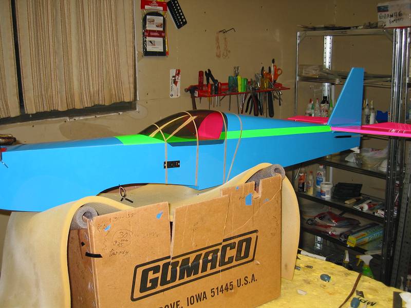

Well after a summer of everything else going on I finally got back to work on it.
I doubt I added 1 and 1/2 lbs. of 1/64th sheeting and glue, though there must be a couple ozs. there. But I also clipped the wing 1 bay each side.
Got most of the covering done. Also added a couple extra balsa stringers for support under the front top cover. I can see myself grabbing too hard there. That is a Dubro 16 oz. tank. Fit fine and is easily removable with a couple simple mods. See pics.
I am looking for the info and pictures on how people turned the canopy around for a different look. But can't find it. Can any body help me there? Or ideas on others that fit?
Still debating on going with the fiber glass cowl. That Cap 21 cowl looks nice. Have a Saito 125 sitting here.
I was thinking of enlarging the ailerons. Some one suggested just putting the large end to the outside. Any one ever tried that?

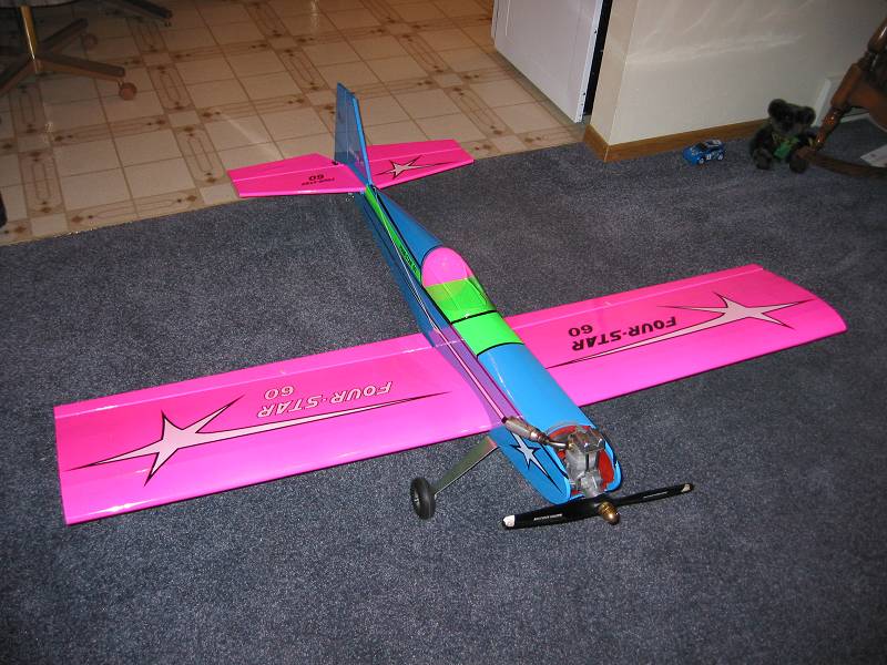

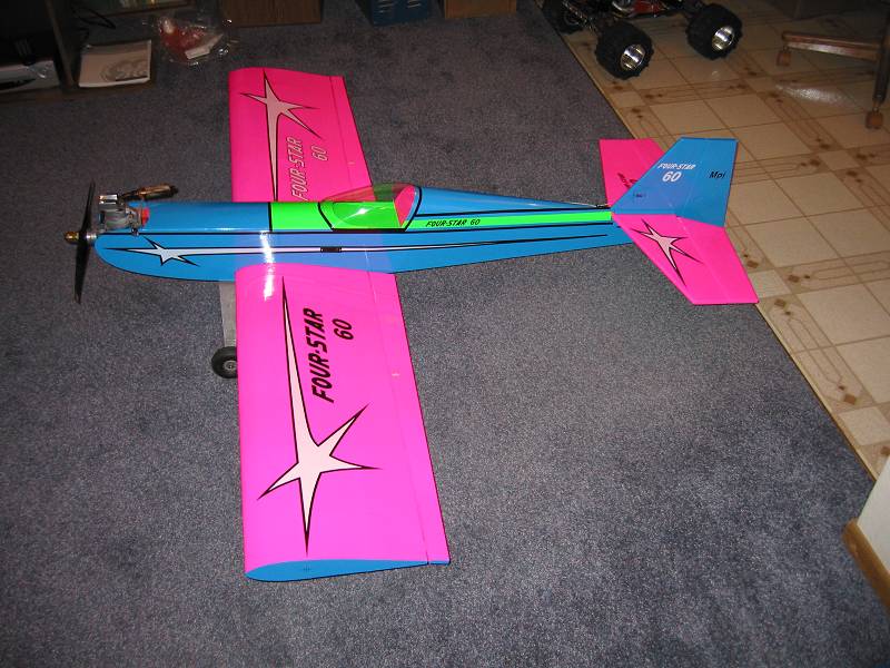

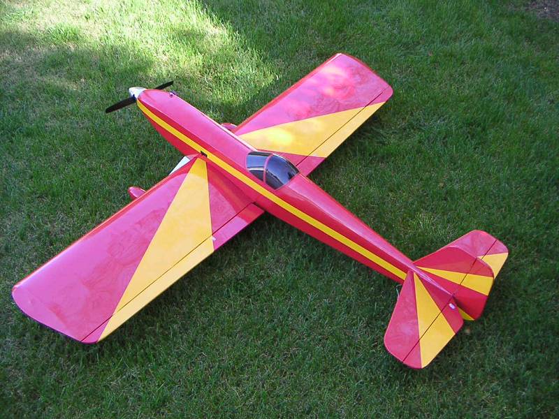

It's all done. Just waitin' for spring like weather now. Will probably put in the Saito 125 later if this shows good promise. So now I can move on to the next projects, finishing up a couple other planes. A CMP Katana 140 that needs some final little things and then hopefully either Great Planes Yak 1/4 scale or Byron Extra 28%.
A couple pics of it.

I finaly got the job finished, and did a maiden this morning. After a final check and tune job, up it went. All it needed was 2 clicks of down trim. No surprises and flew great. Only did the one flight as there were some realy strong and weird currents at the end of the runway on the way in. Up/down then lay left and right etc. All when it was only about 10 foot up. Been flying there for several years and have never seen that before. And the Avistar did the same thing. Decided not to test my luck any further. Besides, it was the first time out this year for me! Now all I need is more time on a better day.

Memorial day weekend I went out Sunday. Was out for several hours. Flys great. No surprises all day long. Only thing now is to move the cg a little. And maybe later put in the bigger 125 engine. Another winner in the 4 Star book.
