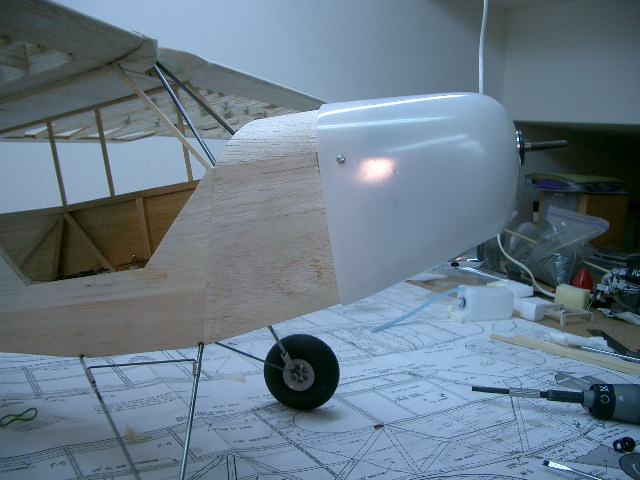

I framed up a Sig 71" Cub per the plans with original intentions to power it with a OS 40 2-stroke. I now have a OS 48 4-stroke which I want to install. Problem is, that the 4-stroke is about an inch to inch & a half longer than the 2-stroke (Due to the carb being on the rear of the engine) and in order to keep the overall length of the plane consistent with the plans I either need to (1) move the firewall back to compensate or (2) move the cowling forward with the 4-stroker. Moving the firewall back will require considerably more work, but I am afraid that if I do not the plane will be very nose heavy and will not look scale with the extended nose. What would you do? Thanks for your opinions.
First, I would seriously reconsider a .48 4-stroke in this Cub. I believe power will be marginal.
If you do install it, take the time to move the firewall back. Extending the nose may create balance and handling problems.

The kit calls for .25-.40 (2-stroke) or .40-.53 (4-stroke). Do you really feel that the .48 will be marginal? I was leaning toward moving the firewall but wanted another opinion. Thanks for responding.

If you go through with the .48, then I think you should bite the bullet and move the firewall back. You're right--it would be disfigured by extending the nose and you'd need even more tail weight. If your OS 40 is an FP or LA, maybe you should use that. The power and weight would be more appropriate. Use an 11x5 or 11x4 prop on a 40 FP. Good luck, keep us posted. It should be a pretty plane. Jim
