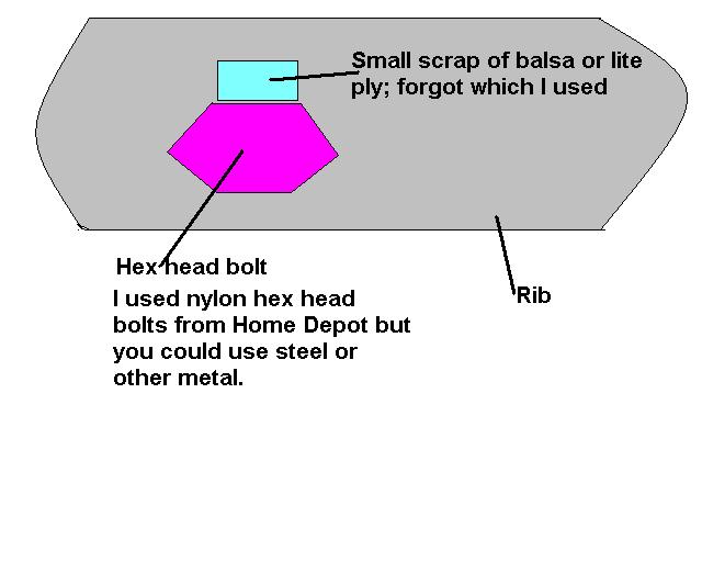

I'm about to start a Uproar 60. Had a question on the wing. It is held together by a 1/4 20 nylon bolt that is screwed into each of the wing halves, and CA'd in place. To lock the wing in, a aluminum tube, a stabilizing dowel, and the bolt are the methods. I wasn't really to keen on glueing the bolt in, since if I needed to replace it, I'd have to tear up the covering. I was thinking about putting a blind nut on the inside of the wing and screwing the bolt into that. Any Ideas or sugestions?

i've seen my share of giant scale planes that have the same type wing retaining method as you're describing. it always amazes me that each 4 ft wing section is held in place by one 1/4 nylon bolt. as to which is better- i can't say
imho i think that either way would be acceptable
maybe the bolt in the wing and the nut on the inside of the fuse could be a bit better because you could drill a 1/16 hole through the stud and then secure the nut from backing off with a piece of wire (i've seen what happens when this bolt backs out, and-----it's not funny.)
however the blind nut in the wing and the bolt through the fuse would hold just as well, just make sure the bolt doesn't back out i.e. grab both wings and pull outward - just to check

I worried that the screw could possibly back out over time and become loose in the wing rib so I replaced the screws with nylon hex head bolts, and glued a scrap of wood against one of the flats to keep it from backing out.
I thought about using steel bolts, with nylon nuts, so there would be no chance of stripping the bolt; but decided to stick with nylon. You could “gun drill” a steel bolt with a 1/8 (or slightly bigger) hole to eliminate some of the extra weight.
If you go the blind nut route, which I think is a really good idea, be sure they are glued in securely or they will fall out and force you to cut into the wing.
