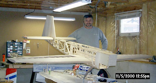

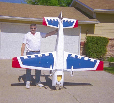

I built this kit too. Construction, manual, etc was all excellent.
Mine was way under powered with a G-62. The 62 flew it well, but it really lacked in performance.
I would say that a good 100cc engine is in order.
