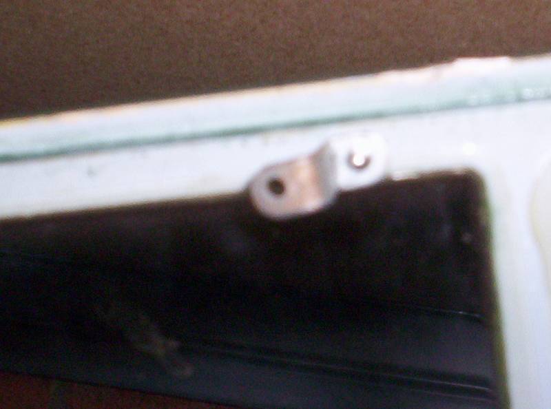

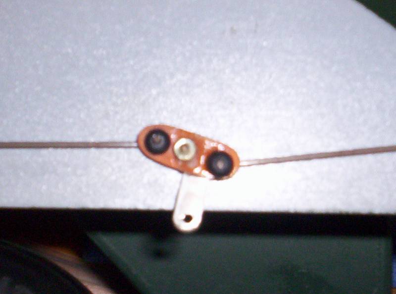

Been doing some research on the mechanism that holds the upper window door open. Cant find any pictures anywhere on this. Can somebody enlighten me?
Edwin

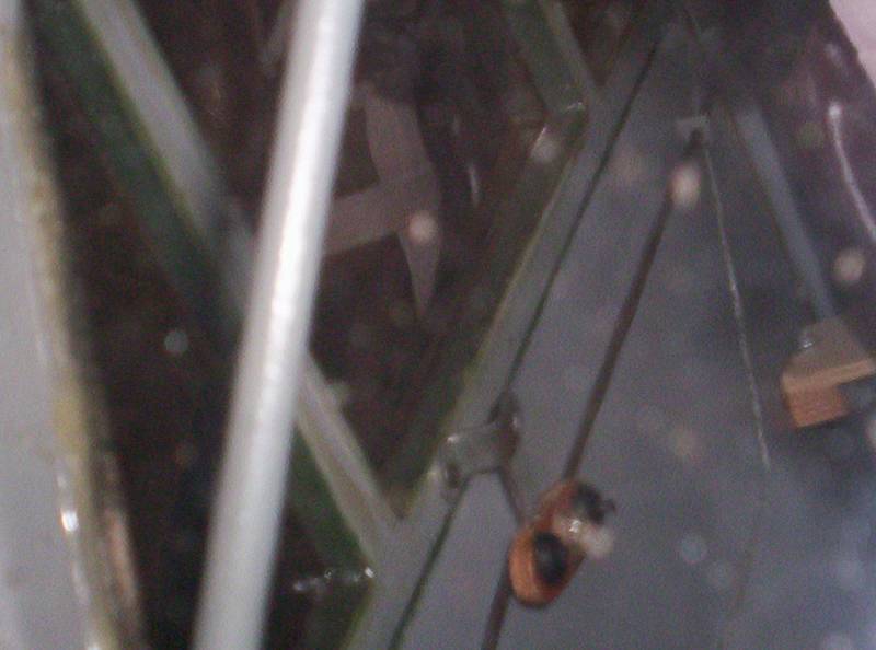

It's a simple latch; I had a picture of it but lost the hard drive temporarily. I made a simple tab for my plane that just rotates on a screw mounted in the spar, it holds the window open even in flight, if I want. You may also want to consider a latch to hold the window closed. Mine flapped in the propwash, so I made a couple of tabs for the door mechanism that latch the window closed as well as the door. You can still unlatch the window to open it without unlatching the door.
1st pic is the tab to hold the window open, the others hold it closed:

Exactly what I wanted to know. Thanks for the info. I saw the engine plans on the cub den, think I'm gonna do that too.
Edwin
