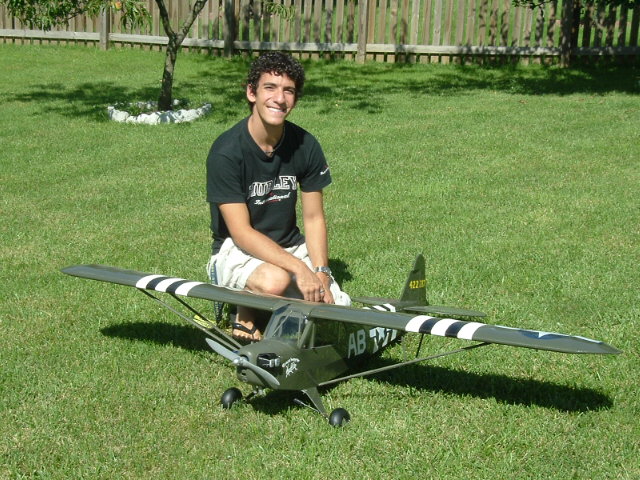

I've built the GP .40 Cub. It was a great kit to build, and built by the plans, it was fast and easy to put together. The only "issue" I had was covering the open turtle deck bay, but after some persuasion, I got the covering to fit down fine. I also finished mine as an L-4 Grasshopper, however as I'm sure you've already noted, it would be quite a mod to add the extra greenhouse windows on the GP Cub considering how the wing bolts on the the fuse. I put an OS .46 LA in mine, and with the 12 oz. fuel tank, it could easily fly 20-30 minutes. With my set-up, I could cruise around scale-like at 1/3 throttle, but there was plenty more thrust for "Cub aerobatics". If you use a 4-stroke, you could mount it inverted and get both dummy engines on the cowl for scale appearance.
Unfortuntely, I lost mine in early June when it tip-stalled during a bad landing approach with strong crosswinds. It dropped vertically from ~35 ft, and hit a pilot fence. That sheared off the right wing a few ribs out from the fuse, and the impact damaged the firewall too. While most likely repairable, I will probably move on, and someday get another maybe larger Cub.
And once last thing, if you are to finish it as an L-4 in olive drab, be sure to add the D-Day stripes at least on the wings! At the fields where I fly, when it dropped down below some dark trees on final, it could be hard to spot even with the stripes! [sm=tongue_smile.gif]

Oh, Spitfire, there's no way I could tear up a nice plane like yours, and be grinning about it. Oh, well, to paraphrase Maximus from "Gladiator"---"death smiles at us all, All we can do is smile back."

Khodges, yeah dont ask me why I was grinning like an idiot...guess it hadnt sunk in yet. I obviously wasn't happy about it, but a crash is crash, so no sense getting too upset about it. Plus, I had built the plane a few years ago when I was 13 or 14, and I really didn't expect it to last this long. I got my enjoyment's worth out of this one!
