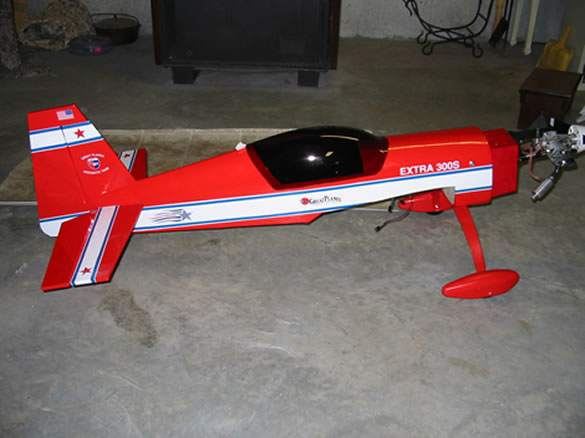

About 5 days ago I attempted this for the first time on my GP extra 300S 60 size. Here's what I did.
Purchased 1 Black Rit Dye and 1 Navy Blue
Filled a 5 Gallon bucket with about 3 1/2 to 4 gallons of tap water as hot as it would come out of the tap.
Put both bags in
Added a couple cups of salt
Mixed 30 secons to 1 minute
Submerged My canopy
I frequently checked it, just pulled it out and looked at it if it was to light I put it back in. After about 15 to 20 minutes I achieved these results.
Good Luck.

must of used clear on the cowling ! haha......
very nice rit dye job!
