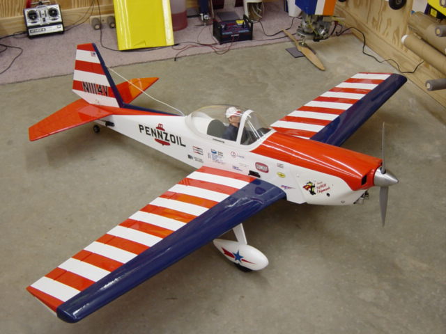

If your talking about the Goldberg Chipmunk, I use (2) 3101's (Futabas version of the mini servo) on the elevator, and S148's on the rudder and each aileron. I do not have flaps. You may want to put more torque on the rudder, but I seem to have plenty with the S148.
Ryan

Thanks for the info.
GREAT looking airplane!
btw, is that a glass cowl? wheel pants too?

Yea. The cowl and pants are fibreglass from Stans fibretech. Stan does some outstanding work! Did away with the plastic bellypan; built it up with balsa as part of the wing.
Saito .91 for power makes an excellent combination.
Ryan
