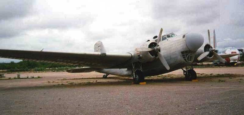

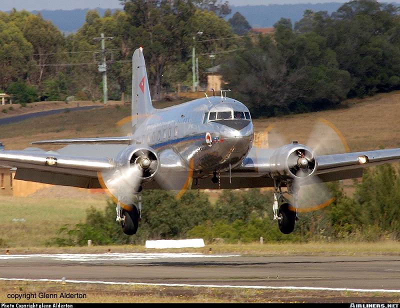

DC3 to a B-18....looks possible, the tail in the DC3 is similar, but defiantly not the same, the tail in the B-18 looks to be higher, and the nose is very different. If you could pull it off, that would be amazing!

I do know that the DC-2 (I said DC-3 earlier) was Douglas's starting point when designing the Bolo. The wings were lengthened a few feet each and, like you said, the tail surfaces appear to be a bit larger. And the fuselage looks to be completely different. I dunno, maybe it isn't worth trying to modify a TF kit. It was just a thought.
