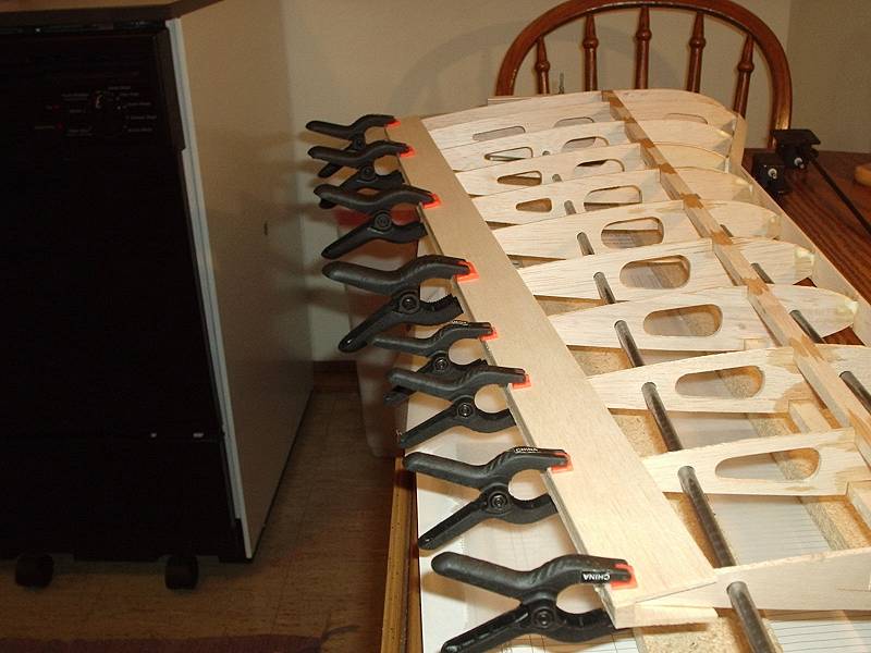

Time to build the wings !! I have acquired a Wing Jig by GP and would highly recommend it to any one without access to a perfectly flat building surface or who builds aircraft in their kitchen like I do. Very easy to use and the wing built true and straight without any fuss. Ok onto the pics... In one of the pictures you can see my failed attempt at building a wheel well.[>:]

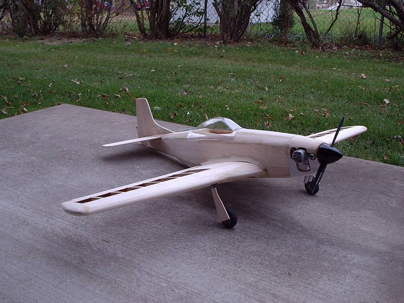

Old 10-16-2006 | 09:30 PM
  #27
Joined: Jul 2004
Posts: 156
From: Lindenwold, NJ
Default RE: Great Planes p51 First Time Kit Build Thread
Top wing sheeting was done using white carpenter's glue and masking tape to hold the sheeting in place while the glue dried. I soaked the wood in water before hand so it would conform to the wing curvature better. Pretty straight forward, the jig kept everything in alignment.

Old 10-16-2006 | 09:42 PM
  #28
Joined: Jul 2004
Posts: 156

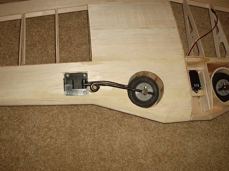

ARRRRRRGH I hate installing retracts[:@] I just spent the last 2 days sanding, carving glueing un-glueing and resanding the retracts, mounting blocks and associated hardware. This is about the time I start loosing interest in a project and add it to my pile of unfinished projects. I'm using Robart 608 HDs and the most frustrating part is securing the pushrod to the retract unit. The pusrod end is 2/56 threaded and screws into the acutating rod on the retract. Problem is the pushrod has to have numerous bends to clear the landing gear and these bends make it almost imposibble to screw the rod into the retracts. I don't konw how I'm going to be able to remove the retracts once the wing is sheeted. Does anyone know a better way to do this ? PLEASE HELP....

A little trick I always do is to mount the retract unit to the rails BEFORE gluing the rails in place. Then you glue the two of them in while the retract unit is still attached. Now you can remove the retract, and when you go to install it, it lines up perfectly.
Old 10-21-2006 | 11:19 AM
  #30
Joined: Jul 2004
Posts: 156
I finally got the retracts figured out, and the wing panels epoxied, everything lined up really nice. Here's how I did my wheel wells. 1/32 balsa soaked in water and then wrapped around a bottle while the glue dries.

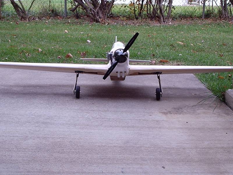

Old 10-21-2006 | 11:26 AM
  #31
Joined: Jul 2004
Posts: 156

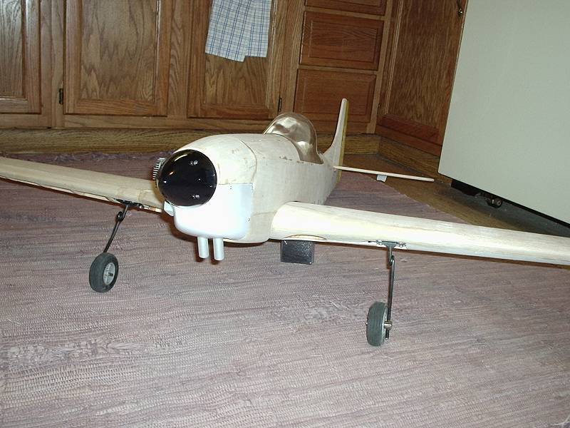

Just checking wing and fuselage alignment...

Old 10-21-2006 | 04:53 PM
  #32
MinnFlyer's Avatar
Posts: 28,519
Received 9 Likes on 9 Posts
From: Willmar, MN
Looking great!

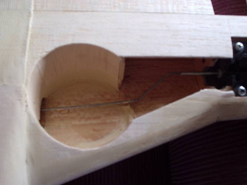

Scooty, I am about to install retracts and was hoping that you could explain the actuator linkage?, you mentioned having it solved it..what did you do?
BTW These GP kit have nice wood and the parts just fall out.....(just in case T.F. production team is reading this).... keep up the great work and I will be following along, Mikel-T
Buzz: I reread your reply about the retract rails..not sure I get it. Say again S-L-O-W-L-Y

I just changed my approach. Previously I had a hole drilled in the rib through which the accutator rod would stick out of, as in this pic. So I would install the pushrod, then slide the gear into the mounts pushing the accutator through the hole and then attempt to screw the pushrod into the accutator. After destroying several pushrods and bending them completely out of shape I basically changed my arrangement so that I could screw the pushrod in before sliding in the retract.

I got rid of the "hole in the rib" idea and enlarged the area with my dremel sanding drum so now I can just drop the retract in with the pushrod already attached to it. Hope this helps good luck with your build !

OOOHHH, THAT PUSHROD!!!.....Sure that's exactly the way I would have told you to do it------
Dah!, Nice job and the pic's clears it up, ALSO I was glad you showed the new shape of the LG door cut-outs. I think that will look superb when all is said and done.
*I might have set my retract a little higher and closer to LE than you . Not scale I know but since I fly off grass I wanted to keep the LG as positive as I could. Bad/Good Idea? Thanks again Mikel-t.
