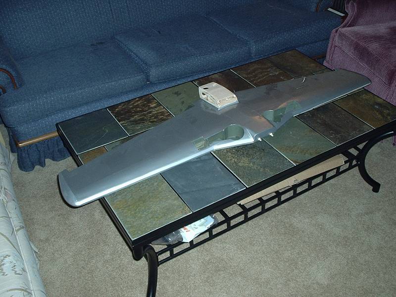

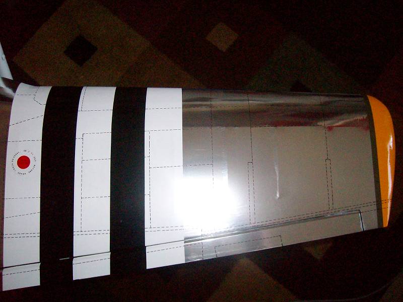

Finally got some monokote and covered half the wing !!

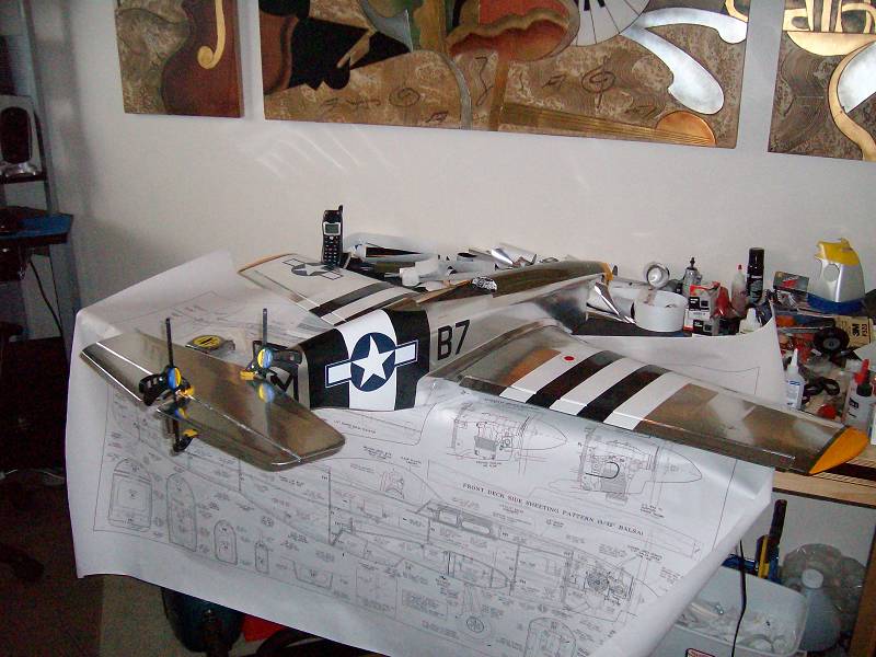

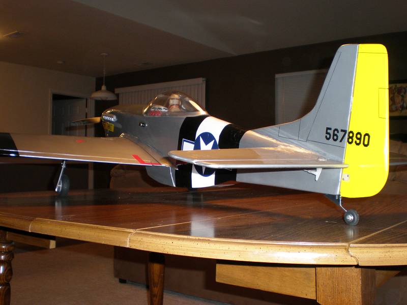

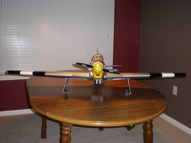

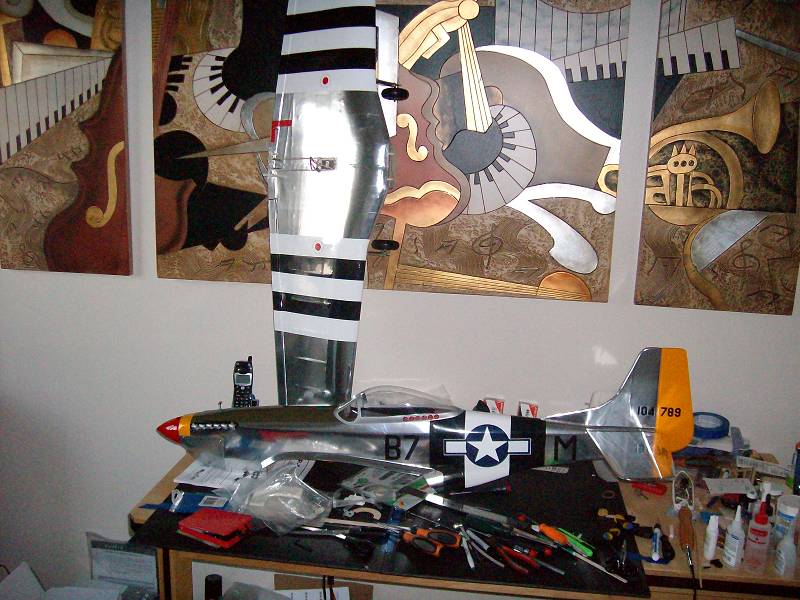

All right everyone, she's finally ready, exactly one year after I started construction! In many ways this build has been very emotional for me, I've been through losing a job and very recently a divorce as well. A lot has changed for me in this past year, I've lost a job (that I hated anyway) as well a wife (not 2 sure how I feel about her) but at least I have a shiny new P51!

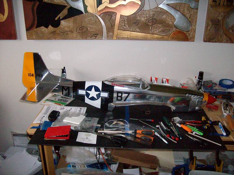

more pics...

Maiden flight just in!!!
I was very concerned about yanking it of the runway too soon and stalling it, so I just let her roll using no elevator and just rudder to maintain heading. In about 60 feet she did a little bounce and settled back down. Another bounce, a touch of up elevator, and holy crap she's flying!! Quick, 3 clicks down and 2 clicks right aileron and I was in complete control. I did a few circuits till my knees stopped shaking, and then it was high speed passes, inverted passes, victory rolls and split S's. She performed all flawlessly. Time to check stalls. Pull back on the throttle and WOW! She got really slow before mushing forward ever so slightly. Not even a hint of dropping wingtip. Smooth throttle to full and Woah! Need just a touch of rudder to keep in track, just like a real and true plane Ok time to land. Throttle to idle, line up, let her drop on her own, too much altitude. No prob, throttle to full, ready on the rudder this time and CRAP! Dead stick!! "KEEP her level, and just let her glide in, don't turn around," the old guys behind me coached. So I did just that and pointed her towards the weeds. I saw a wingtip fly up into the air as she hit. This is not going to be good.
The Wing is fine, airscoop needs to be glued back on. Wing mount plate in the fuse needs re-glueing. There is a 4' slpit behind the wing on the fuse where it separated from some formers. I'll post pics later.
BUT SHE FLIES, AND REALLY WELL TOO!!!

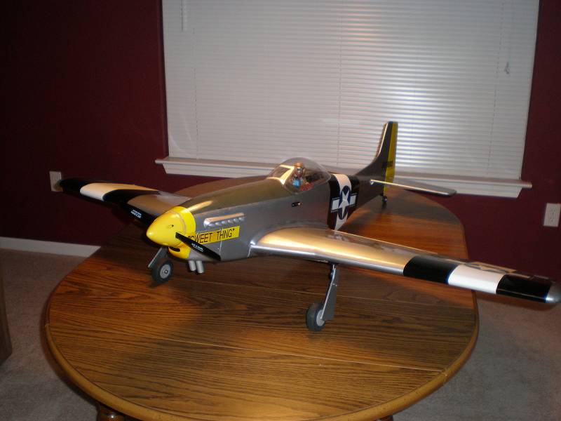

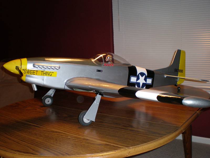

Hi Guys, I just finished mine. Nice work; yours looks great. I'm using the O.S .46 Max, Hitec Servos. I still need to find a yellow spinner and finish the cowl paint. She is RTF other than that. starcop
Let me know how this plane fly's? I've heard good things! After checking everything on my project; it is absolutely perfect, not even a 32nd off. This kit was awesome to build. I also installed the On/Off switch today.
Hey Scotty, I read your post; I would cry if I crash mine, I'm going to fly her Sunday. Thanks for the flight info. Sorry to hear about the miss-hap, but at least you have a handle on how she goes together. Good luck and have fun. starcop
This is like 2 years later...![:'(]

Excellent work Starcop! LOVE the alum covering. How did you do the panel lines? I experimented with a panel line pen and did the entire tail surface only to find that exhaust residue made them run!
Any flight report yet?
Old 09-02-2008 | 10:40 AM
  #69
Joined: Dec 2005
Posts: 1,296
From: Nampa , ID
Default RE: Great Planes p51 First Time Kit Build Thread
Hello Scooty, Thanks for the complament; I used the Parma Dual Tip Detail Pen, it seems to hold up better than a Scripto Fine Black permanant ink pen. I had to let it sit over night, but now I can use glass cleaner and it doesn't wipe off. I do have to go over areas when fuel sets on it at the field, but it's still visible so I just go over it and let it dry.
The maiden flight was out-standing! I only had to click ailerons 2 clicks left and she was flying perfect. This is by far the best Mustang I've flown in the 7 years flying R/C, it has Zero bad habbits, I can crawl to land or fly it to the ground and chop the throttle; it's a very forgiving wing design. She also does some wonderful aerobatics. I'm pleased with Great Planes, it took me about a month to complete; the maiden flight was flawless. I posted pictures of her flying and the tail end of the landing. I'm not sure where they are now, I suppose you could look and see if you can find them. Take it easy, starcop

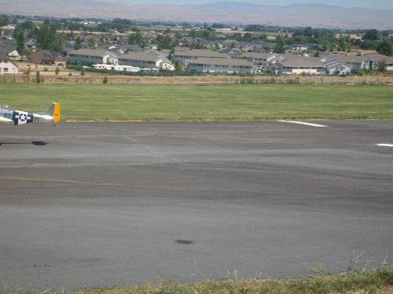

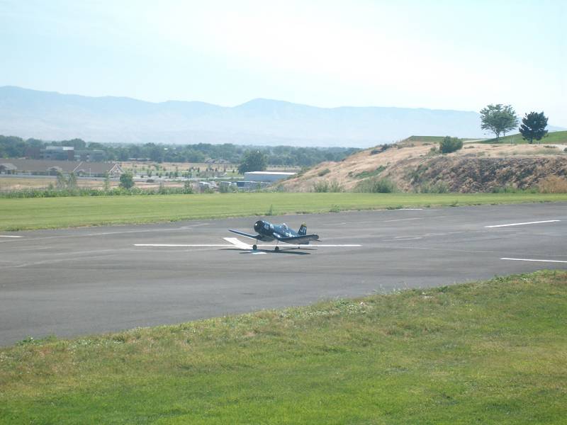

Howdy, I have the nose cone in the way of the size of prop I'm using, I forgot it's been a while sense I've flown her or biult this bird; she hangs from the ceiling now days. I'm building another Top Flight Spitfire, so I've been waiting on landing gear funds to complete her. I'll pull the flight picks and post them, she's only been flown once and it was flawless, these Mustangs fly very well, a novice or intermeadiate expert could have a lot of fun. I wouldn't start out with this plane. You might get lucky if you've flown before, but it takes a steady stick to land her. I have so many other airplane pictures I have a tough time finding the Mustang pictures in all my folders! I hope I got the right ones! starcop
Opps! One is of my Corsair before take-off. The Mustang is just landing they mist the plane slightly, ha ha. Oh, well I do have a few of it in the air, I'll have to sort all these pictures out. Not sure on prop size; it's around 11.7 (3 blade, master air screw) in fact I'm sure that's what I used. With an OS .46 or .52 two stroke, gee I'm getting "sea-nile!
