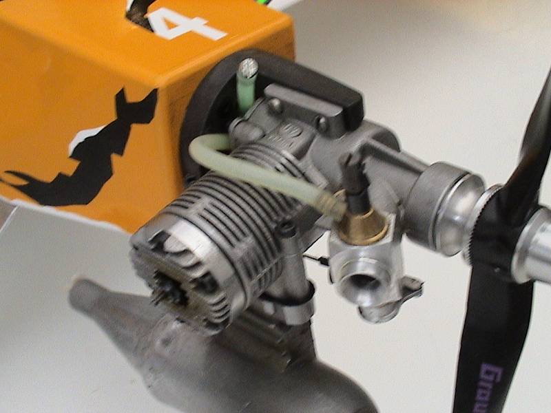

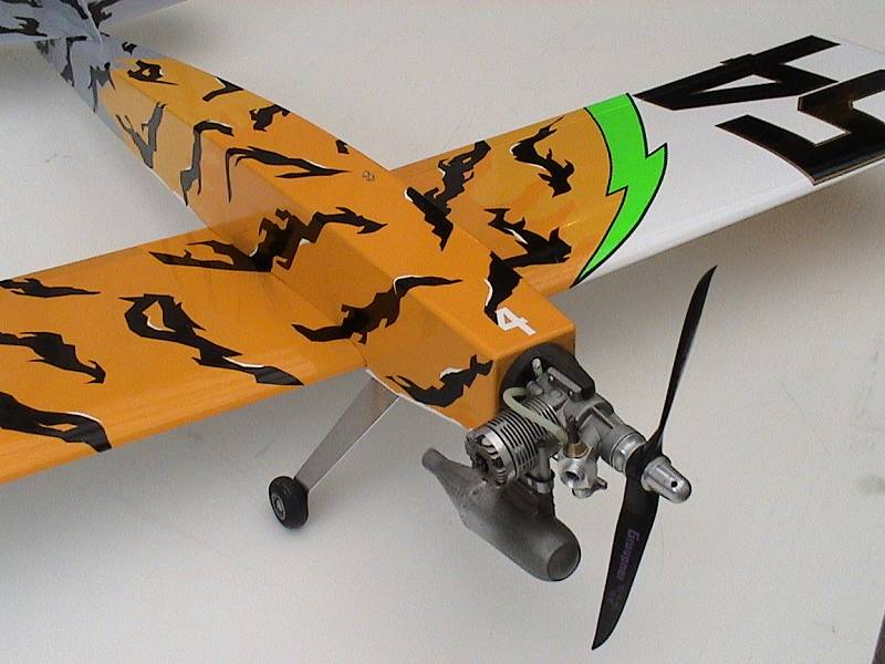

Hi!
Sheet metal screws is the way to go...and Dave Brown plastic mounts (hard and good mouldings). Have used sheet metal screws for years (31) on many airplanes ...pylonracers, scale ...you name it , always worked good.
