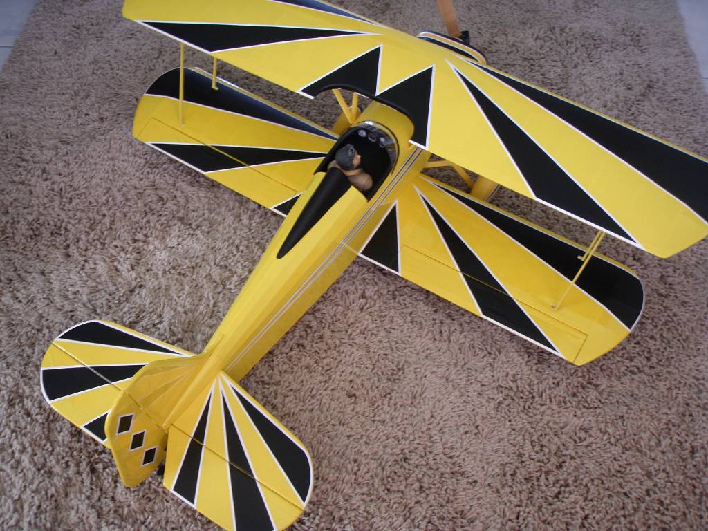

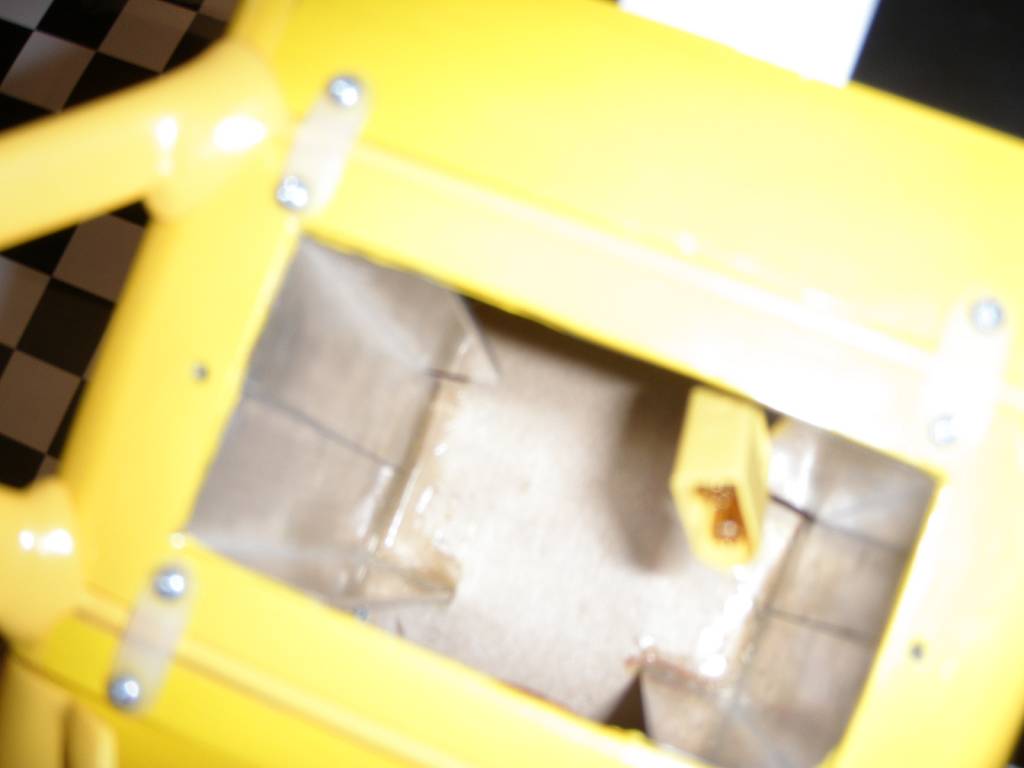

Ok guys im back home from uni now so I can answer some questions. The overall weight of the plane is exactly 5.5 pounds with the batteries installed ready to fly. This weight could easily be reduced, as the slimline pilot is the heaviest I have come across but looks really nice IMO. Also the eflite 46 motor is not the lightest in the class and the engine standoffs are ones that I had sitting around and are a little overkill. The batteries are 2200mAh when 1800mAh would be more than sufficient so an overall weight of around 5 pound or less would easily be attainable. The prop clearance with the 13x7 prop is not an issue at all, 14" could be used but you would have to be careful. As you can see from the photos I have fitted a hatch in the bottom of the fuse to accept the batteries, this hatch uses four light gauge aluminium angles to form a box section so the batteries fit vertically. The power system im using is 4S which i have achieved by using 4S 2200mAh packs and wiring them in parallel to create a 4S 4400mAh pack which resembles a brick instead of the usual single 4S packs which are long. As i have mentioned two 4S 1800mAh packs would be great as well as you would lighten the plane and would give you 3600 mAh which would equate to about 8 minutes of flight, as it is now with the 4400mAh packs I get a generous 12 minutes of sport flying with throttle management. The plane is not ballistic by any means, my hangar consists of multiple planes pushing out more than 200 watts/pound and can hang of the prop so they are very powerful so in comparison flying this plane is similar to flying a trainer in flight characteristics.....its that solid. I have recessed the cowl into the fuse so that it fits flush and not just simply slides over the fuse. The cowl also has the mounting nuts through the firewall so there are no mounting nuts or bolts through the side of the cowl to crack later. Im not here to bash glow planes as I own one or two myself but this little machine setup electric is smooth, quite, clean and vibration free meaning the airframe should last forever and a day with some luck. Having said that a plane with this much character probably deserves a burble of a glow engine to add some nostalgia.......horses for courses. By the way i forgot to mention that the colour scheme was pinched from a full scale Pitts i have on a flight sim.

Very nice, and a great job with the electric conversion as well. Come back and give us a post-flight report, at that weight I'll bet she's super easy

Ok guys, just got back from the field. Well the Master Airscrew 13 x 6 is out, it was too slow and didnt really pull that well like I said earlier....very scale. I then fitted a 13 x 8 VOX prop (rebadged Xoar from precision aerobatics). To say the difference was chalk and cheese is an understatement. The 13 x 8 pulls the Smith along at a fair rate of knots, the vertical is not unlimited but close to it and very satifying....all in all its just more fun to fly. I am using a Castle Creations Ice 75 esc with data logging. The data logged shows the Vox prop is more efficient and spins at higher rpm and provides more thrust.....so basically its a winner all round. Landing was a non event...not a floater by any means but once in ground effect greasing the Smith is so easy. There is some history behind my model as my girlfriend now wife bought this kit for me 16 years ago....I finally thought I would build it this summer (southern hemisphere). I wish I had done it earlier...just a beauty.
