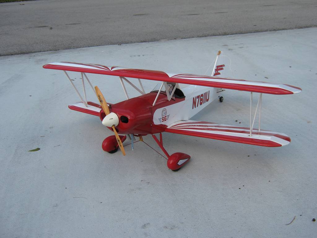

Here are my latest “observations with my “Smith” and the ongoing experiments…..
Now it weighs 6lbs. I don’t have my notes with me. I think it was around 5lb 14oz with the other engine.
I have heard people make reference to this plane being a floater. One thing is for sure theirs and mine don’t fly the same. I about planted it yesterday because I forgot that it is not a floater. I have a 71” stick plane that floats. Lands at walking speed. The “Smith” will fall out of the sky at walking speed. I guarantee it…[
Anyway, I put another 5 flights on it yesterday. With the right thrust change (reduction to 2.4°) the plane behaved better. On this note the plane was more stable in hard elevator maneuvers and recovery to flat and level was a lot more predictable.
I am inclined to believe some of the differences I am seeing in thrust all of a sudden is that with this engine I am using 12” props and with the other engine 10”.
It is flying funky while inverted. Even at half throttle it tries to climb when I go inverted. So, I will be moving the CG forward from were I have it. Back to the manufacture recommended location. I may also decrease the amount of down thrust.
Late in the afternoon the air went completely calm. Along with having some more stick time with the new configuration, I was able to pull of some nice touch and goes in both directions. Meaning, I am getting use to the new take-off and landing characteristics of the negative wing incidence I now have it set up with. I have always landed this thing with “power on” but now it is a must.

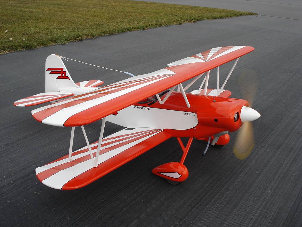

I'm in the process of building one of these planes. I have completed the top wing and just completed soldering the cabane struts without installing the plywood strips for the wing hold down bolts and when trial fitting the top wing on the struts the straight portion of the upper struts overhang the slot in the wing about 1/8" on each one. Has anyone experience this and how should I remedy this. Would decreasing the angle of the cabanes effect the flying? I would appreciate any help with this. Thanks...Pete

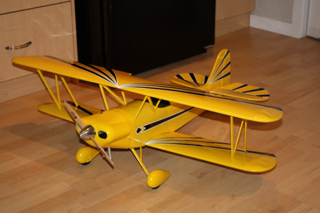

I just finished mine last night. Almost finished anyways; I just need to finish gluing the windshield on.
It's got a 46AX and a Bisson pitts muffler, the rest s built according to the plans with only a couple very minor changes. It balanced perfectly without adding any weight.
I'll probably bring it out to the field and get it in the air next weekend.

ORIGINAL: rc_wings
Very nice job...looks good in yellow! Is that the test pilot in pic #2?

We always like to see more pictures of a “Smith”. Open your picture and do the “save as” option to create a different picture to modify the size and this will leave the original untouched.
Pitchy you say? First question would be: How much throw do you have on the elevator? Ailerons can use about all you can get but the elevator is good with a small amount of travel. Somewhere not too far back I posted what I am using for throw and it is close to being too much.
The only thing I'm not quite happy with is the roll rate. I currently have 1 Hitec 85MG running the ailerons, and I'm going to go ahead and install a second, side by side, each independently running an aileron. I can extend the throw this way with overloading the servo, and without gaining too much weight. A simple bit of programming in the radio (JR 9303 and 790 slectScan rx) and no y harness needed either. Perfect for adding aileron differential to make the rolls more axial. I'll let you know how it worked if you're interested.
You mentioned your plane is floaty on landing. How much does it weigh? Just curious.
I apologize in advance if the picture comes out huge. I tried to reduce it. Not sure what I'll get.
#365
reincarnate
Box top scheme or not…..It looks nice man. You should be proud to post it. Nice job with the weight. 3/4 lb difference between yours and mine. That will make for a significant difference in flight characteristics.
I’d be interested in reading what you have to write about adding the second servo for ailerons. I think rc_wings was talking about doing the same thing as what you mentioned.

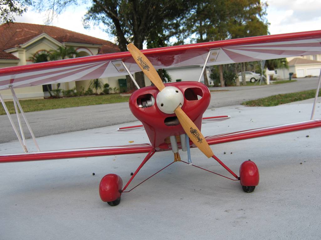

He! just find this. Here is a version of the SM. Built per plan Power OS SF 40. Really a CRAFTMAN KIT. This little plane will test you and you have to be patient. Raymond

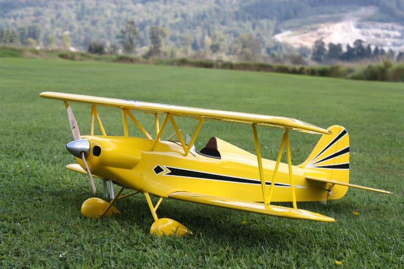

I finally managed to get mine in the air. It's been sitting ready to go for a month now. I had it up three times, and it flew great.
I have a 46AX with a 11x6 prop, and it's more power than this plane ever really needs. Vertical performance isn't really a problem. It will climb straight up at about 2/3 throttle as far as I could ever want. Ground handling is not bad at all. It definitely has a good pull to the left when you open the throttle, but it's very predictable. Landing is a breeze. It's been the easiest first flight of any of my planes. The only trim was about five clicks down on the elevator. I started having fun with this one right away. Aerobatics are smooth, and the snap rolls are impressive.
It was built almost exactly according to the plans. The only changes were a little bracing for the landing gear, and a little strengthening in the spar joints. It came out to 5.3lbs fueled and ready to go.
