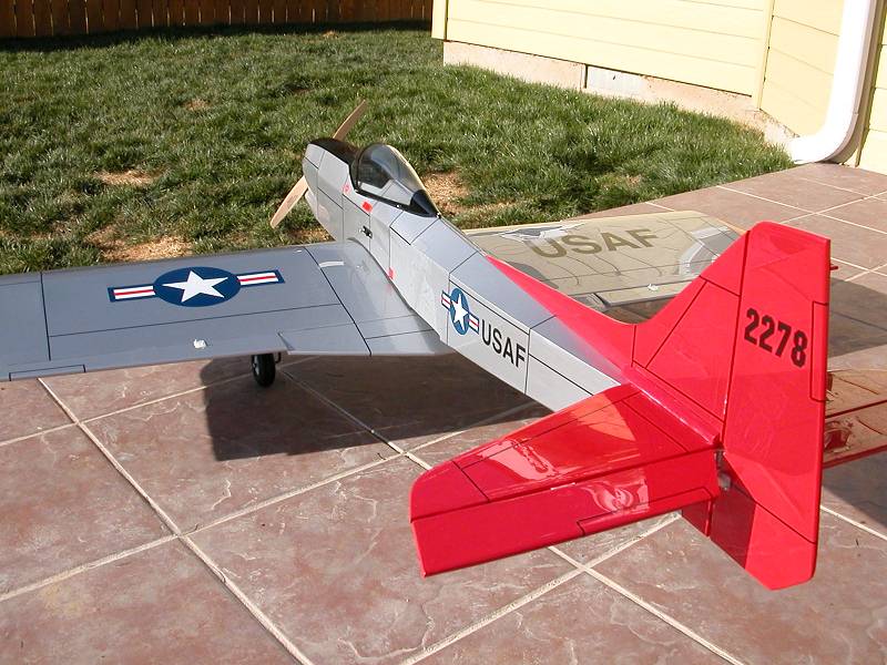

As for modifing the plane, don't mess with a good thing. The plane flys just great as is and needs no modifications. If you have a 5th channel available, hook up the flap as it ads another dimension to how the plane flys. As for a work bench, I have a couple of saw horse's and a door that I got from the Home Depot for about $16.00. I have used this combination for years. If you need storage as well, you can get an old desk from the Goodwill and put the same door on top of it. Good Luck, Dave
The Contender is a great flier. I added some rudder area to mine (see image - mimiced the horizontal stan/elev shape and added about 30% to the original). Much more authority for stall turns and flat spins. I'd only do two things different. I built the upswept tips and I don't think it is worth the cost in looks. I've flown another pilot's Contender and it doesn't fly any different either way. I couldn't get his to do the "Dutch Roll" that the upswept tips was supposed to prevent. And, I should have tipped the engine to run the exhaust low and get the cylinder out of sight more. I've seen a couple here and it is much racier looking with a smooth nose from spinner to canopy.
I also built a functional nose intake about 3/8" wide and 1/4" deep inside the "dummy" nose scoop to drain any spilled fuel and to get the air/cool back to the engine. I installed an O.S. FS70II with a rear down-facing carb. Poor man's turbo booster.
Oh, and I would have painted the inside of the canopy or just left it clear. I tried dying mine and it came out dark orange/brown instead of the dark gray I was trying for (first attempt was purple and I bought a second canopy). I even tried dying the scraps first and they came out OK. Grrrrrrr.

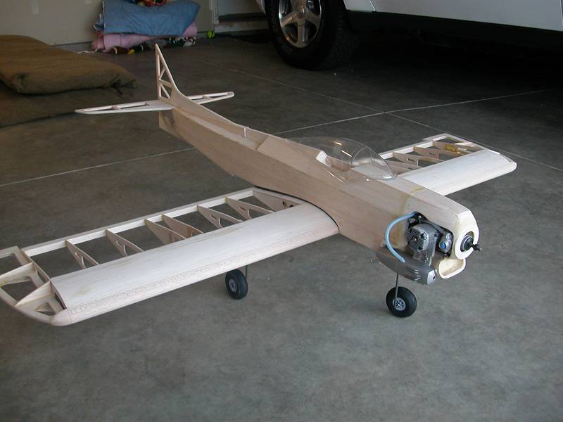

I am currently working on my Contender. This is the second kit I've built. I tried to attach a couple of pictures, hopefully it works. I am in the final sanding stage getting ready for covering. Mods include a larger rudder, and side mount engine. I never bolted my landing gear mount, and wish I would have after reading this thread, I probably will eventually do it. I have really enjoyed building this airplane. Let me know if you have any questions, I have some more pics that I can upload later.

Hi Nik: You have done a great job. Good clean looking build.I would make the following suggestions.
(1) You can add a small piece of balsa to each side of the top of the fuselage to hide the fin and joint (verticle stab)
See attached picture. Makes covering easier and looks better.
(2) If you haven't already, install servos, battery etc. and laterally balance plane before covering.
I had to use 3/4 oz. to right wing to offset upright mounted OS .61 with muffler hanging out to left.
I look forward to hearing your flight report. Keep the progress pictures coming.

Thanks for the suggestions Safebet I will be sure to both of those. I'm all about making the covering job easier. I hope to work on the plane all this week, so will post more pictures soon

Its been awhile but my Contender is almost done. Just finishing up installing the pushrods, and working out any minor bugs. What do you guys think of the trim scheme? I modeled it after a P-51 picture I found. Still looking for some sort of nost art.
