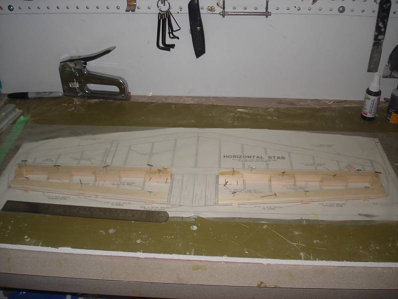

Here is the first pic - the Stab is pretty much done, just waiting for the glue to cure.
No problems at all so far, but they again I have only just started. Tomorrow I will start on the Elevator and hopefully get that done. This looks like a pretty easy build, the biggest problem is the size of the plane, it will be 89" and about 17lb when complete.
I am using mostly Yellow Glue, Epoxy and Gorilla Glue in some places. CA is the last resort, I hate the smell and the cost, not to mention the short working time and clean up. I also got some new tools, a razor saw and some medical clamps and tools, all of these make the building much better. This will be my best quality build yet, it will be my 7th kit.

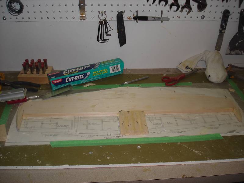

Well the Elevator is taking a bit longer than I would like, but that's only because I was having trouble finding the right wood to use, there are so many sticks of different sizes in this box it can be tought to find the right ones.
I spent about 2 hrs going through the manual and picking the right wood for each section, them marking it and bundling it to make it easier when I get to that section.
This is what the Ele looks like so far.
This has not been a tough build at all, very simple really the only problem will be finding a room in my house that is big enough to build the fuse and wing.

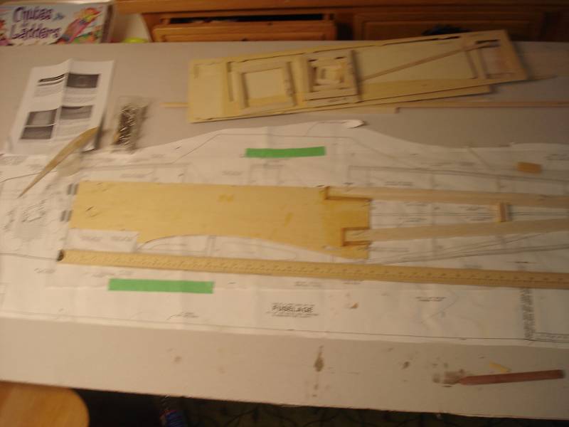

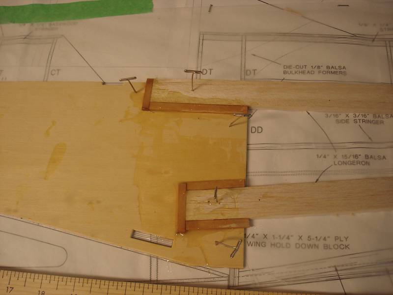

Started the Fuse tonight. The sides are built with two long balsa 1/4X5/6 sticks that are cut and fitted, then supported by 1/2 X 1/4 balsa sticks and attached to a ply fuse side.
No magic in any of this, only taking caution to make sure everything is build straight and true. The plans have to be taped together, and I had to move out of my shop to a much bigger room with long folding table. I build on top of 1/2 drywall laid on the table, it works well, is very flat and pins easily.
The fuse side is attached to the balsa with regular epoxy - the instructions say to use 6 min epoxy, but I like the additional strength that the regular stuff gives you. I also applied a layer of epoxy over the ends of the balsa sticks to give them a bit more strength, the tail is not a high stress area, but I want it a bit stronger anyway.

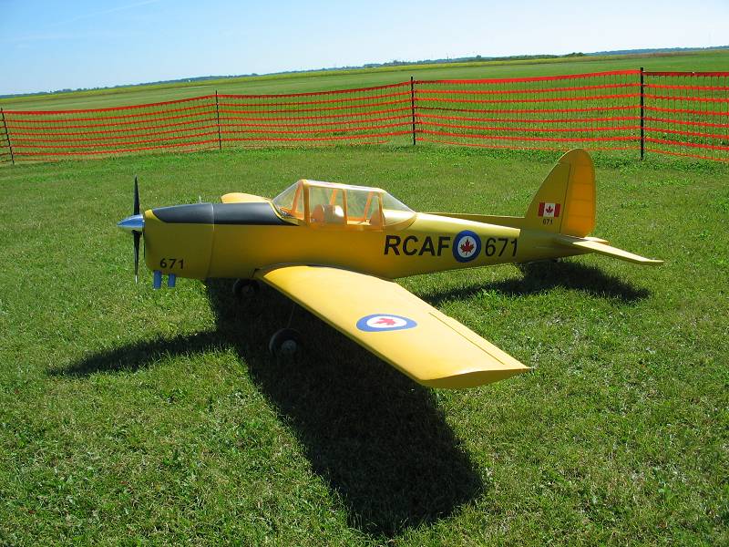

No pics of the Wing yet, but the fuse is in good shape as you can see here.
That is sitting on a full sized couch, you can see it is a very big plane.
