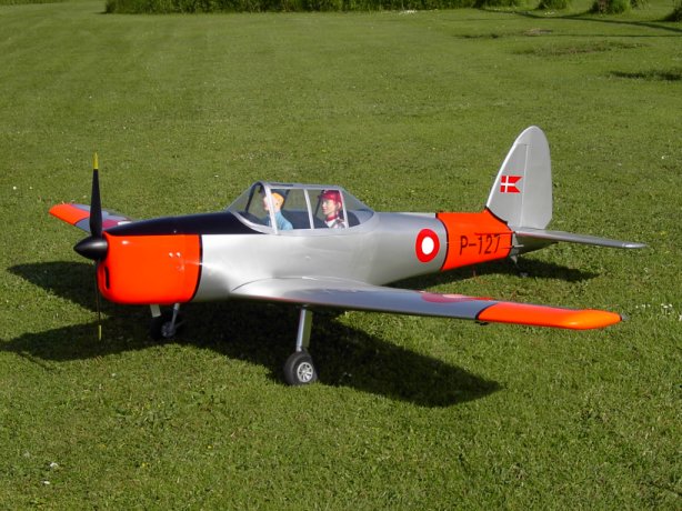

Hi Manks
I have build and flowen a Dynaflite Chipmunk for the last 4 sesons. It a very nice and predictable plane to fly. You have, in my opinion, chosen the right
model for a start with big birds. My Chipmunk is powered with a OS160FX with a incowl Aviation alloyed pitts muffler, whith gives more than enough power. Don't spare the oleo legs from Robart. They are not cheap, but will help you to make the nicest landing! My model ended at 8 kg. with fiberglass, 2k paint on the fuse and folie on the wings.

Peter,
What a nice looking plane you have!
I can only hope mine turns out as good. So far I have just about finished the wing, that will get done tonight, when I finish up the centre section and do a good rough sanding job.

Manks,
That a cheap buy! I don't understand why Dynaflight stopped producing this kit when every buddy is talking so nice about it. The reason is probably that the mainstream is to buy ARF instead of building kits - Unfortunately in my opinion!
I have build my wings in two half, which is not acording to the plans but much easyer for transportation. The two half is aligned with a 20 mm carbonfiber tupe. Because of the V-shape of the wings I could not make it with larger diameter if I wanted the make it through the first 3 ribs from the center.
I do understand why you want to build it with a gasoline engine instead - The OS160FX is a very reliable engine, but it uses almost half a liter of fuel in a 10-12 minuts flight. Most of the lubricating oil in the fuel must be wiped away from the plane after flying. After the Chipmunk projekt I have build a 2m Funtana with a ZDZ40, 33% Ultimate with a DA50 and this winthers (and next winther to!) projekt is a 47% Pitts S1S with a 3W 150B2 boxer - My conclusion is, that if the plane is belowe 2 m - No doubt, go for the gasoline engine. A clubmember in my flyingclub is building the Dynaflite Chipmunk at the moment and he had bought a ZG26 gasoline engine for it. The problem could be to get enough pace to a gasoline muffler inside the cowling. The cowling is very narrow and it is not possible to make any room for a mufller inside the fuselage.

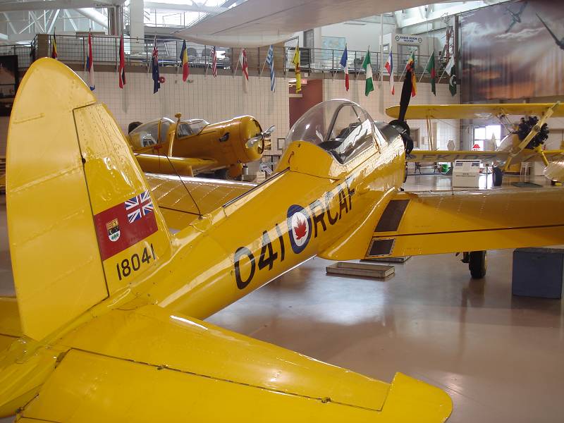

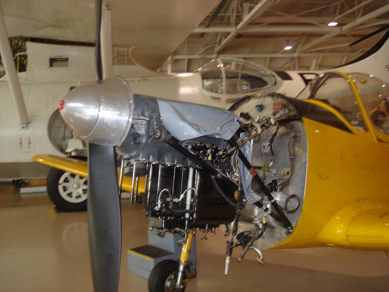

I had some fun yesterday. I went down to the Canadian Warplane Heritage Museum in Hamilton, Ontario. They have two Chipmunks there, and I wanted to take a few photos, and get a close look for scale details.
Well I will tell you that the museum is amaizing, you don't get close the the plane, you get right up next to them, close enough to see th sitching on the fabric covering! I had my son standing on the wing of a T-6 Texan (Canadian version known as the Harvard). One of the Chipmunks had the cowl off of the motor, so you could see everything, up close. Most of these planes are flyers and during the winter people are working on them. The big Lancaster bomber had one engine off and the other three stripped down for work, it was really amaizing to get so close to so many planes.
Included in the colection are: Spitfire, Sea Fury, Lancaster, B-25 Mitchell, Tiger Moth, DC-3, Vampire, Voo-Doo, CF 104 Starfighter and tons of other stuff. If you are ever in the area, it is more than worth the $10 admission! If you look at the picture of my son on the wing of the Harvard / Texan, you can see the Lancaster in the background. That is one very big, very impressive bird. It is one of only 2 Lancs that still fly. You can buy a ride in it for $2,000. It is one big beautiful bird.

ha ha thought the airplane photo was a photoshopped when i saw the engine almost looks like OS's Inline 4 cylinder engine. post some more pictures of your progress.
