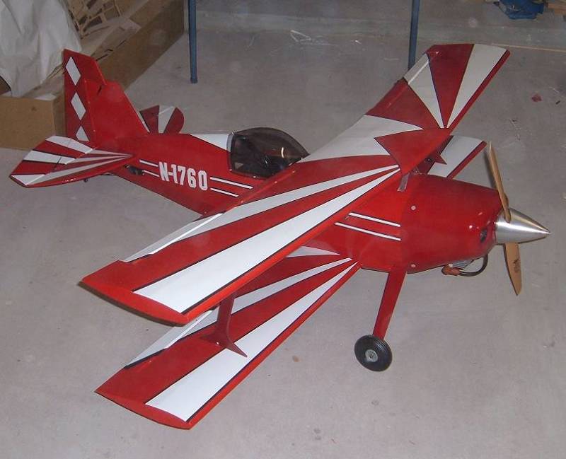

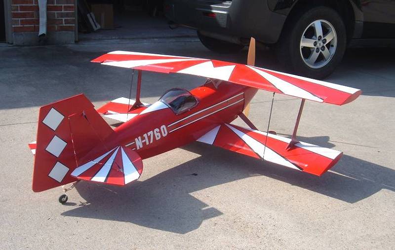

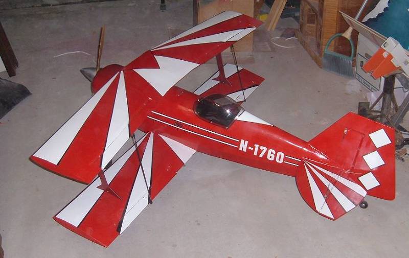

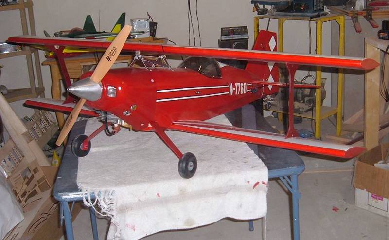

After 4 months of toil, I finally finished up my Lanier Ultimate Pitts. Engine broke in and running perfect! I should be maidening the plane this Saturday afternoon.
Final Specs:
Zenoah G38 (PLENTY OF POWER)
Hitec 6945 digital coreless
20 X 10-6 prop
AUW 13.3 lbs
Things left to improve on
1. paint trim scheme on cowl
2. add wheel pants (I doubt they'll stay on for long at my field)
3. add smoke system (if the plane flies as nice as it looks, it should be a great addition!)
Here are some completed pictures:

Ok, I maidened the plane this weekend! I had some difficulties getting the engine started (had to hand crank it because my glow starter just wasn't up to the task), and the maiden was done with the cowl off. I was running a 20 inch prop on the G38 and the landing gear barely gave enough distance (I was mowing the grass on takeoff!). Well, after a few practice run ups, I was able to take off at half throttle (with authority I might add). The plane needed a little trim, and I didn't want to put much stress on the plane for the first few flights due to the engine being brand new, and my first heavy plane. Even at half throttle, the plane was pretty fast!!! I landed the plane at a walking pace....she's a beauty to land...no bad tendencies at all...the landing gear strained when she touched down, but didn't bend much.....I checked the plane for any loose hardware and then took some pictures. BTW it flew GREAT at the 13.5 weight (just make sure you have your COG correct!)
OH yes, I had to get my girlfriend to pose with the plane!
Here are some pictures:

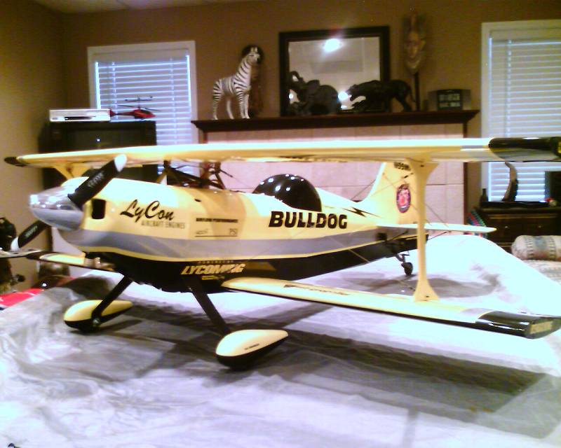

Man.. I wish I had looked at your postings again... that's a beautiful plane.

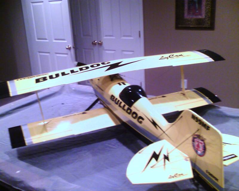

I decided to recover my lanier over the winter and upgrade to a Saito 180... Here's a few rough pics of the finished product... took the pics with my cellphone, will upgrade those later....
I did fly the plane a few times this past season, but the Saito 150 on it was a bit worn out... it took off like an old shoe. Hopefully the 180 will help that out a bit.
This plane,with engine, is coming in at about 13 1/2 pounds.. what about yours?

I switched from a Roto 35 to a Saito in mine to lighten the plane. The Saito really made that plane perform.

Is yours a Lanier? Also, what prop size are you working with... I've tried (on the ground) everything from a 16x8 to a 18x6w... I like the 6W better, but it won't fit with my 120-cut spinner.. guess I'll have to order a wide cut. The 16x8 spins at over 11K RPM, so I'm afraid its too small. Everything seems to pull in the 15 - 16 pound range.
