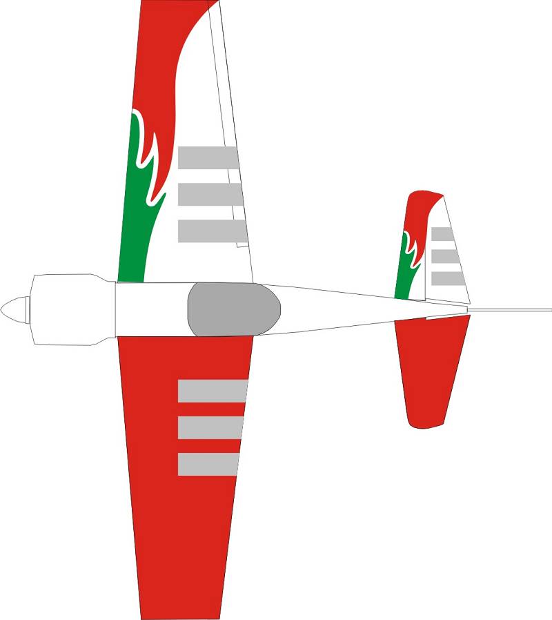

This is the trim that I am planning to do, I copied mostly from the newest Sebastiano Silvestri design I will use metallic red and green and transparent red for the lower side of the wings with gray strips.
There are not much pictures to share I have finished the tail surfaces and I am going to start the wings by the next week after a week off that I am planning to spend at Las Vegas.
